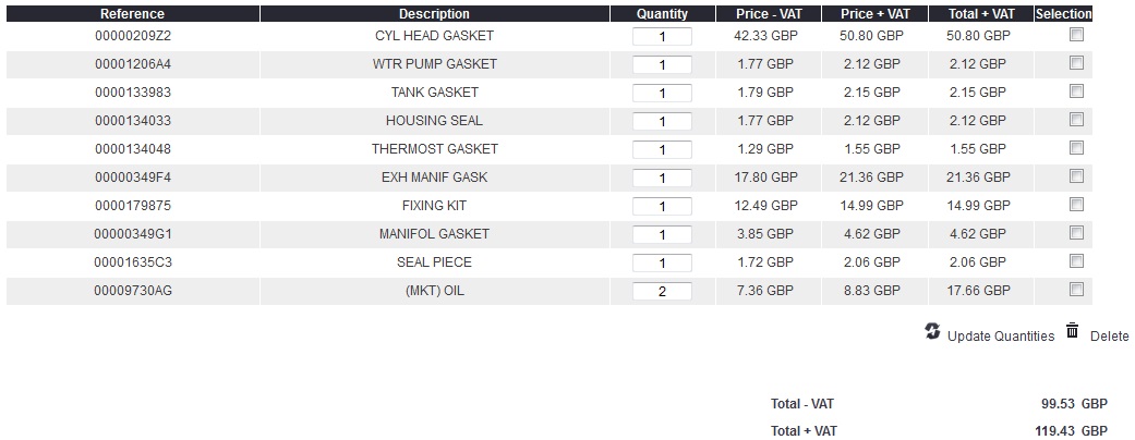

ordered some more gaskets
will be putting the head on this soon Smile
