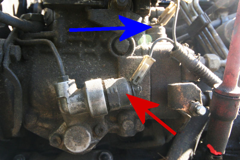

Red arrow
That piston is purely for cold start, it gives more timing when the engine is cold, but it doesn't add any more timing at full speed, only at low RPM.

Red arrow
agreement of Ruan thank you
I will remove its then takes up to nothing
