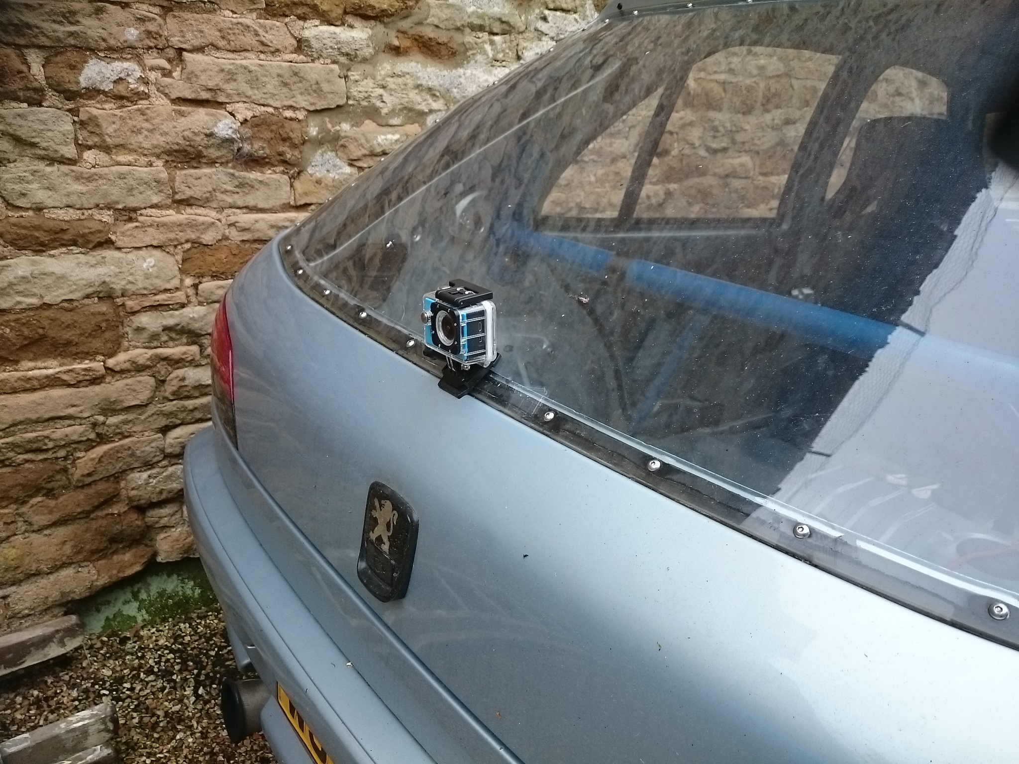

Finished camera mounts...tried a few out this evening on a good run to Cirencester... Cant get oil up to thermostat opening temp though despite trying hard!

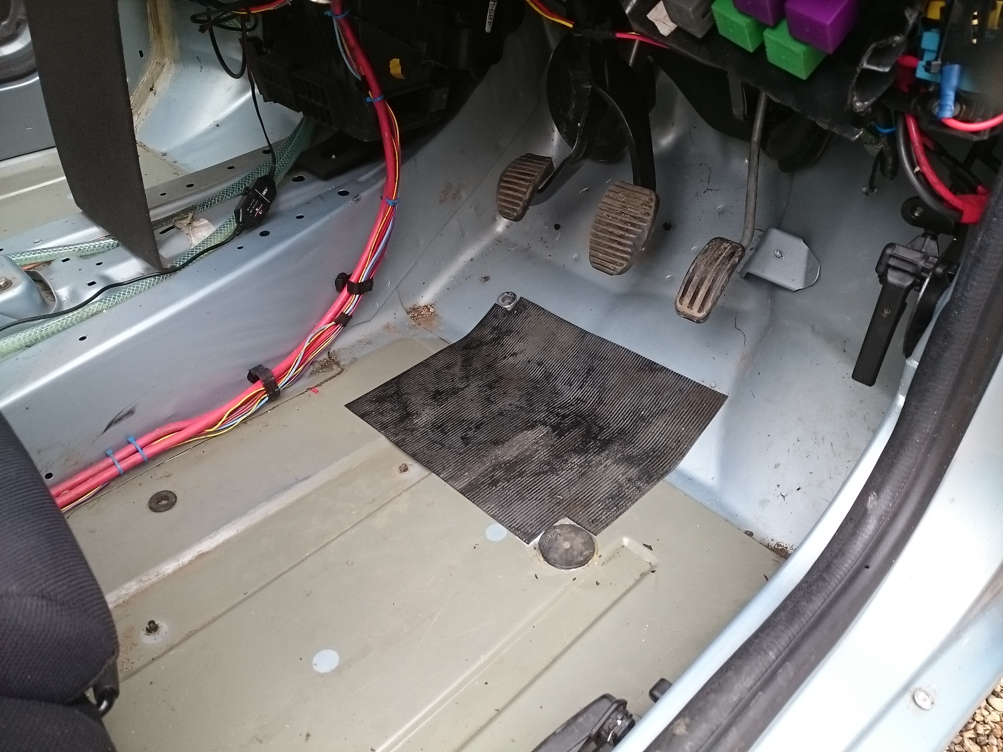

Also added rubber pad for less heel slip...esp as forecast looks like rain Undecided

How many SJ's have you got? Three?
(02-06-2016, 08:18 AM)JJ0063 Wrote: How many SJ's have you got? Three?
I've got two. Third coming as one was bit crap sound...so they sending another.
However the plan is to have one internally all the time., plugged in, so wont die...
Then the second I'll move about during the session to get different angles

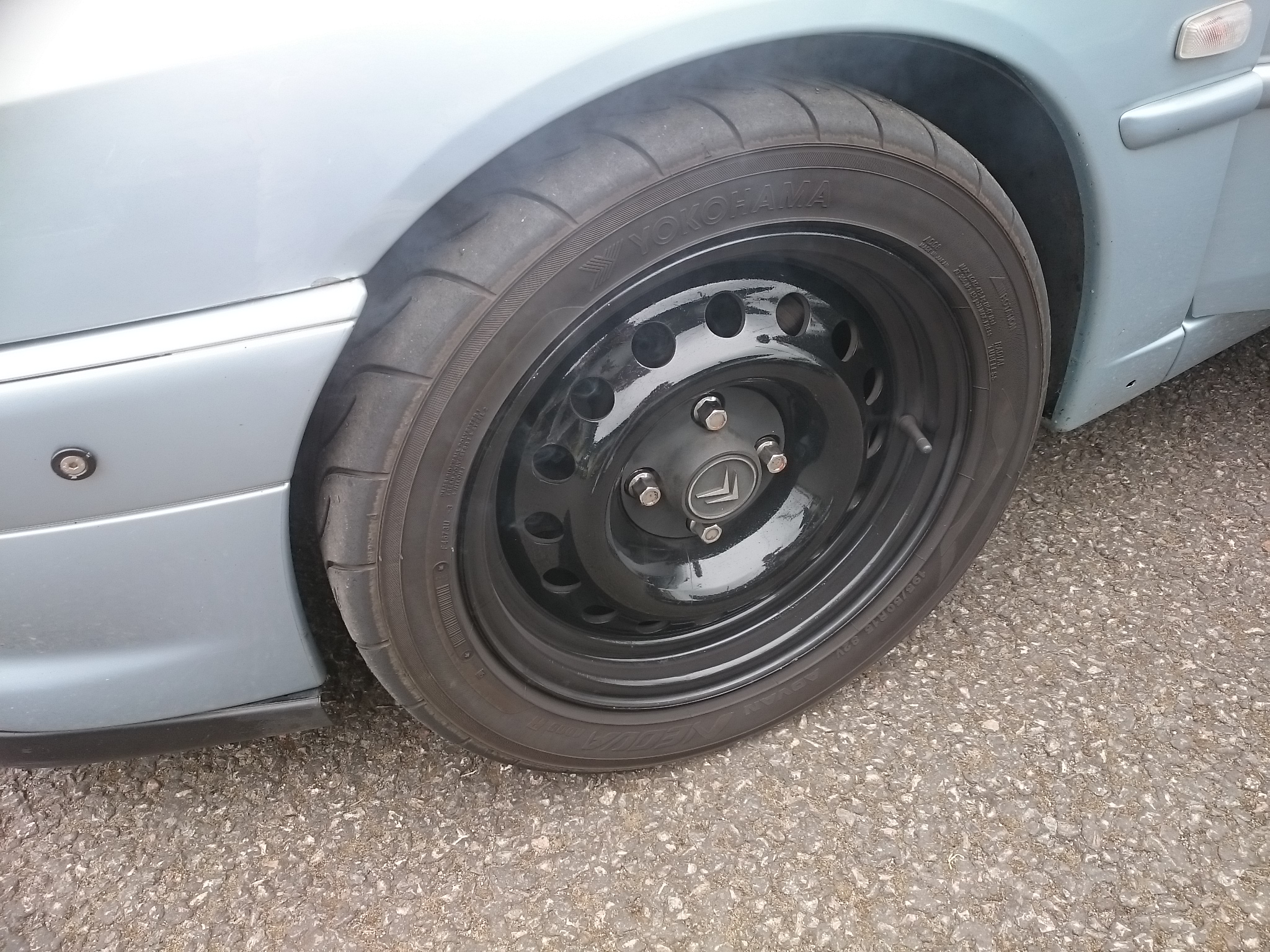

Coolant and oil temps under control...I did however cook the brakes...the DS2500R pads/brembo discs. Like...smoking/onfire.

Brakes hindered me, well, cooling to the brakes I guess due to those C5s

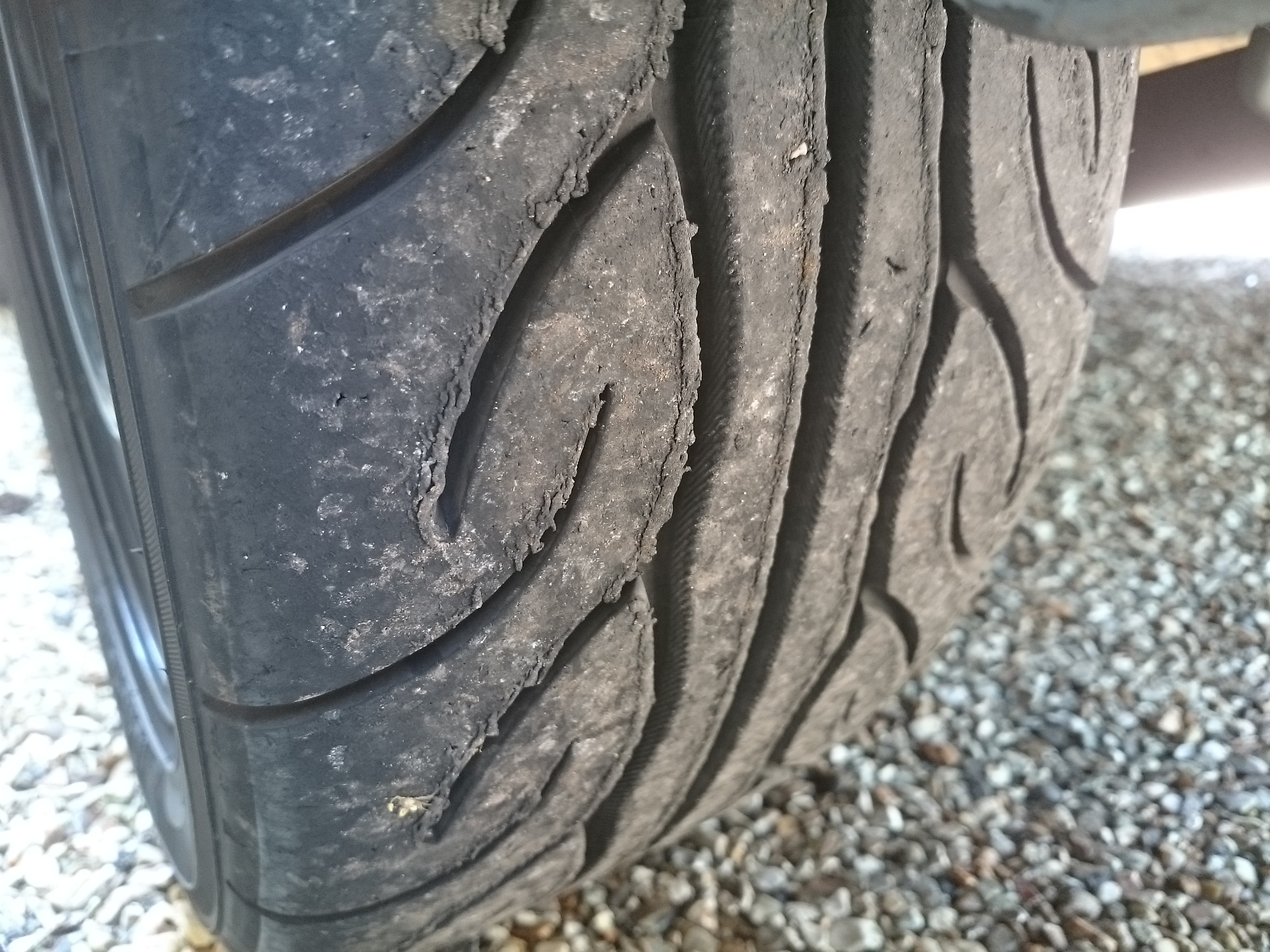

As seen by rear tyre, I did get a move on as best I could:

A friend cooked his brakes whilst using c5 steeloys on track, not enough ventilation

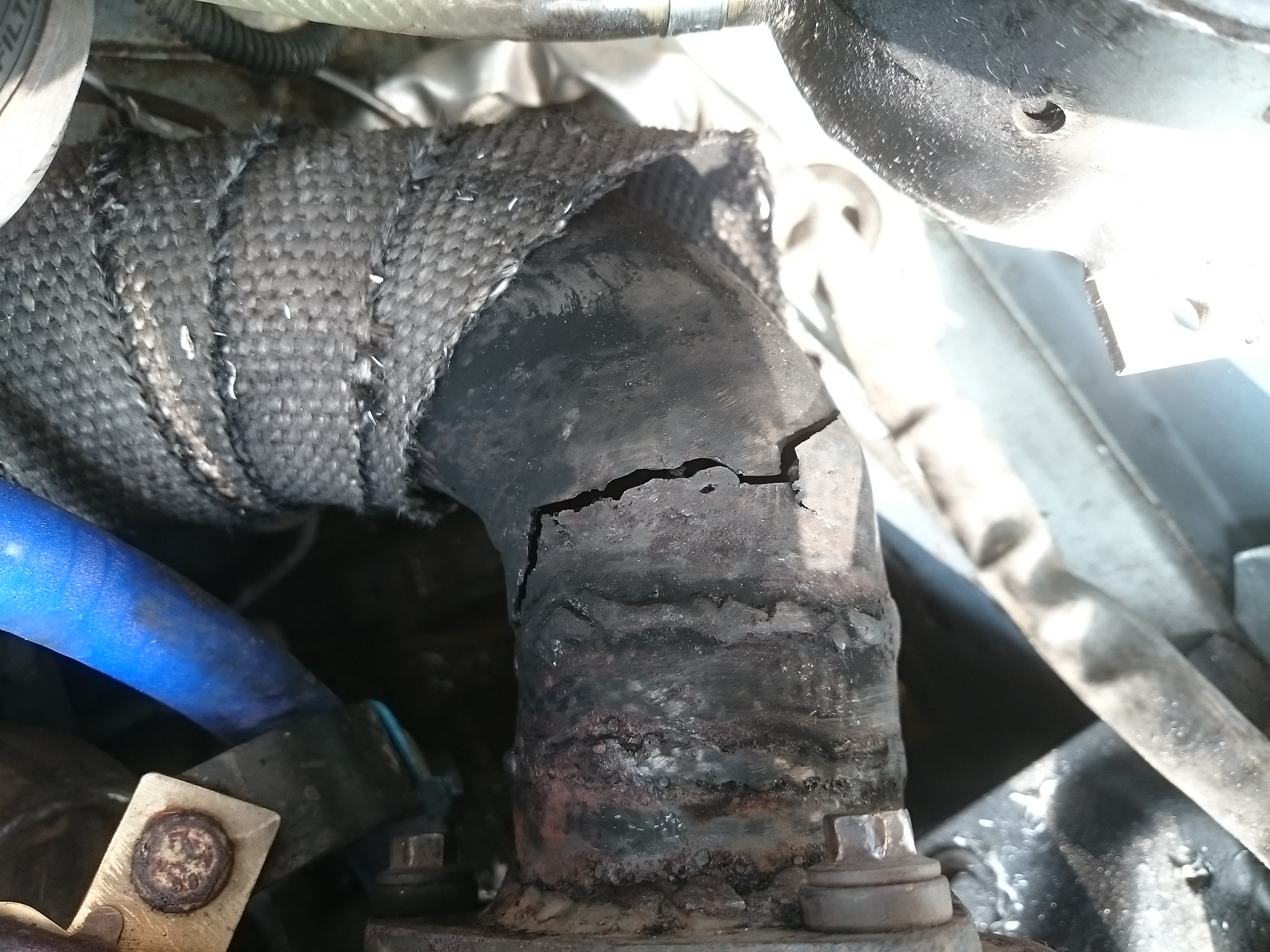

Just MAY have found the issue...
Blush
Rofl
So exhaust is smacking against manifold and the subframe.
...badly supported being the issue and a too small of a flexi hasnt helpd... Plus lots of heat no doubt from track time.
Lasted just over 20k miles.mind

holy crack...... thats huge.....
think this calls for more weldings Smile glad its nothing too serious for you fella.
