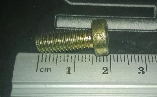

whats the pitch please??
No idea how to measure pitch, I think it's standard? I've included a photo if that helps.
Probably 1.0mm pitch, use the links below to find them
(27-05-2016, 07:49 PM)welshpug Wrote: Probably 1.0mm pitch, use the links below to find them
And yeah it's 1mm

cool, thanks, fore armed etc., looks as if a 10mm hex head will fit??
You might find you have clearance issues getting a socket over it, being so close to the solenoid body as they are.
Yeah, hex head is a no go. Bolt won't even fit let alone the socket.
In a pinch you could use a 30mm long bolt and a 15mm spacer, but not recommended.
thanks, will go down the allan bolt route
