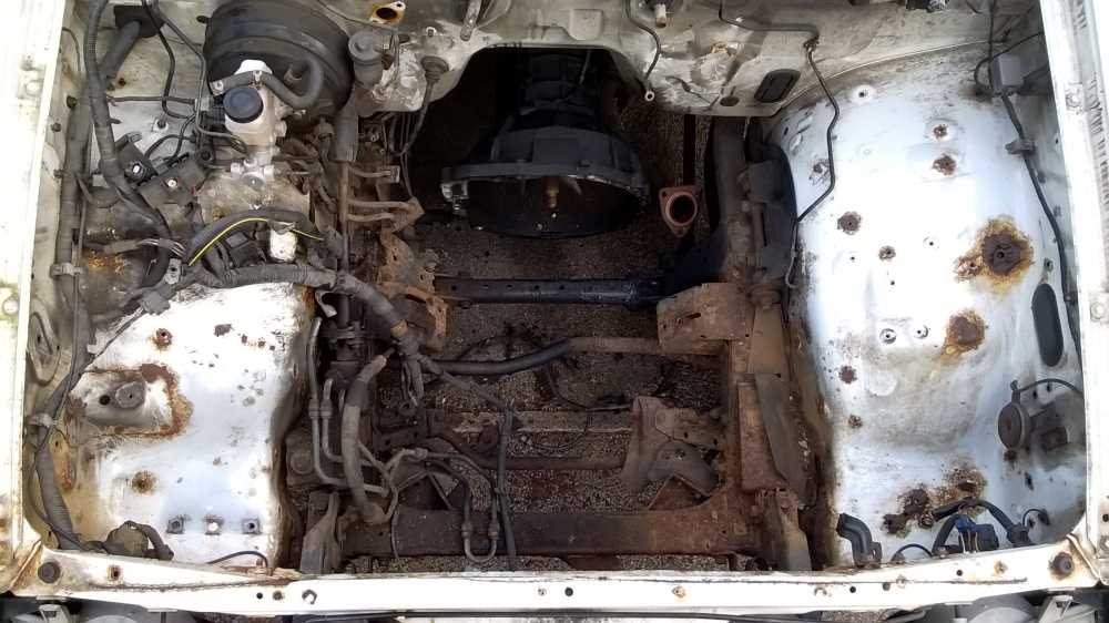

Plenty of room for activities in the engine bay. If you look at Darren's Cummins Land Rover thread that these mounts look pretty good especially when you bear in mind that the Ranger rails are further apart. I really need to give it a good clean and paint but there is alot of stuff that needs to come out of there first.

Hows the length of the engine looking with the engine bay?
wondered recently how good the 4bt would be, probably a good chunk lighter, iirc the 6bt is 450 kg!!  nearly 4 xud's
4bt isn't as common ive been told, not so sure on that, probably dont come up as often as they're usually found in smaller buses of which theres thousands of dennis darts about!
(26-05-2016, 09:53 PM)welshpug Wrote: Hows the length of the engine looking with the engine bay?

Weight isn't particularly an issue, the truck is a hefty old beast in the first place.
Length is an interesting conundrum, I've read in some places that they are a little over 1m long which my engine bay isn't but then a land rover bay is shorter and a few people have them in land rovers.
