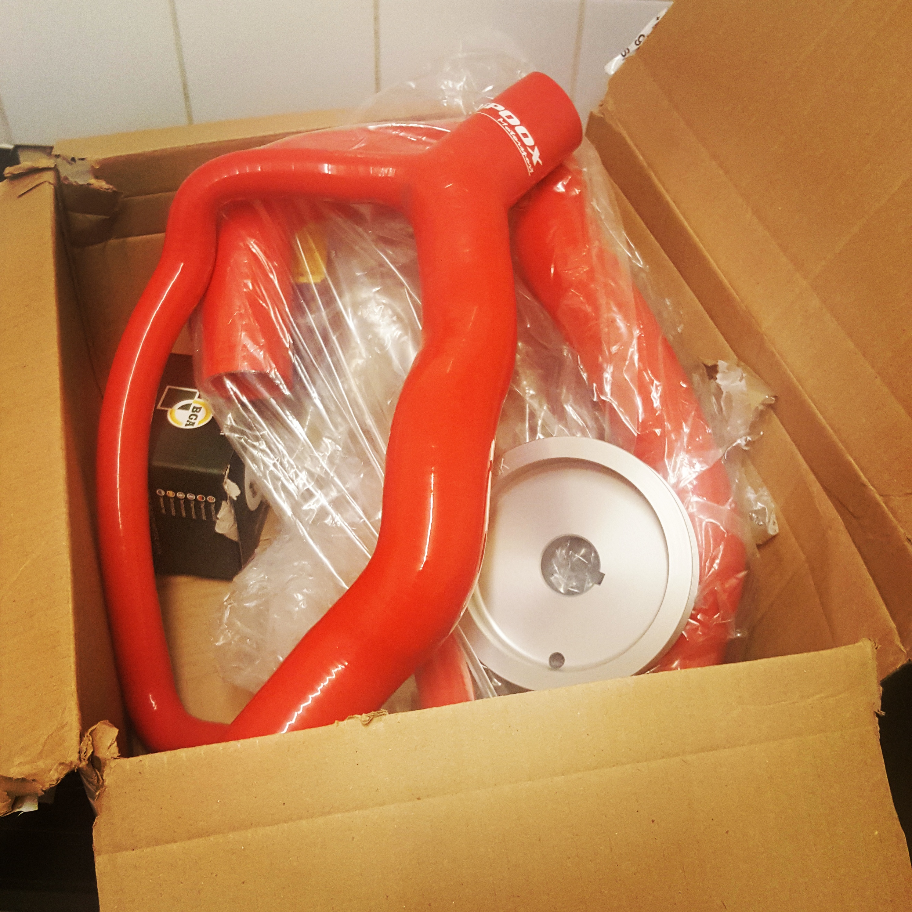

First of my spoox orders arrived today

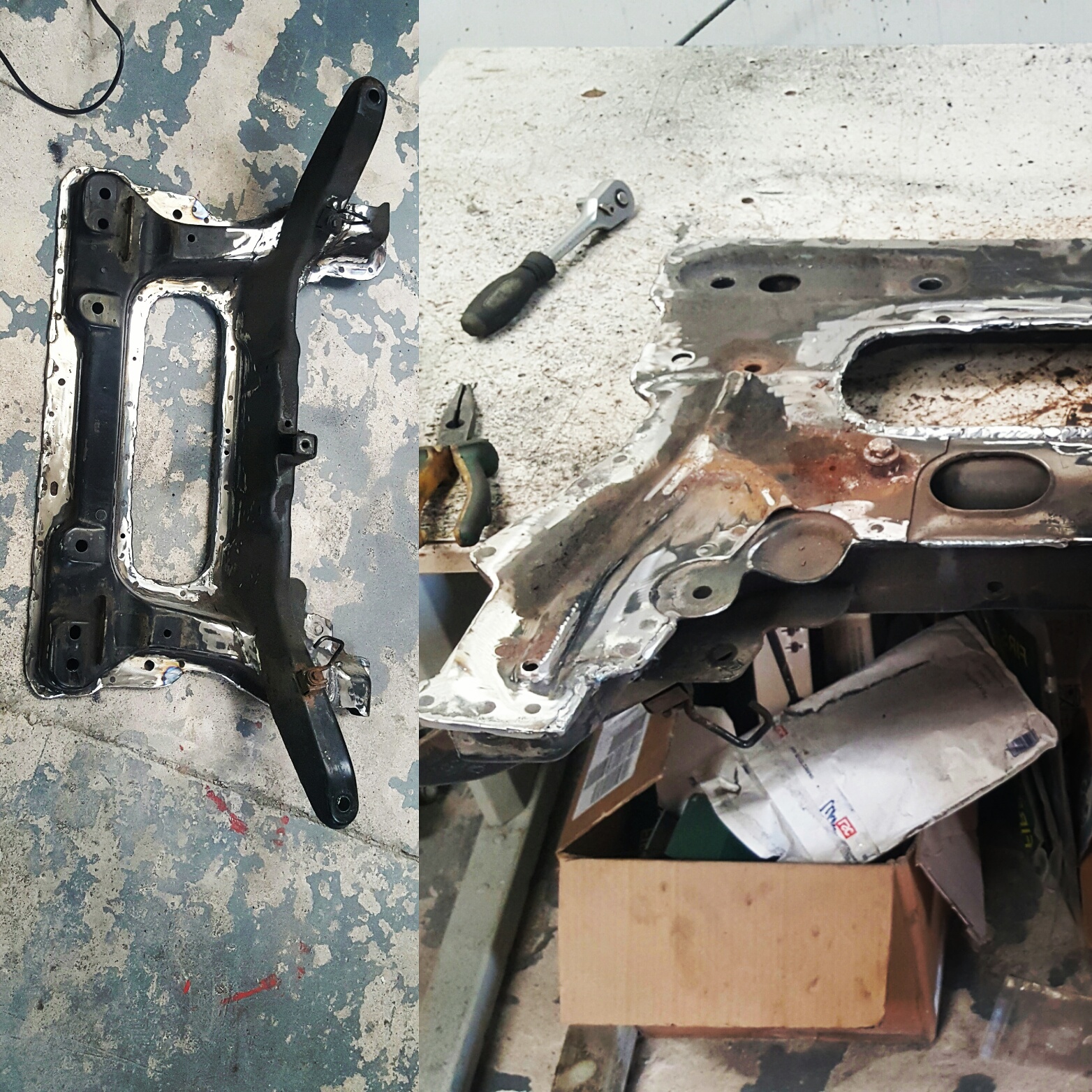

Today's job: seam weld the subframe
Took alot longer than I anticipated as you really have to spend a while getting all the years of dried out oil and road grime out of all the little gaps you're trying to weld up. Queue a couple of hours spent with the wire brush, flap discs and plenty of thinners to try getting the grease off. If I was to do this more regularly I'd get it shot blasted first lol
End resultlooks good though, just need to get it powdercoated now along with another box of parts I've been gathering

Seam welding the subframe is not fun. It's galvanised so you are best off using a propane torch to melt the shite out of the joint first but you don't want to be breathing that stuff in.
I had mine shotblasted first and it still melts sminge out of the joint.

(25-05-2016, 01:13 PM)C2K Wrote: Seam welding the subframe is not fun. It's galvanised so you are best off using a propane torch to melt the shite out of the joint first but you don't want to be breathing that stuff in.
Looking v tidy underneath.
I've got another couple of subframes that Im getting blasted then dipped to see how they weld then. Hopefully get a neater result than the first one
