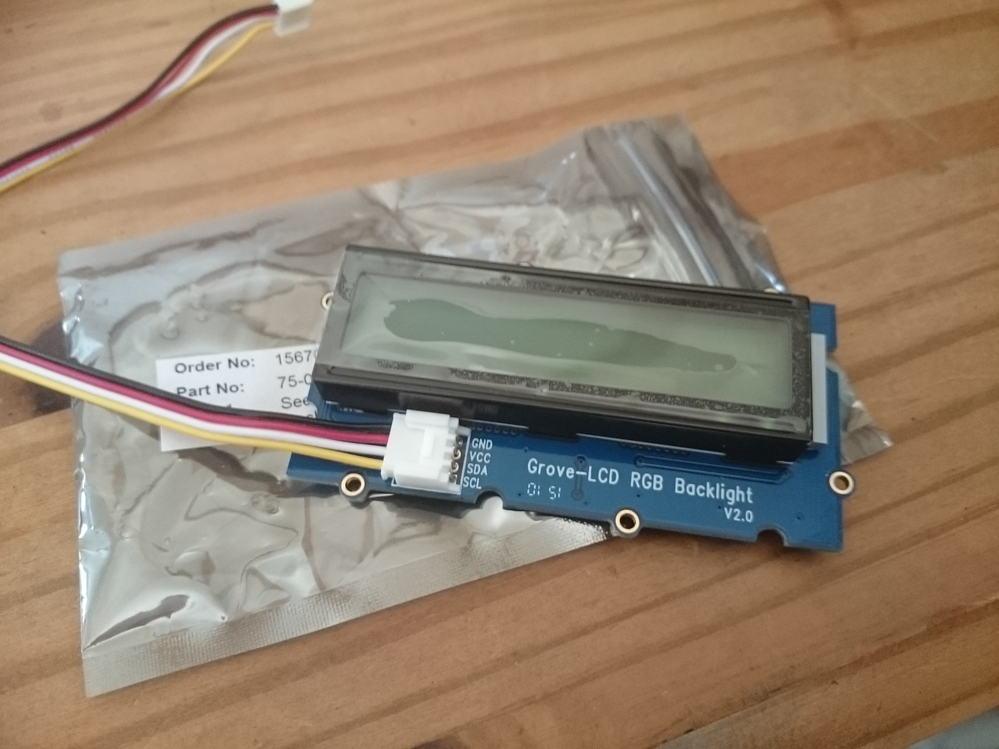

Just need to wire this in next...
 i2c rgb lcd display that will fit in same old slot in center dash but work with the new software...been running a empty hole for ages (!)

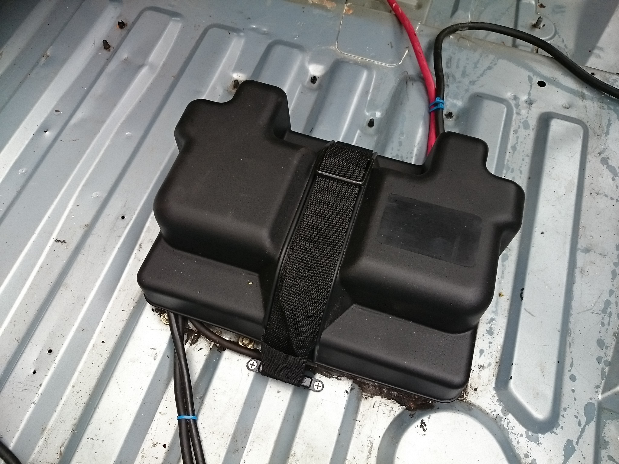

So...battery strap tin replaced with a section of lpg tank banding....
And FINALLY a lid....
Much better. Been on my mind for ages, feels good to have sorted it and makes interior look better... If thats possible!
Just need a fuse now...sorted soon.

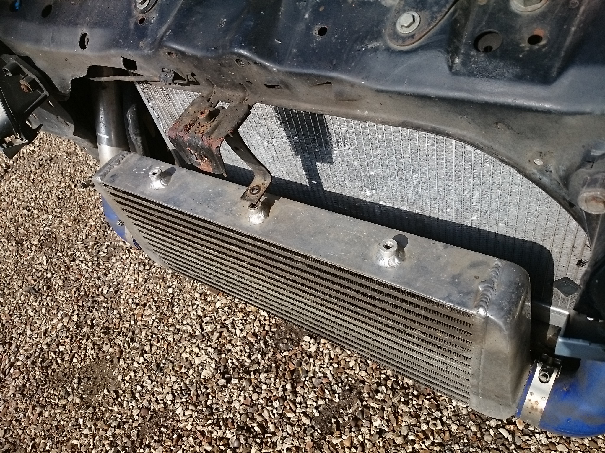

Then started on "cooling". Basically wanted to move the fmic/rad closer to avoid air stall, add some cowling to improve air flow and reduce losses, add an oil cooler and make a sort of air box for the big air filter.
So front end off and assess and access things...
Some cutting, hammer and general magic later...
Not a bad result, pretty happy, they are as close as is possible now.
Need some shrowding around each side and maybe bottom and then an oil cooler I hope to fit to the side in front of washer bottle Smile
That offside silicone bend ok? Looks like its screaming from here!
Which temp are you hoping to have the greater result on? Or just an improvement on both, any logging or sensors in there to prove gains? I like the stacking of rads idea, has pros and cons.
Yeah it's a little squeezed but should be fine...I'm going to squidge it over 10mm to help it a bit.
If I'm honest, I don't see any cons to this. Only pros. The gap reduction is mainly for the coolant radiator, cowling will help both.

Have you got your fmic supported at the bottom too? Or is it ok just from the top?
Need to get on all of this myself tbh, especially the air filter enclosure
Yeah two bolts threaded through lower rad support ThumbsUp
