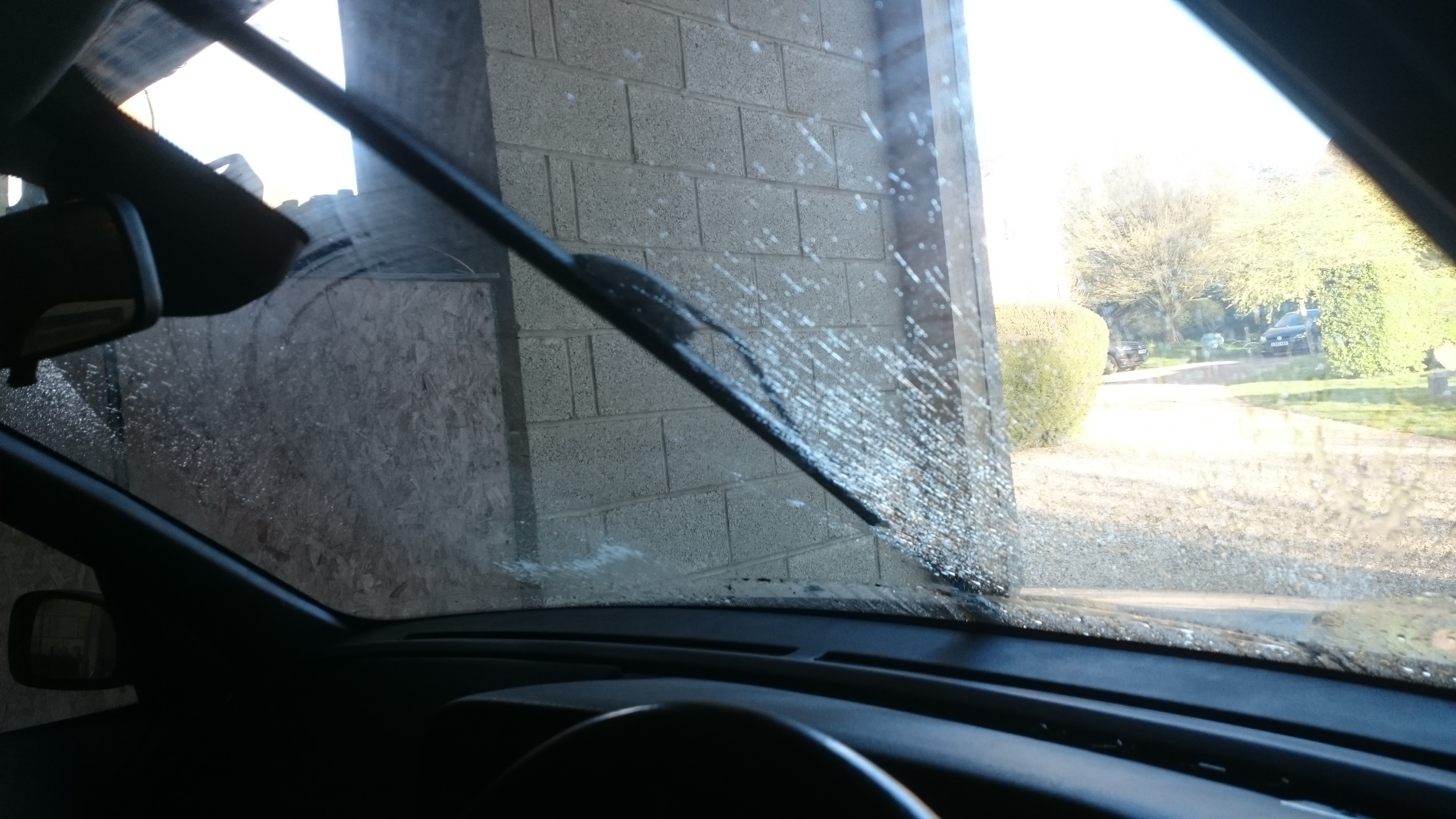

So the genuine item arrived today...all be it, only one, they sending another, their fault.
Anton said get the one that say "fiat" and sure enough I did and they were sealed in a genuine fiat/lancia packet.
But fitted to right side...note the spray difference.
