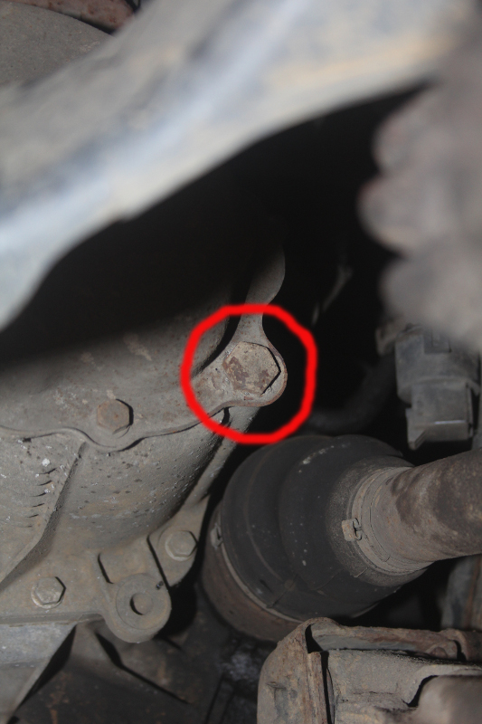

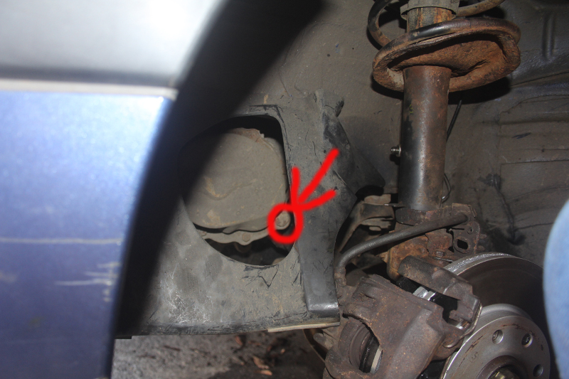

Hey folks I know this is a bit of a FAQ but I am still having a issue locating my filler/level plug on the gear box on my car and any help would be great please.
when working on changing strut balljoint etc I upset the driveshaft and lots off gearbox oil was lost (I know this is a common mistake)
here is a few shots I taken of the car

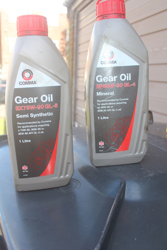

is it this one  also me being daft I brought two different oils which one can I use please

The one you've circled is the level hole.
There's a black plastic nut on top you fill from
You want 75 80 oil
