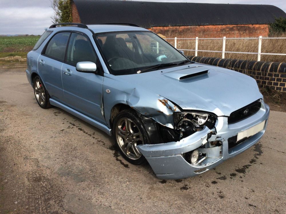

I saw this shed advertised on ebay for just shy of two grand, the listing expired with nobody having bought and I knewthat was my time to go and offer sensible money.
After some hardcore grade haggling I agreed a far more realistic price of £1300 and went and laid out the reddies

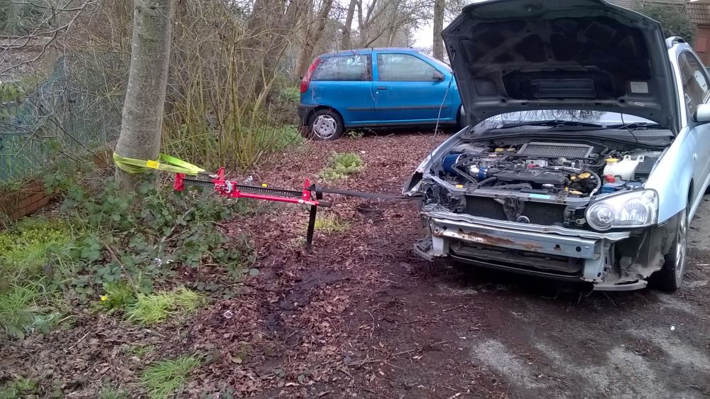

I drove her out of the site and round the corner where me and a buddy spent just shy of an hour making her look a little more roadworthy and fitting a Japspeed induction kit as the airbox was cracked.

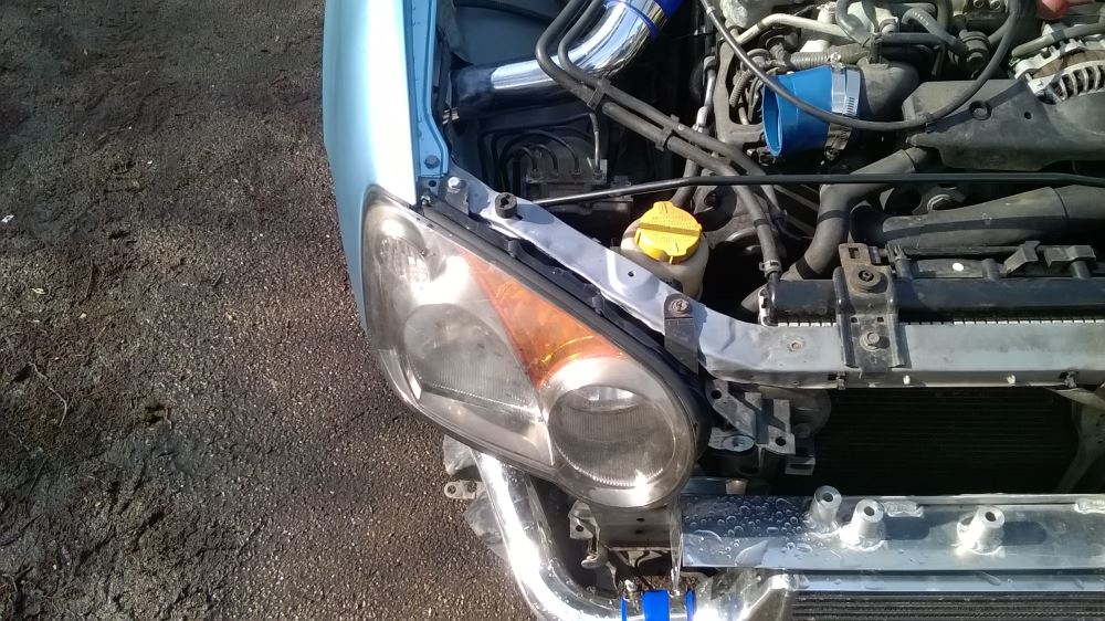

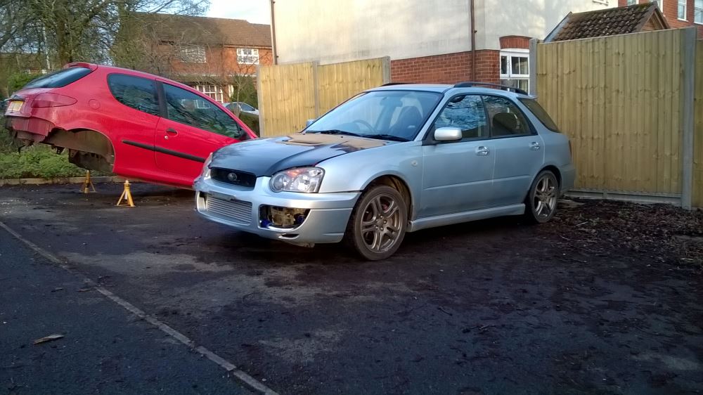

Got her home and this weekend started straightening her out as the main structural bit of the chassis leg isn't bent
Headlight and new wing now sit perfectly on the chassis

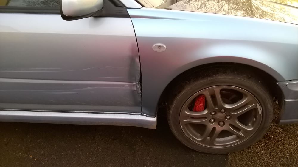

I'd sadly painted the new wing the wrong colour due to ordering the wrong paint but managed to get the door straightened out a little and covered the bare metal with a little paint till I can find a door in the right colour.

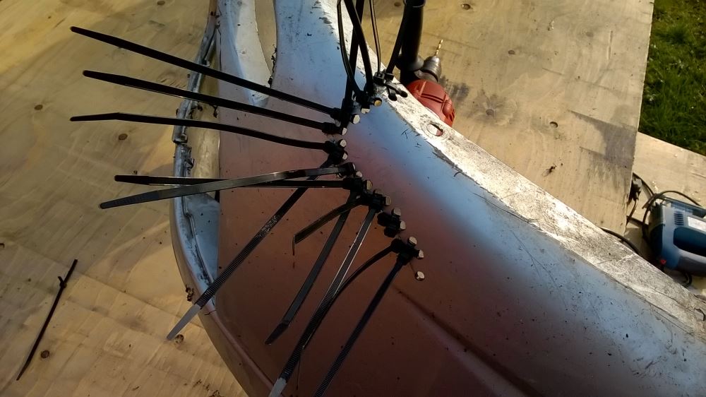

And I cable tied the cracks in the bumper together till I get the right paint to paint the new bumper I have here.

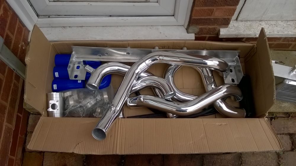

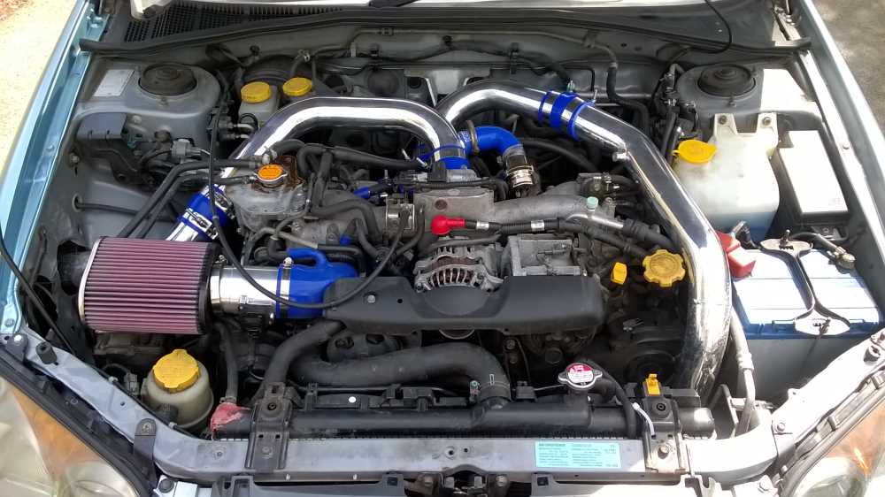

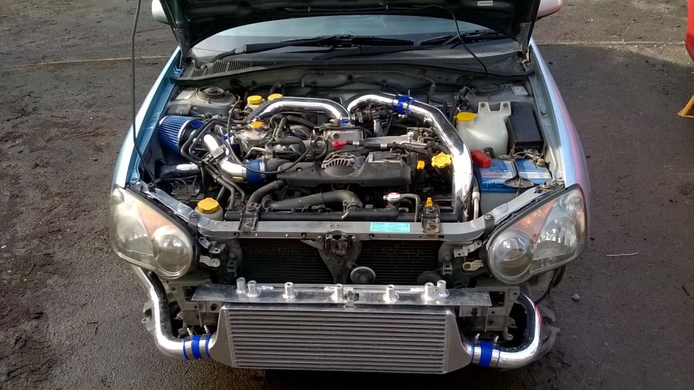

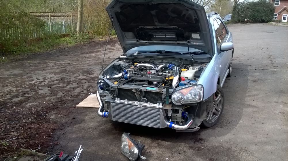

While fixing the damage I decided to fit a FMIC for a later power upgrade and so that I can put on a non vented and less "look at me" bonnet. Many shinies came in the post, this kit appears identical to the Japspeed FMIC kit but was over £100 cheaper.
Got to work starting fitting it when it arrived in the post

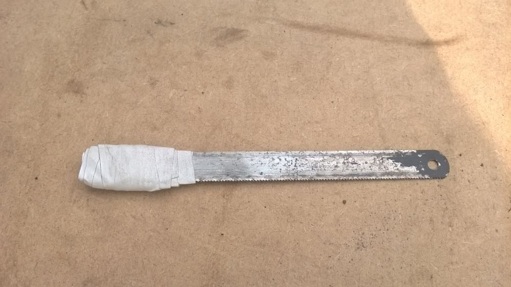

You know it isn't gonna be a fun day when you have to make one of these tools. I had to cut off a bracket on the fan cowling as it fouled the FMIC pipe.

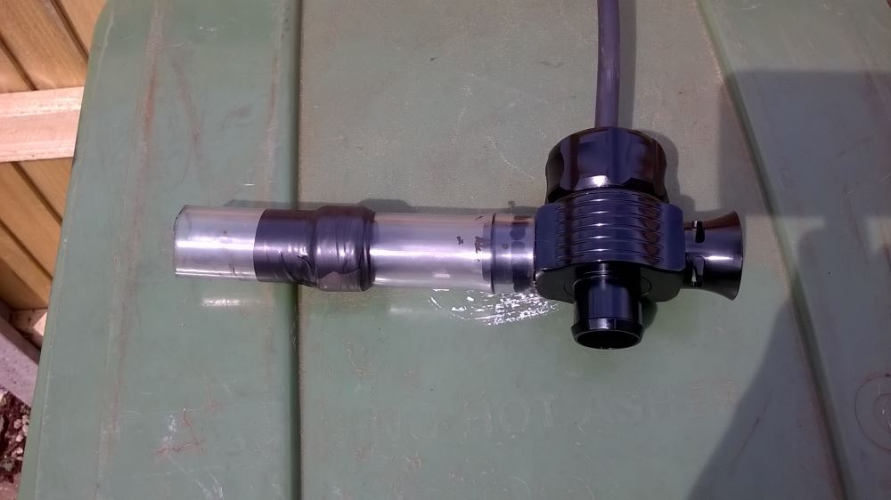

Got a splitter dump valve for more noise because I am a massive chav, had a little bit of a bodge to get it to meet the old pipe.
Kit all fitted
And the car looking awesome, needs a couple of clips put in once I get it up in the air tomorrow. Gonna have to get the STi covers for the fog light holes as alot of the fog light support had to go because of the intercooler pipes.

I think the dump valve is gonna be replaced with a pure recirculating one of a larger bore as this one is massively reducing response immediately after a gear change.

Nah it's definitely not as good on the aftermarket valve as it was on the OEM dump valve.

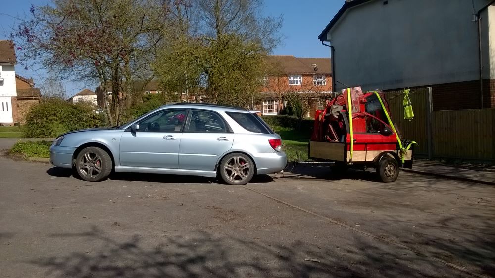

The Scooby is going well, towed almost half a tonne of scrap like it wasn't even there (hadn't realised it's unbraked towing weight was only 500kg oops)

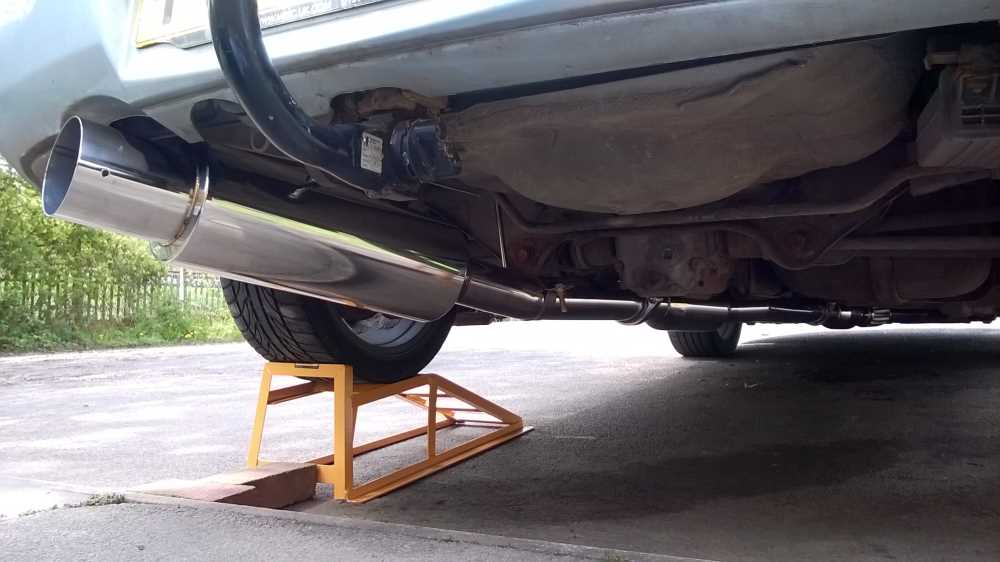

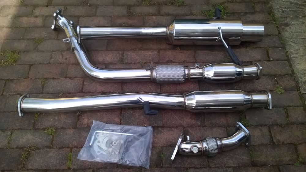

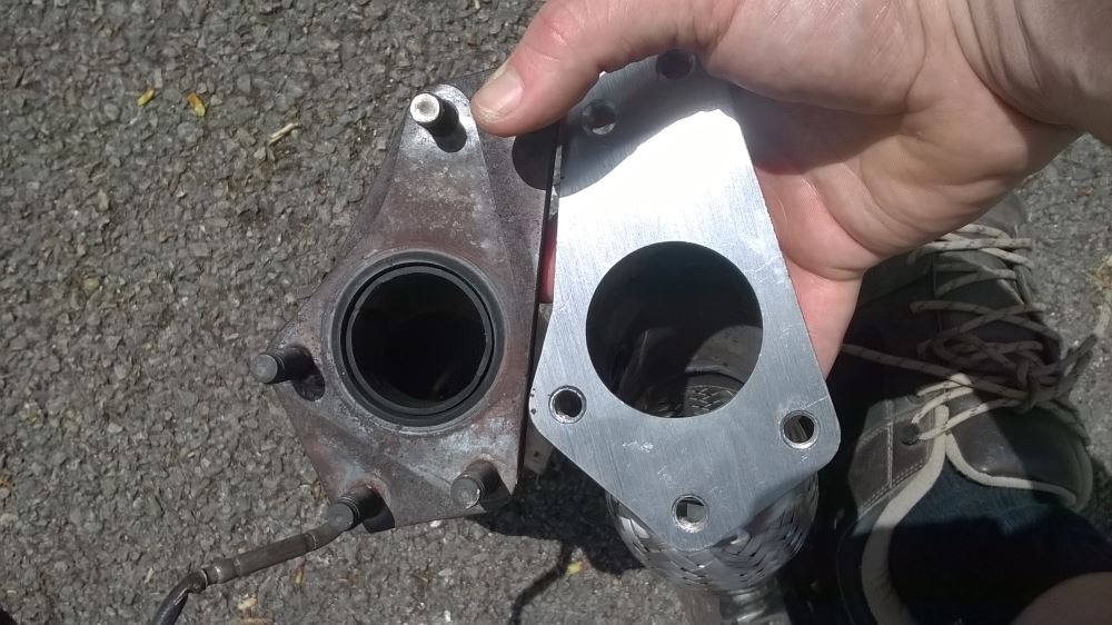

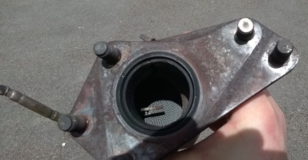

Treated her to a shiny exhaust. It is basically a Japspeed full 3" system with no cats (there are 4 standard). Japspeed sell Toyosports systems at a big mark up and Toyosports sell these at a mark up so I saved a fair chunk of money. It's got a 4.5" tail pipe with a removable noise reducing bung.
I had a massive fight to remove the standard up-pipe (the pipe that runs between the manifold and the turbo). It needed 6 heat shields removing plus loads of pipework, brackets and part of the steering column but I'm glad I did as not only does it have a cat in it that if it breaks down will destroy the turbo but it was 39mm in and 40mm out compared to the aftermarket one which has a 60mm inlet and 54mm outlet Smile
You can tell the quality Chinese build quality of the exhaust here. That bracket is over an inch away from the hole it's supposed to line up to and not even in line. That photo is taken after I'd spent ages trying to bend it to fit.

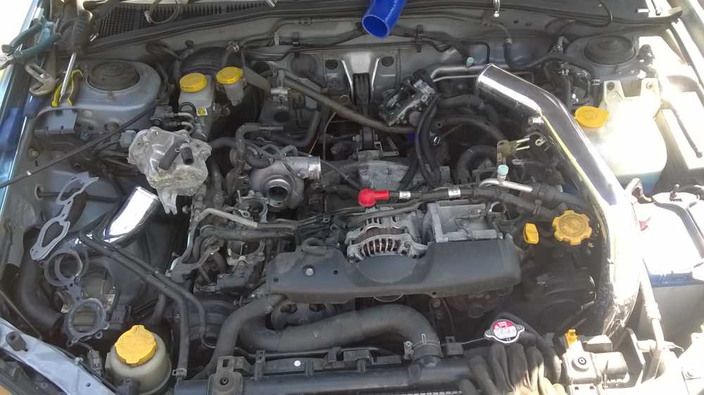

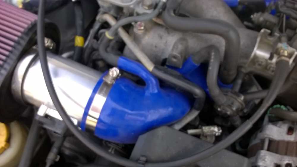

Anyway after getting all the front exhaust bits back together decided to fit my silicone inlet hose to replace the standard corrugated plastic one, apparently worth a tiny bit of power top end but mainly for shiny value. Got all the pipes disconnected and found that the old one was held on with a 6mm allen bolt that you couldn't get a tool in because of various hard pipes in the way so decided to tap it round with a chisel and then I had a massive Dum-Dum Smash moment oops Sad
Got loads of pics I've realised I need to take like my big bore recirculating dump valve, the silicone inlet pipe, K&N filter, my fog light covers and boost controller.

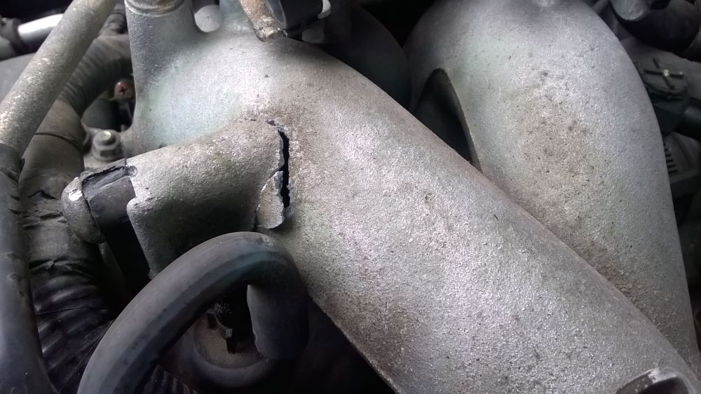

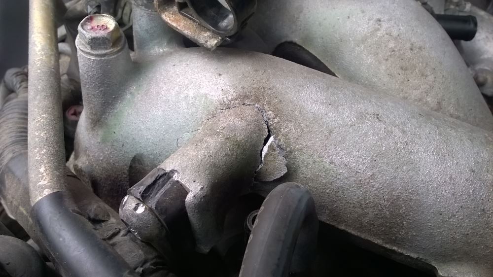

Looks pretty good. Shame about the chisel incident, get the copper stick out!
[Image: 20120704_212316.jpg]
(03-05-2016, 06:21 PM)Ben Wrote: Looks pretty good. Shame about the chisel incident, get the copper stick out!
Had to order a new manifold. At £35 delivered it was cheaper than taking it to be welded.
Here is the exhaust from underneath at the back, sounds awesome (videos some other time)
Got the old inlet stripped off (PITA) to replace it, engine bay looking very bare.

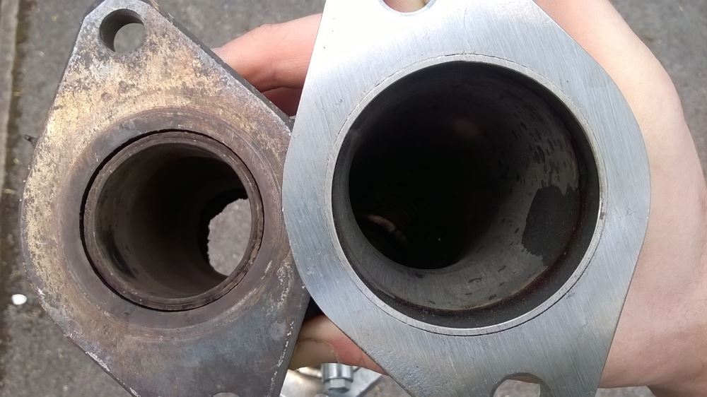

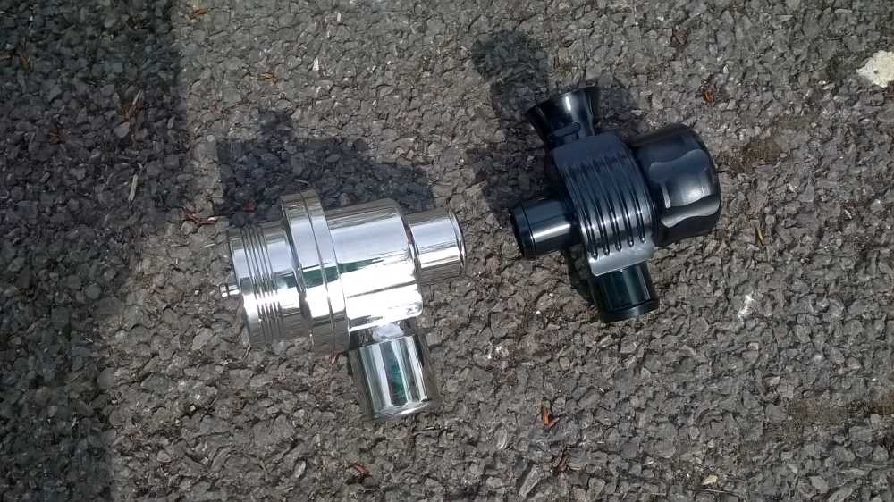

Here is the comparrison between the old and new dump valves, the new one is the silver one and TBH almost as loud as it probably flows twice as much air and I guess alot of that is coming back out through the filter. It's definitely improved pick up on gear changes.
Got my nice silicone inlet hose fitted, this was a huge pain in the arse but should be worth a horse or 2 at the absolute top end as well as taking a join out of the inlet tract.

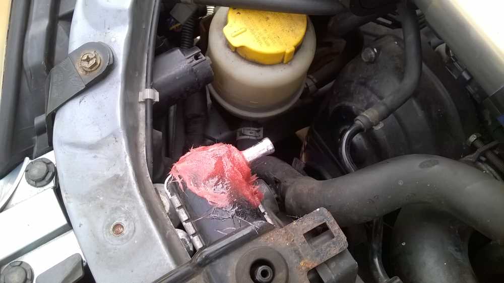

Managed to knock a hose off my already shitty looking rad (I will replace it soon with a nice ally one). Found a great hose adapter and some fiberglass to get 'er done
Engine bay back together and looking very lovely.

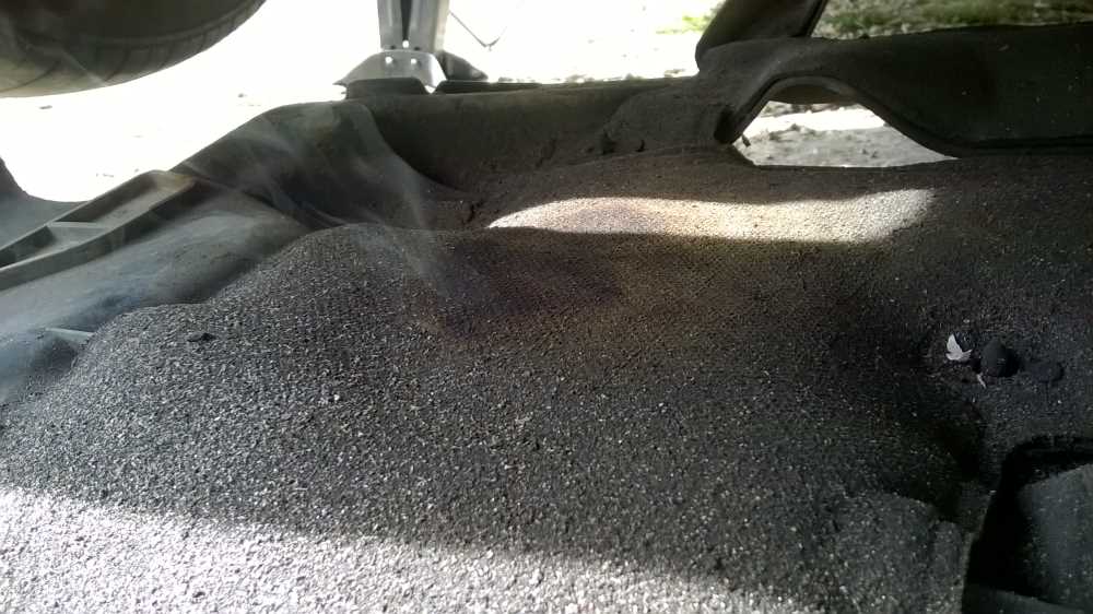

Took the car for a test drive and within a few miles had managed to set fire to the under tray as one of the heat shields didn't get refitted as it was bent and rusted to f*ck.
The exhaust is probably a bit of an acquired taste looks wise but it's growing on me and even without the baffle I don't wake my neighbors up if I come home at 2am (thank f*ck)
So with an estimated 250bhp it tows rather nicely and picked myself up a new project Big Grin
With the trailer empty it goes like it's not even there. When I took it back I even managed to put in a couple of overtakes with the trailer on the back (within the speed limit I might add)

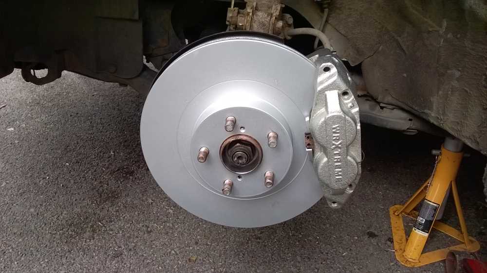

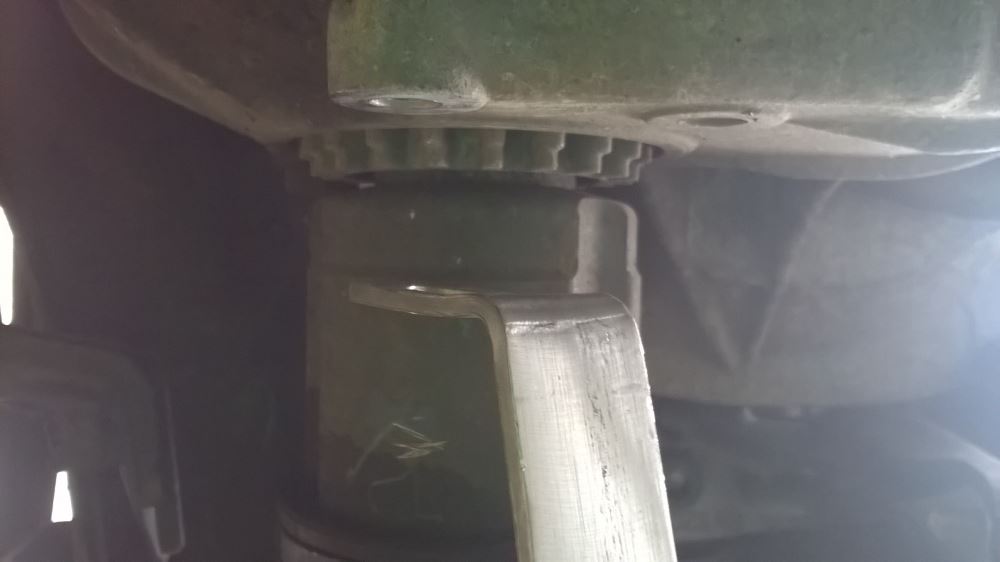

Had to have the nearside wheel bearing done and I was getting near on the pads and the discs looked shitty, the garage found that 2 of the pistons on one of the calipers were seized, they managed to get one freed but not the other so didn't bother even looking at the driver side, changed the bearing and gave it back to me advising that is 2 pistons had seized on one caliper then the other one likely had seized pistons.
Today I have been fitting a pair of brand new copy engineered calipers, they are a great fit and just need painting red again as scooby calipers should be. Braking is a little better but it drives much much better. Love this car.
