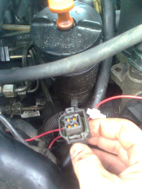

That pump looks OK to me u just have to take the ignition hot wire from the pic below and attach it to the pump solinod as shown in the other pic :-)
Let me no how u get on

As said above you literally need 1 x +12v wire to the solenoid valve on the pump (which is handily exposded on your pump), and you're good to go, no need to worry about immob etc, all other things bolt straight up, may need to adjust the downpipe on the exhaust (someone correct me if i'm wrong though, but this is just a simple slit I think).

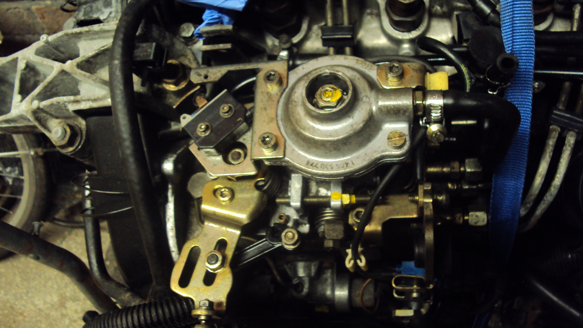

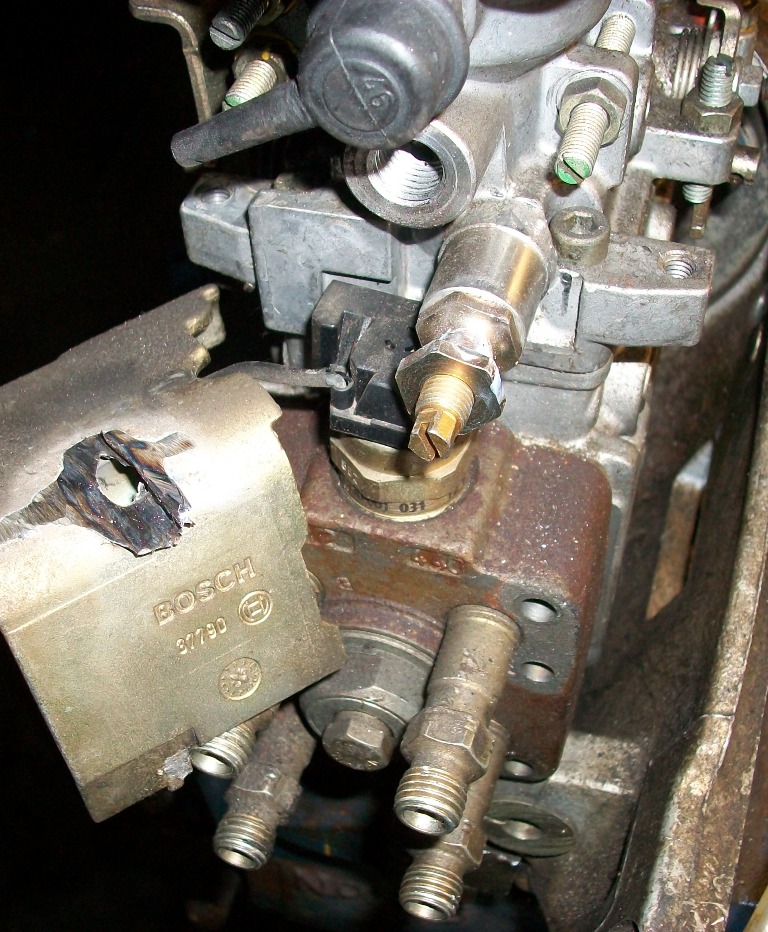

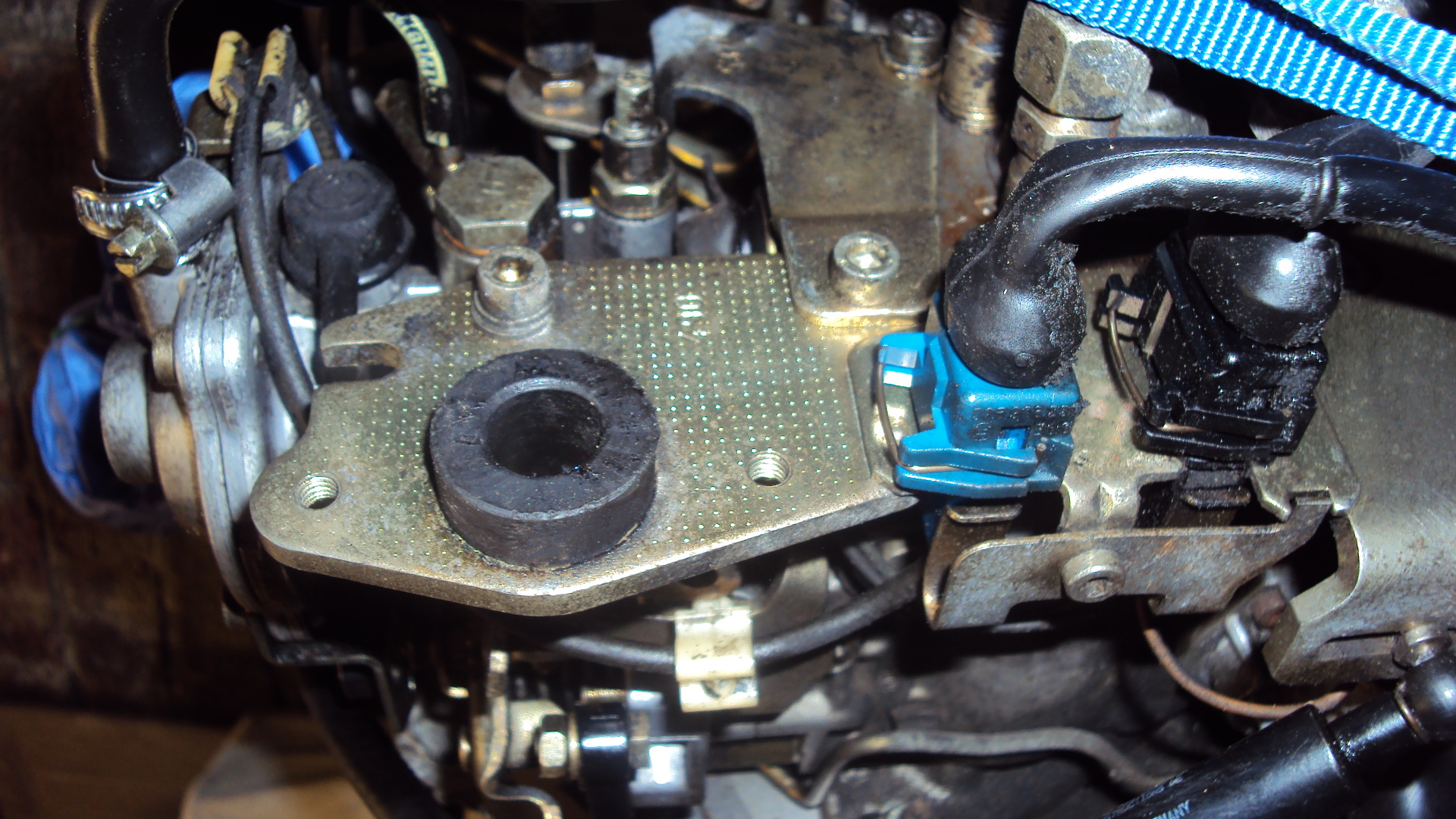

    Hi Dave, The picture with the armour cut away was supplied by PJ Daddy, I havent touched the lump yet, I am an absolute beginner and saw a few items on the pump that suggest that as its from a late model 405 there may be some  type of ecu, control box required, I just dont know?

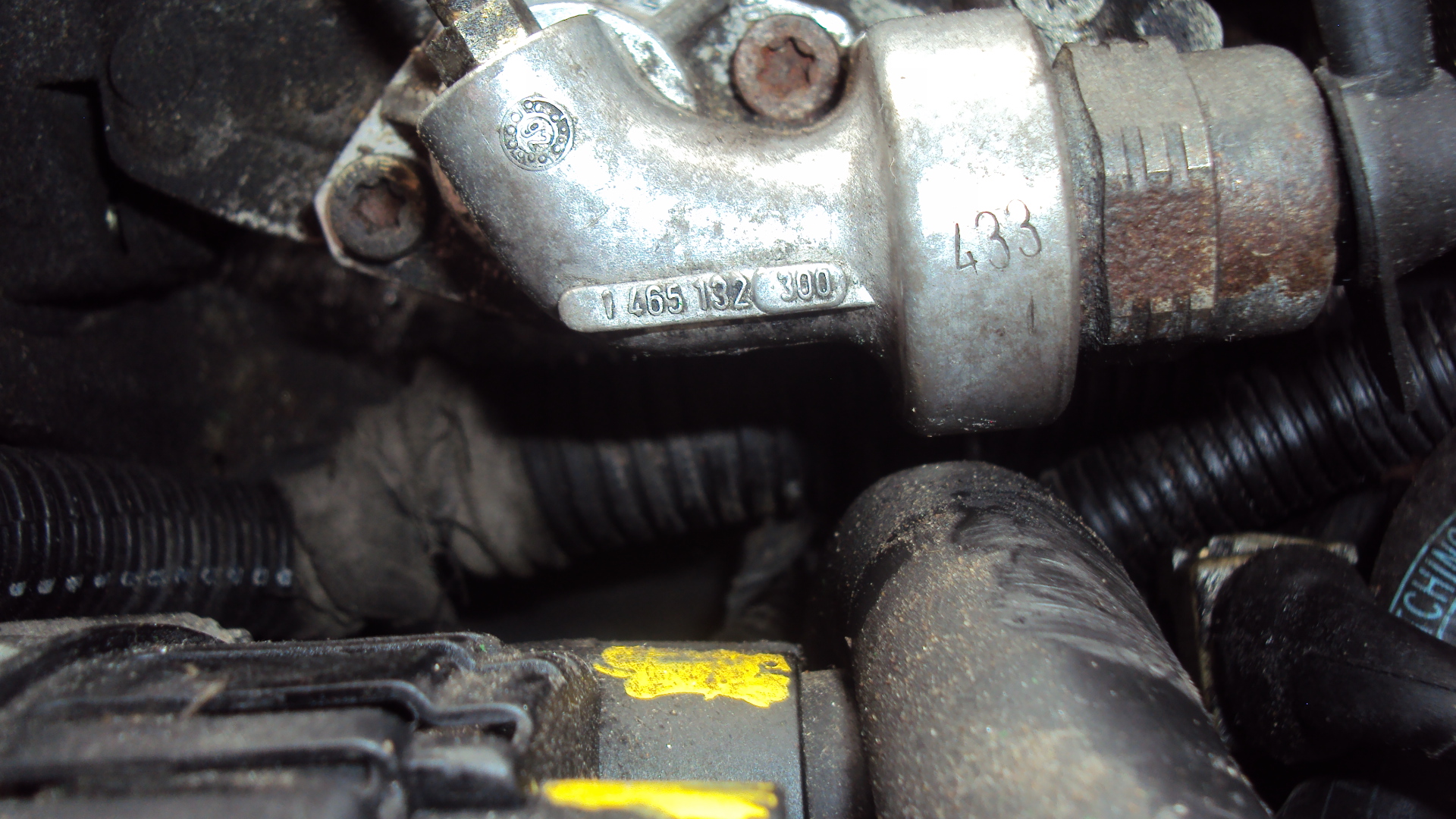

As long as your pump dosnt have this white part with a plug on it then u will be OK this pic is a ecu controlled pump the part I am on about is at the back of the pump down low  think its a Brown plug let us no  wen u get a look at it :-)

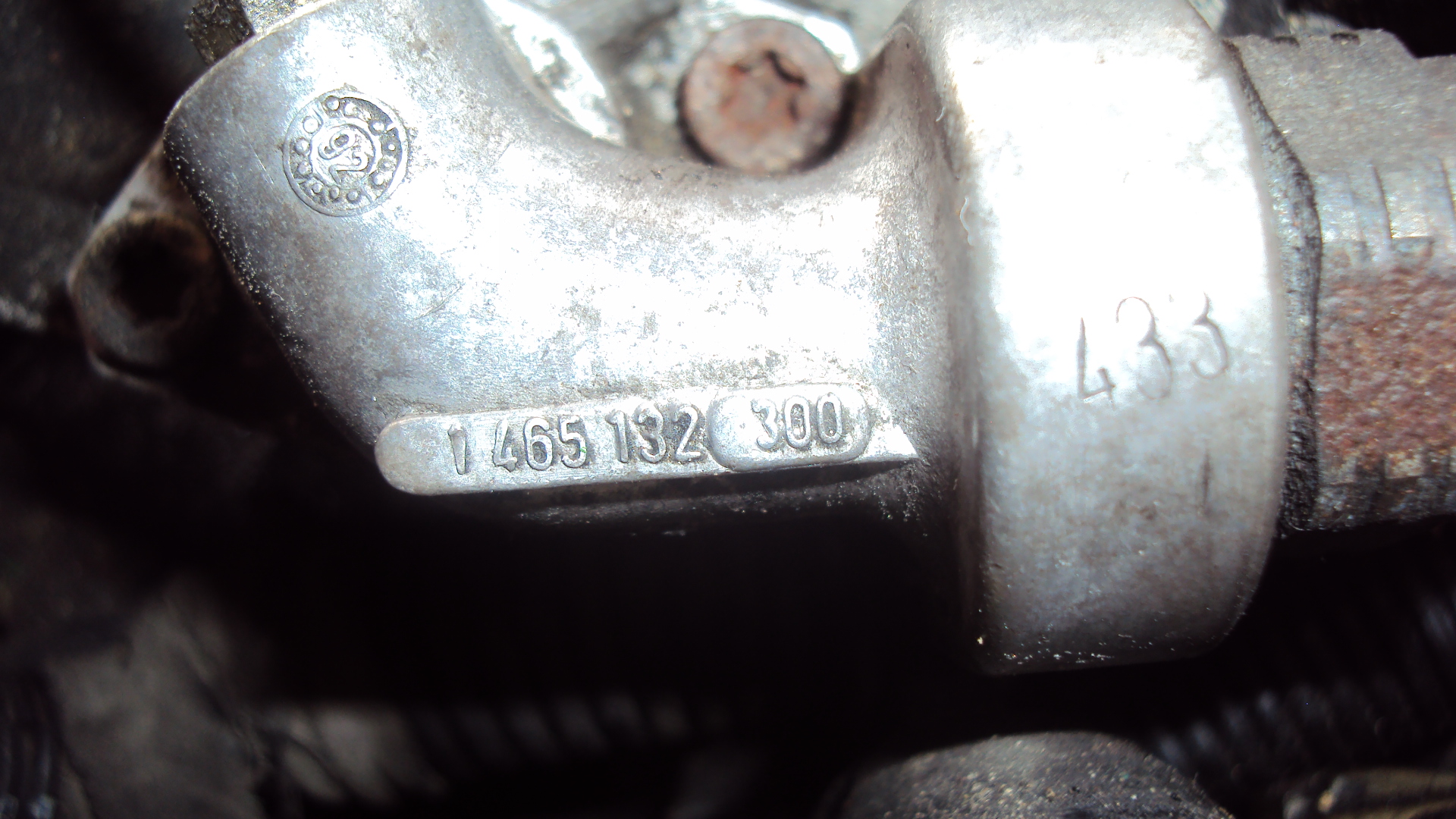

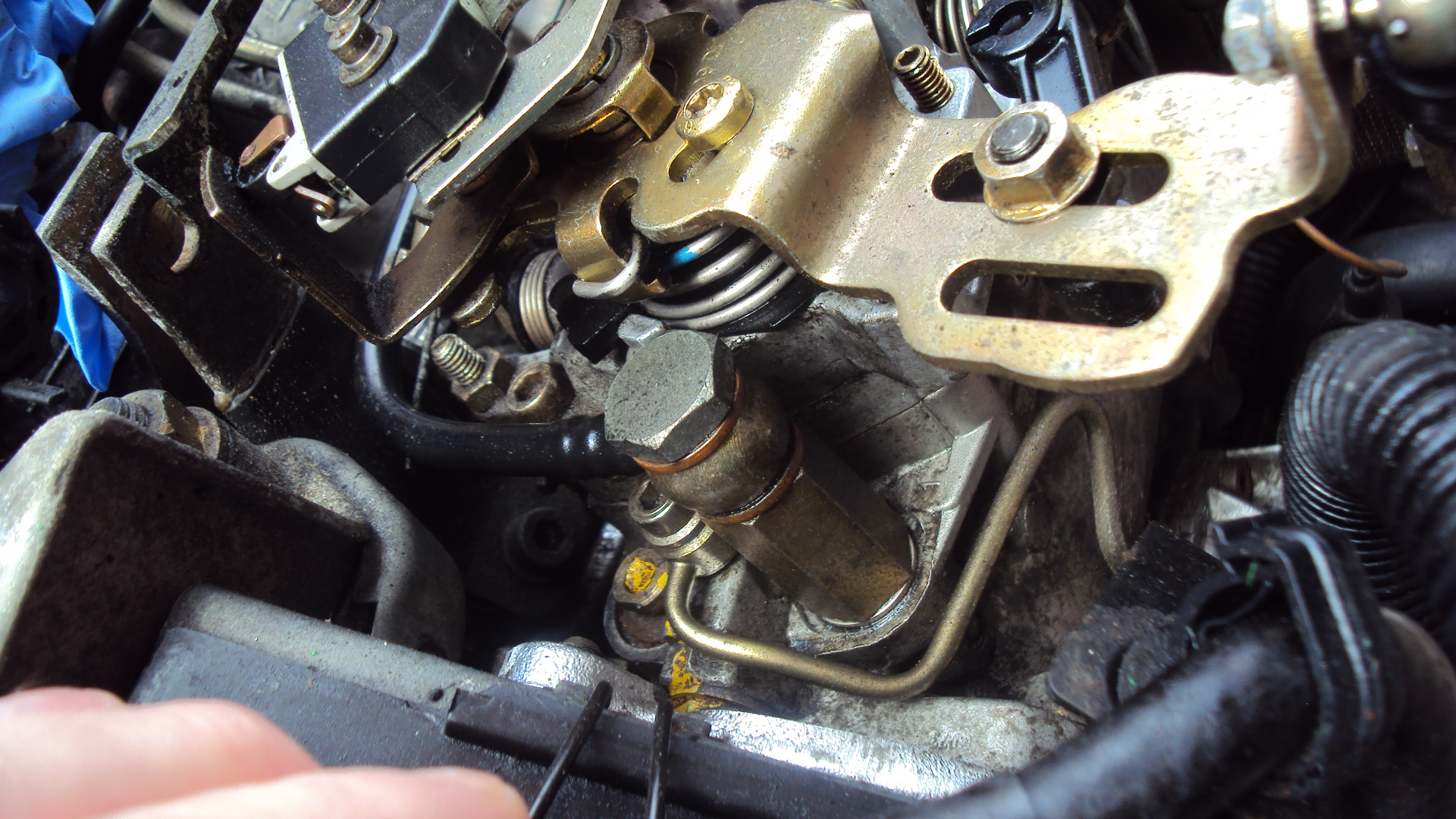

I dont know what this is or does, would it be part of ecu/emissions control DJ? A pipe leads to the banjo type fitment (by yellow paint on middle picture) and it has electrical connection on rhs
Looks the same as my pump as far as I no its some sort of solinod on my pump I just joined the wire to the hot wire on the pump and its runs fine hope this help's how far are u on with the car any way u started in to it yet :-)

The solenoid you're referring to in your photo is called "LFB" which is for controlling Load-Dependent Start of Injection, i.e. it receives pressure from the governor system and increases advance relative to the load on the engine, rather than just engine speed - that's what that thin pipe running down the front of the pump is for. The solenoid power on the front is just so you can increase the timing when cold - it's inactive once the engine speed/load increases enough as it moves past the amount of advance it increases.
Not required to be connected.
(04-04-2016, 03:26 PM)Ruan Wrote: The solenoid you're referring to in your photo is called "LFB" which is for controlling Load-Dependent Start of Injection, i.e. it receives pressure from the governor system and increases advance relative to the load on the engine, rather than just engine speed - that's what that thin pipe running down the front of the pump is for. The solenoid power on the front is just so you can increase the timing when cold - it's inactive once the engine speed/load increases enough as it moves past the amount of advance it increases.
Thank you Ruan...does that mean this bosch pump isnt an ecu version? what does the black box on throttle arm with the roller wheel have (top left middle photo)
As shown above - as long as it doesn't have:
[Image: attachment.php?aid=26933]
It's a non-ECU pump.
The microswitch you're referring to is the EGR switch, this is what would cause the EGR to turn on/off depending on where the throttle is, the fact it has this instantly tells me the pump likely isn't an ECU pump.
