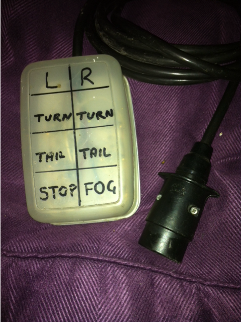

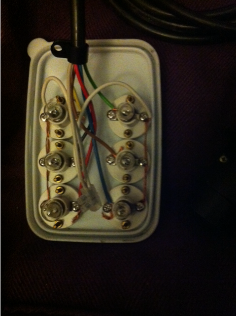

It turns out, that according to the instructions, White which they say is reverse, is in fact earth....... so tonight i made a small test rig, It only tests indicators, side, and brake lights
But i had the litle amplifier box re-wired in and all working with in an hour thanks to this little rig,
so, if any one in the local area (Eastleigh and surrounding areas) wants to borrow it, feel free Smile its saved me going and getting another trailer to test my electrics. Now i know they work perfectly and as described on the packet.

images as promised;
Hate Housework!
(03-12-2015, 05:54 PM)Magenta Sunset Wrote: images as promised;
ThumbsUp simple, effective, i like it Smile
got to love the old lamp holders from electronics club Smile
