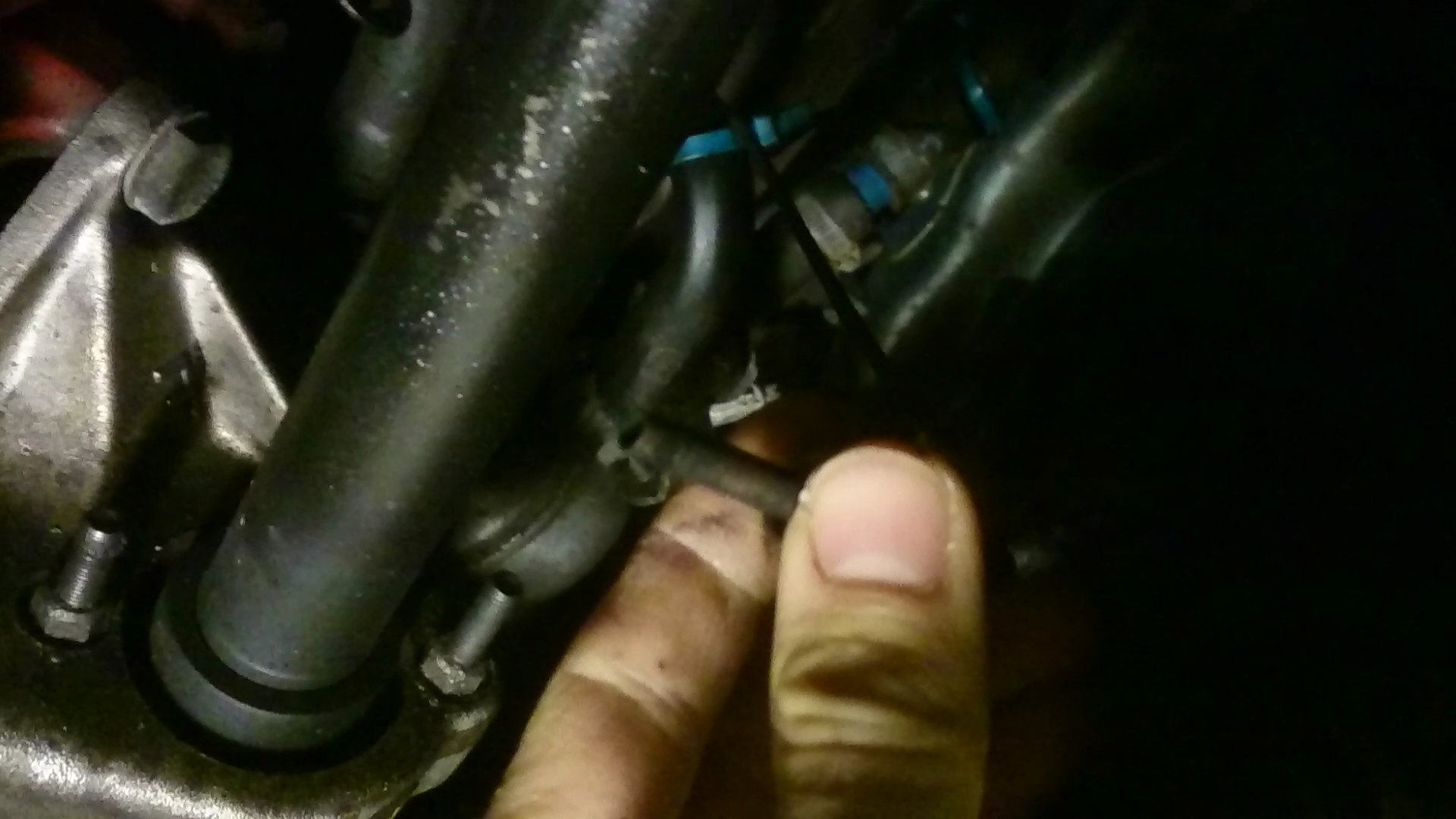

New fail for the DarrenDyno...
Why you don't buy a cheap EGT probe...

Well that confirms the problem then

(03-12-2015, 05:57 PM)Dum-Dum Wrote: Well that confirms the problem then
That pic was taken in Lobbland
