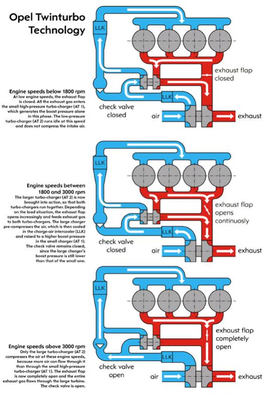

No means to rain on your parade - whilst what you've proposed will "work" - you need to think about transient conditions and what happens then, you're thinking in overall pressure, you need to consider what happens when you put 5lbs of boost infront of a smaller turbocharger, then suddenly take it away - and put it down the inlet instead - what does that do to the manifold pressure, also what does that do to the smaller turbochargers compressor efficiency, since now the operating conditions are totally different...
There's really no need for the check valve you have in your setup - you aren't moving anything like enough air to require them. You'll quickly realise that as soon as you open it, the pressure will suddenly drop (read up about the compound effect), you might as well go full compound, since soon as the big turbo spools up, the pressure ratio will drop across the smaller turbo and therefore flow rate will increase - removing the need for the valve - remember the smaller turbo is now not producing much pressure, merely flowing the air that the larger turbo has compressed above ambient - you just need to control the exhaust gas flow across the small and large turbos well. Long as you set your wastegates up correctly (you'll probably want to do this with some electronics)
Refer to diagram below for proper compound setup:
[Image: tts4.jpg]
Your limiting factor is not gaining more inlet pressure, since you can't use it realistically - rather spool capability - you might be wiser to use a modern BorgWarner EFR/Garrett GTX or similar with a appropriately sized turbine housing which would outperform a compound setup, cost similar and be more reliable under transient conditions. You can't shoot for insanely high inlet pressure without serious problems with knock, unless you're running on super dooper race fuel... An EFR has such a WIDE compressor map, you'll realistically be able to get a big turbo to spool fast, not surge *AND* provide a crapload of air at high RPMs.
Compound setups like you're suggesting are GENERALLY used on high power diesel setups, where 5-6bar boost is required - you can't realistically use more than about 25lbs without serious drops in compression and different designs of cylinder head which are better for combatting knock.

Currently speaking to a few turbo specialists about my setup, the check valve is to stop compressed air from the first turbo recirculating during stage 1

This is what Ive based mine on...
U do realise just ecu sensors injectors will probably eat your budget up once youve been mapped.
Notice that precise design is for Diesel motors which need very high boost pressures - turbocharged petrol motors don't... You simply don't need this - just run a single, GOOD turbo - I'm all for interesting stuff, but it's pointless, will eat money and the outcome will be poor since you simply cannot use the amount of boost pressure you're on about.
You also need to study the compressor maps if you are to make the setup you're on about work - the turbos you're intending on using are very poorly specced for that job.
(26-11-2015, 06:37 PM)Ruan Wrote: Notice that precise design is for Diesel motors which need very high boost pressures - turbocharged petrol motors don't... You simply don't need this - just run a single, GOOD turbo - I'm all for interesting stuff, but it's pointless, will eat money and the outcome will be poor since you simply cannot use the amount of boost pressure you're on about.
Surely this setup can be run at lower pressures to suit?
1. I cant find a compressor map for the T28 and 2. Im still waiting to find out if my large turbo is in fact a GT40
And like I said, they came up cheap so I got them, Ill just sell one or both if I must

Well, you could, but that defeats the whole object of what that configuration is trying to achieve - that's designed to provide high boost pressure, which is precisely what you don't want - because you cannot combat the issues with detonation before you actually start being able to utilise the boost pressures provided by a system like that at low RPM.
Why have any of the complexity and inevitability that it'll all go wrong, jam a valve shut and either produce insane boost pressures or not make any, when your money, time and resources would be better spent getting a single _good_ turbo to work efficiently...
I see so many crazy, hairbrained ideas which are all well and good, but if it's too complex, it just won't get done.
Just actually begun to look at compressor maps to maybe attempt to prove to you how far out you are with those two...
With 3 seconds of googling I found a T28 compressor map which proves that at the maximum pressure it'll provide PR2.8 it'll provide around 25lb/min airflow - enough for around 250hp. At absolute maximum airflow on the choke line which corresponds to around PR2.0 - you're getting 33lb/min.
Start to look at the GT3782 compressor map - well, 25lb/min hasn't even hit the first efficiency island barely, move to 33lb/min - we're only just beginning to look decent here on the GT37 compressor map, but the first turbo will now not be able to provide any pressure, it's overspeeding and choking up... To move 25lb/min into the engine at 4000rpm, you'd need PR2.8 - where you're RIGHT up against the surge line, because now the primary turbo is running out of puff...
They're very badly matched - the T28 isn't a high pressure turbo and is too small anyway, the GT37 is too big anyway - you'd run it into surge because the small turbo can't move enough air. If you were looking for a setup to do 4bar of boost to provide 380hps worth of airflow, but maxing at around 4000rpm, a GT3271R and that GT3782 would be a nice combination. But you don't need high pressure to get high horsepower, just rev it to 7k and realise you only need 22psi boost at 7k to make 380hp - but you needed 50psi boost at 4k Smile
TL;DR - get an EFR/GTX.
