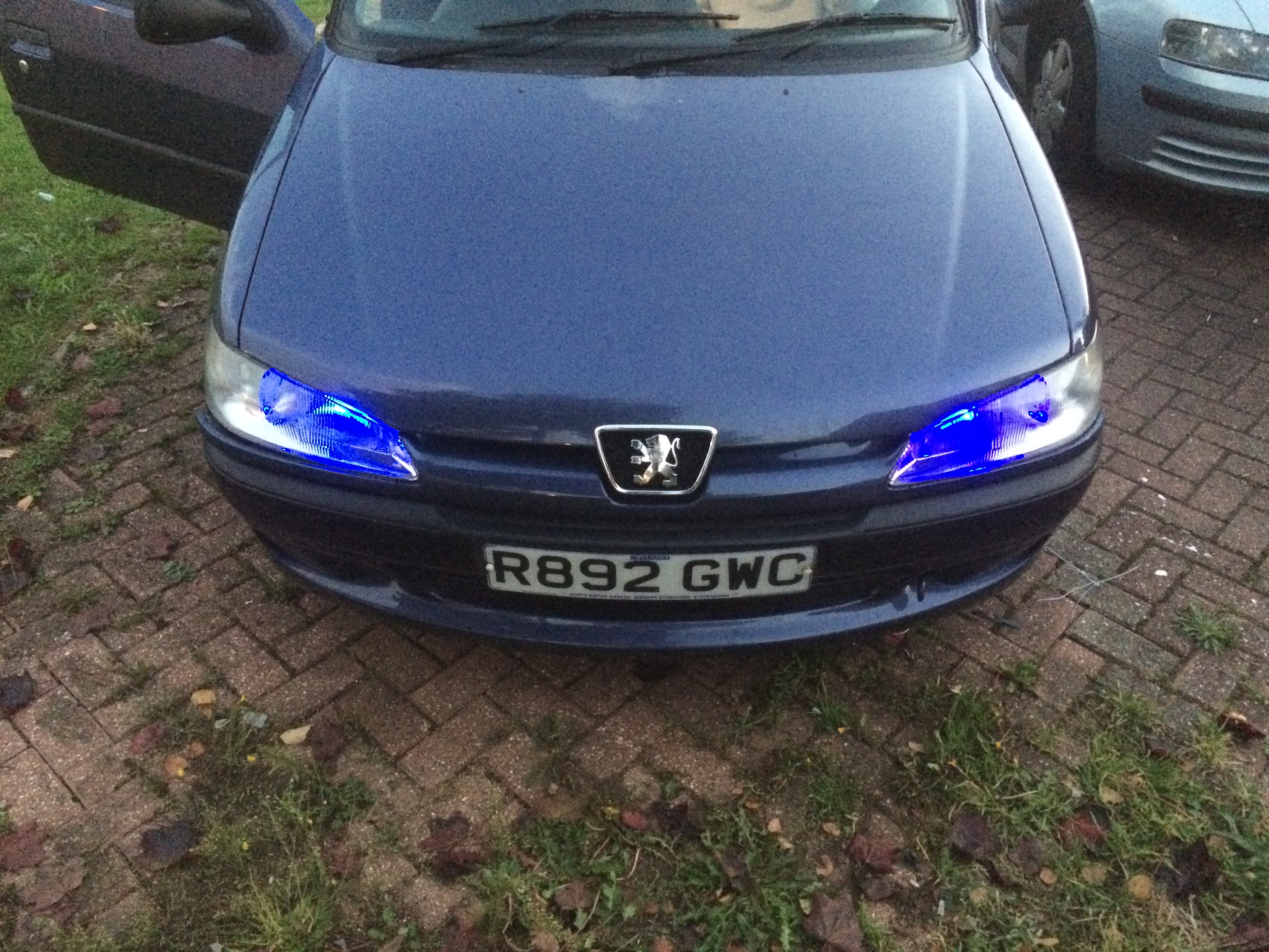

Lose the illegal side light bulbs & you'll make more friends Smile
We have a resident police officer on the forum who will arrest you for having gay lights.
Have put them in the interior already! Haha! Did think they looked abit silly and just asking for trouble

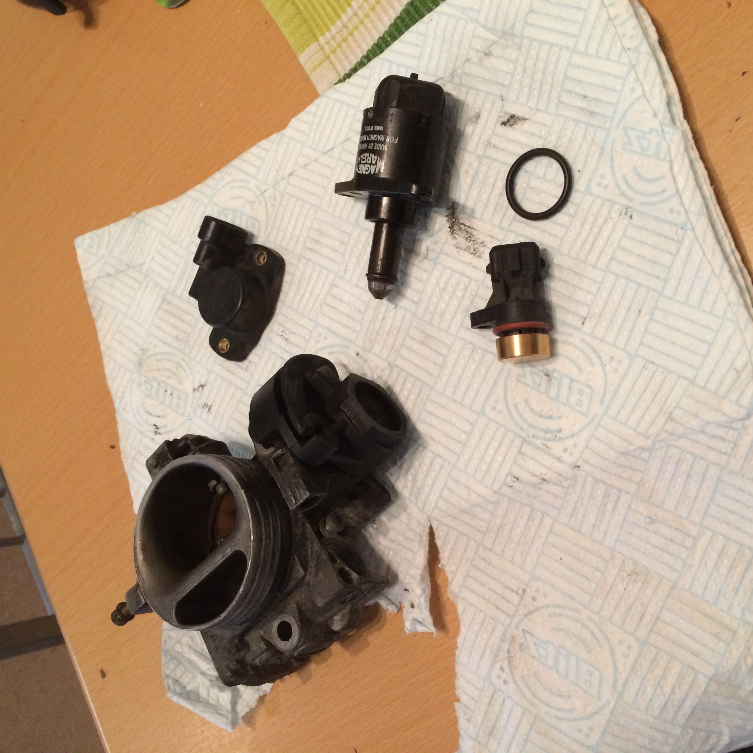

Most common cause of this is a blocked /dying ISCV (Idle Speed Control Valve) on the TU series engine (fitted to your car)
Its easy enough to remove and clean / test / replace Smile If i wasn't at work right now i would be able to post a detailed picture but there should be something about it in the guides section i'm sure!
Its located by the T/B (throttle body) and should have a 4 plug plug into it, the valve is secured in the T/B with 2x T25 (IIRC) Torx screws.

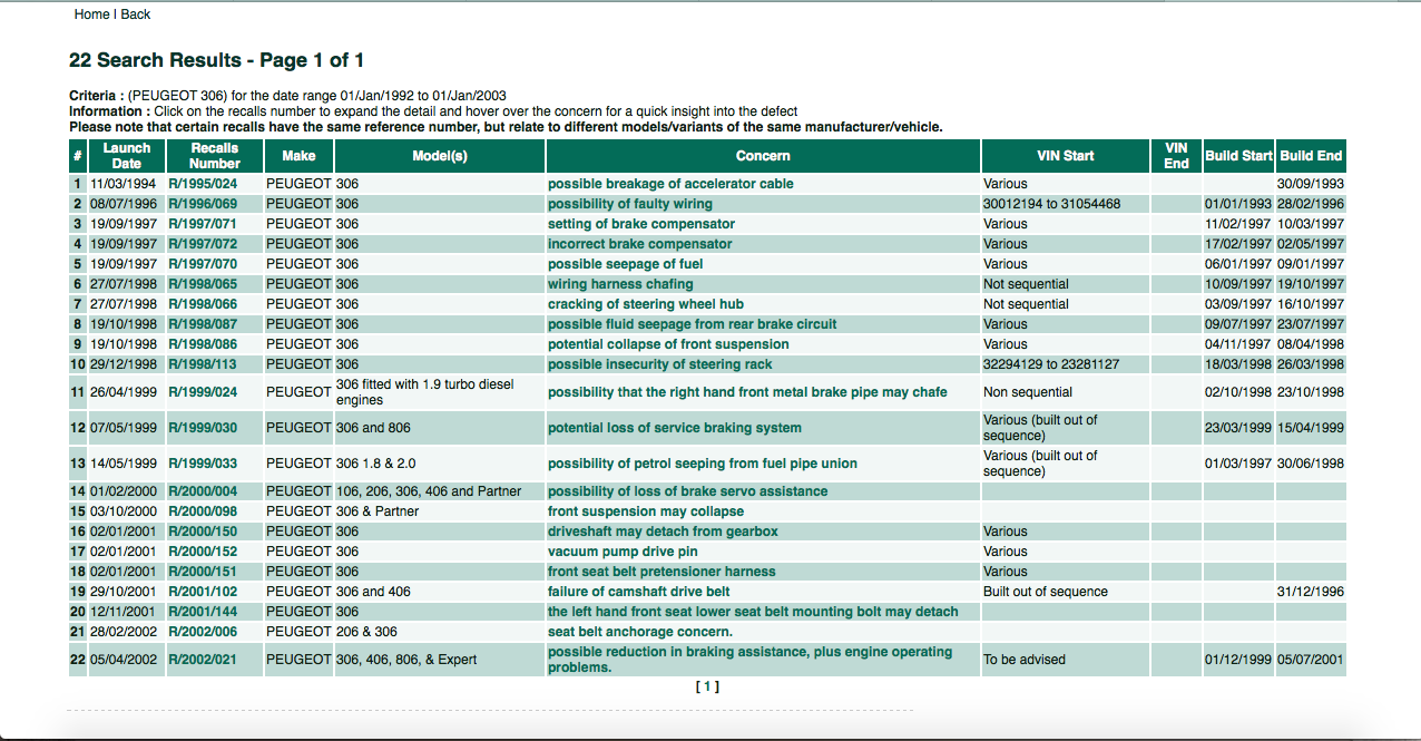

Sorry bud but the recall thing is bullshit. Here is all the recalls on the 306

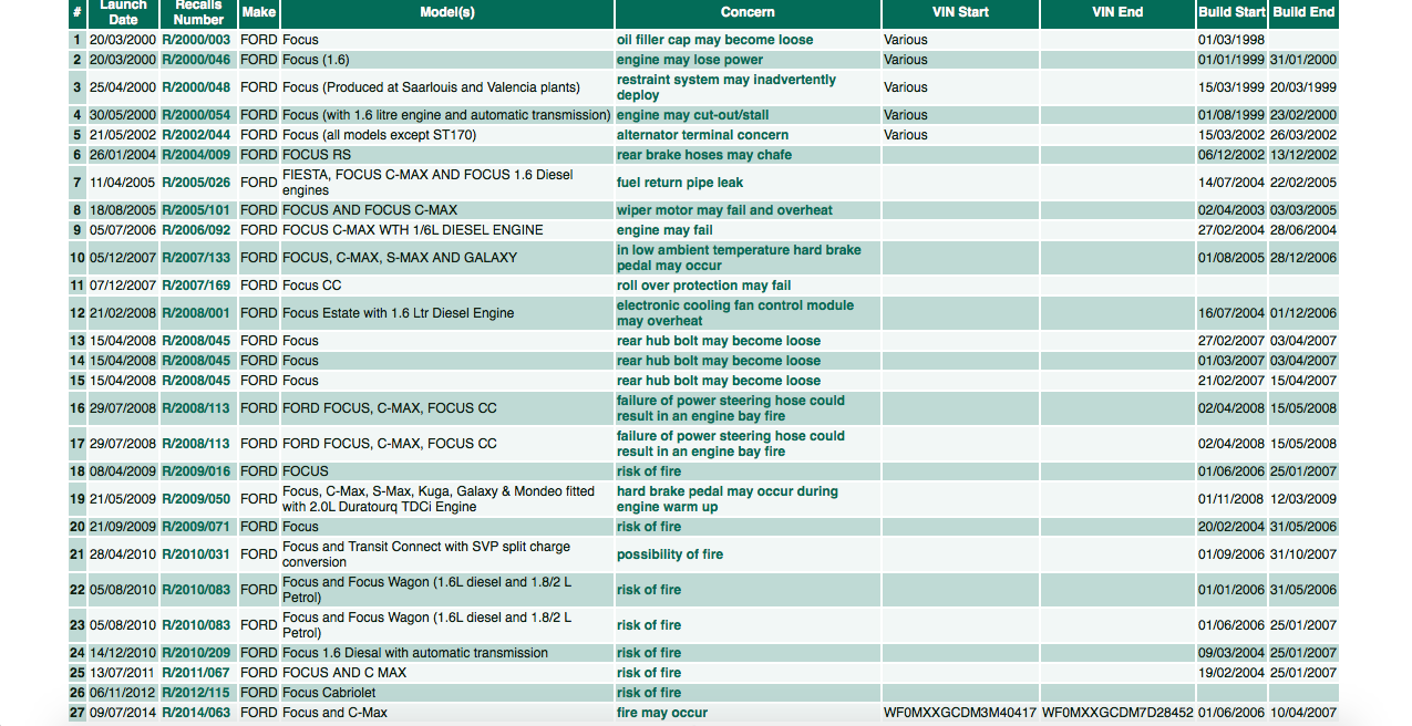

And just because i know Tom will come along and slag everything except for what he owns off, heres the recall log for the focus Wink
Cheers guys I think I found it was the manifold pressure sensor? Seems to bog out when I wiggle them a little so will chop and solder and get a new sensor! Hope this works! Thanks for your ideas guys! Will get most the (intake) box sensors done asap! Process of Elimination I think! Will try the map sensor first and will let you all know! Then throttle position,maf,and the icv cheers guys! So much help also already checked the fuel filter, plugs, coils, leads, and also electrical fuses, but thanks! Smile

Blimey, risk of fire comes up an alarming amount of times for Fords
(24-09-2015, 07:10 AM)Paul_13 Wrote: Blimey, risk of fire comes up an alarming amount of times for Fords
Yeah i think thats from when owners realise they have made a mistake in buying it though rather than something going wrong with the car lol
Love the 'Because i know tom will comment' lol
Team Cyril
So if you own a focus...
Expect to:
Lose all brakes after brake pedal goes hard...
Then lose your rear hubs.
While this is happening you lose power after the engine has overheated, have an engine fire shortly after also losing pas, lose your oil cap, struggle to keep vision as the wiper motor burns out...
Then just as you are trying to stop safely to call breakdown/fire and rescue, the restraint devices go off and you need an ambulance from 3 fractured ribs
(that's assuming it starts in the first place)
Rofl
That's over different Mk's of Focus Piggy... Mine will just explode in fire with a loss of PAS from the looks of it (build date March 2008). That is slightly worrying though. lol I have seen a few engine bay fires on the Ford forums, all have been CMaxs though for some reason.
