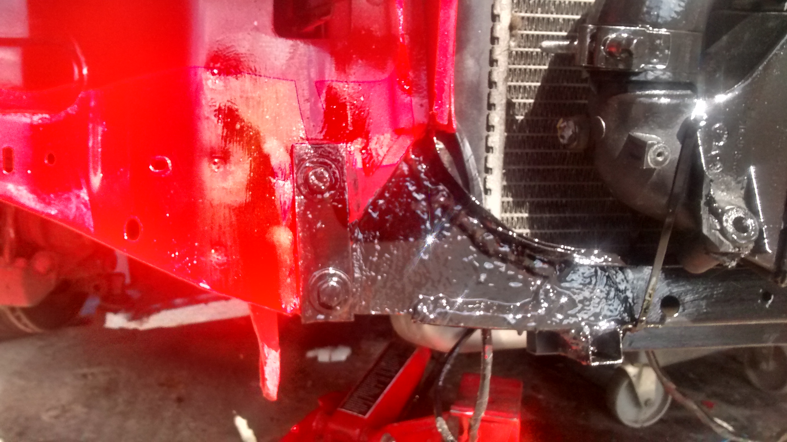

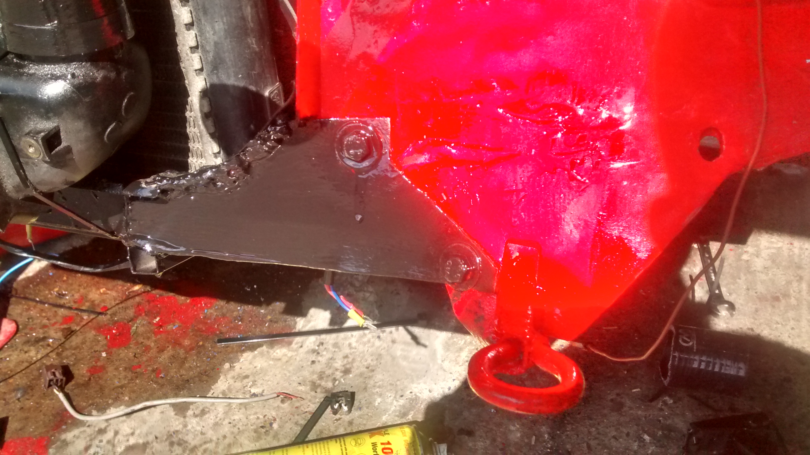

Made up a mount for the radiator
[Image: IMG_20150521_124258809.jpg]
Then sprayed it black
[Image: IMG_20150521_175530602.jpg]

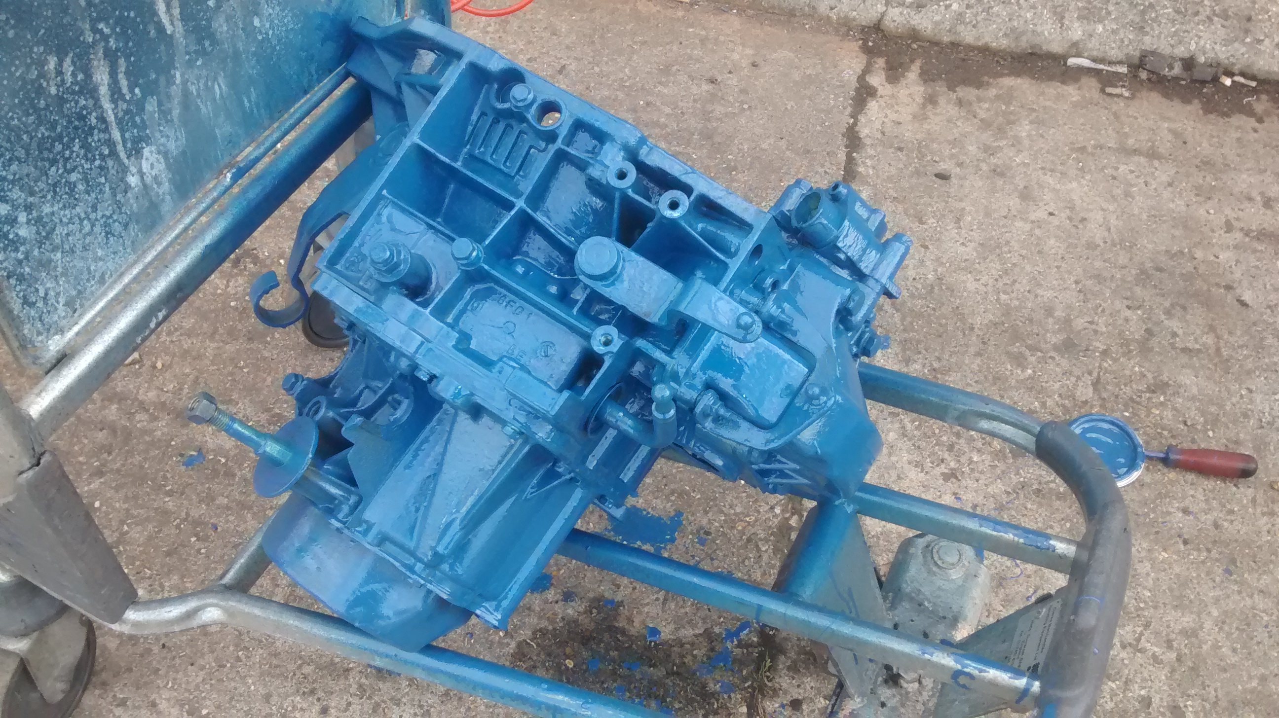

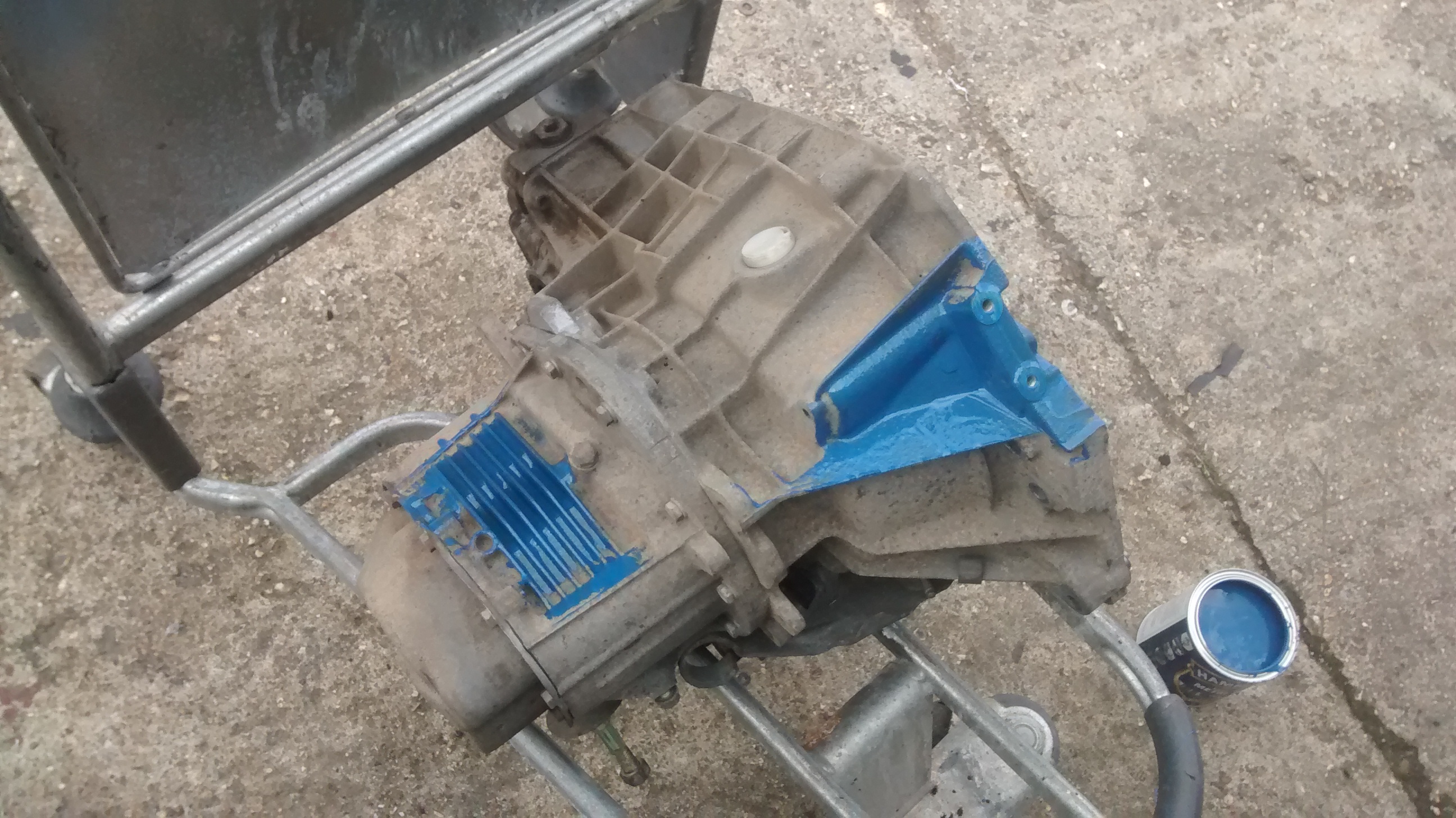

managed to grab some time today and paint the gearbox ready to go in as soon as I get a chance ,ignore the "borrowed" air port trolly

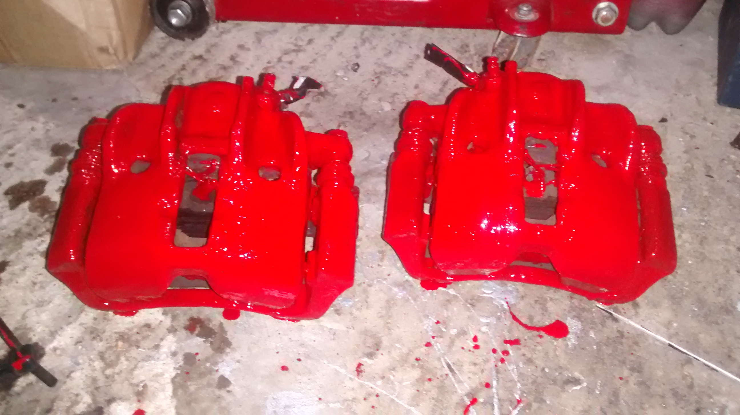

Whilst I had the brush out I gave the callipers a going  over

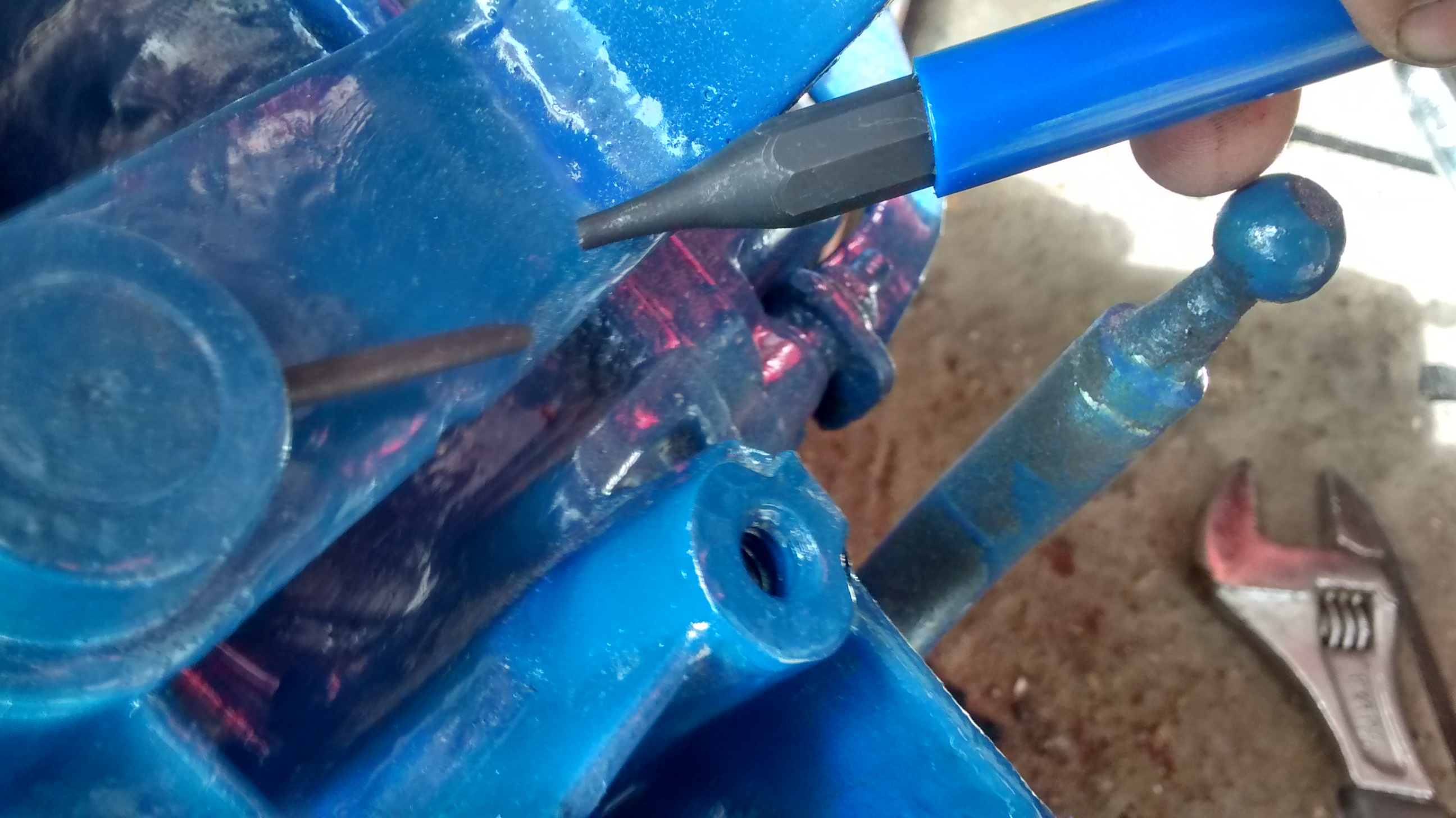

Gov mod

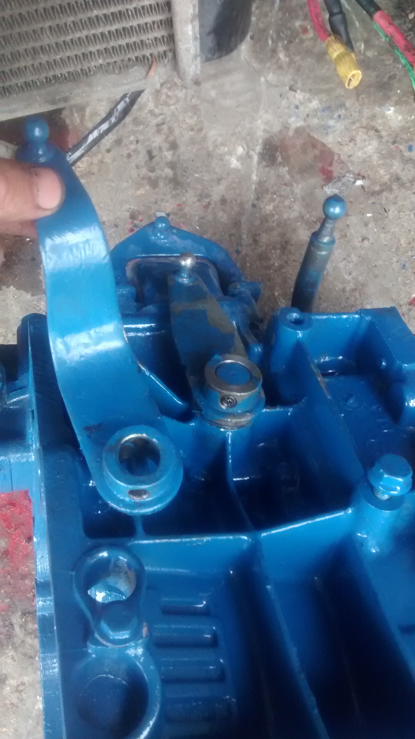

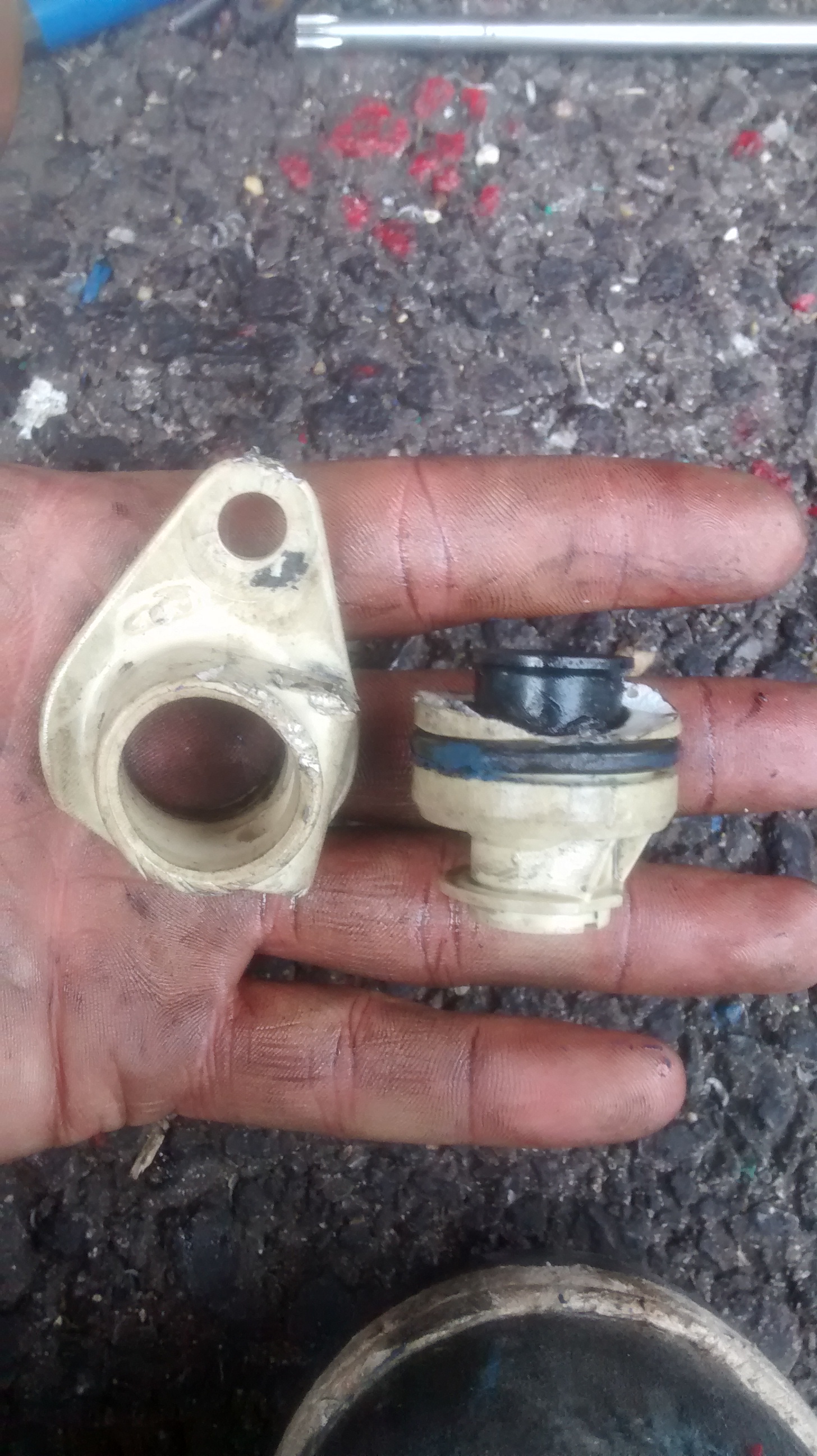

Swapped gearbox selector arm - what a b**ch broke a punch, hit my hand twice and broke the speedo drive somehow

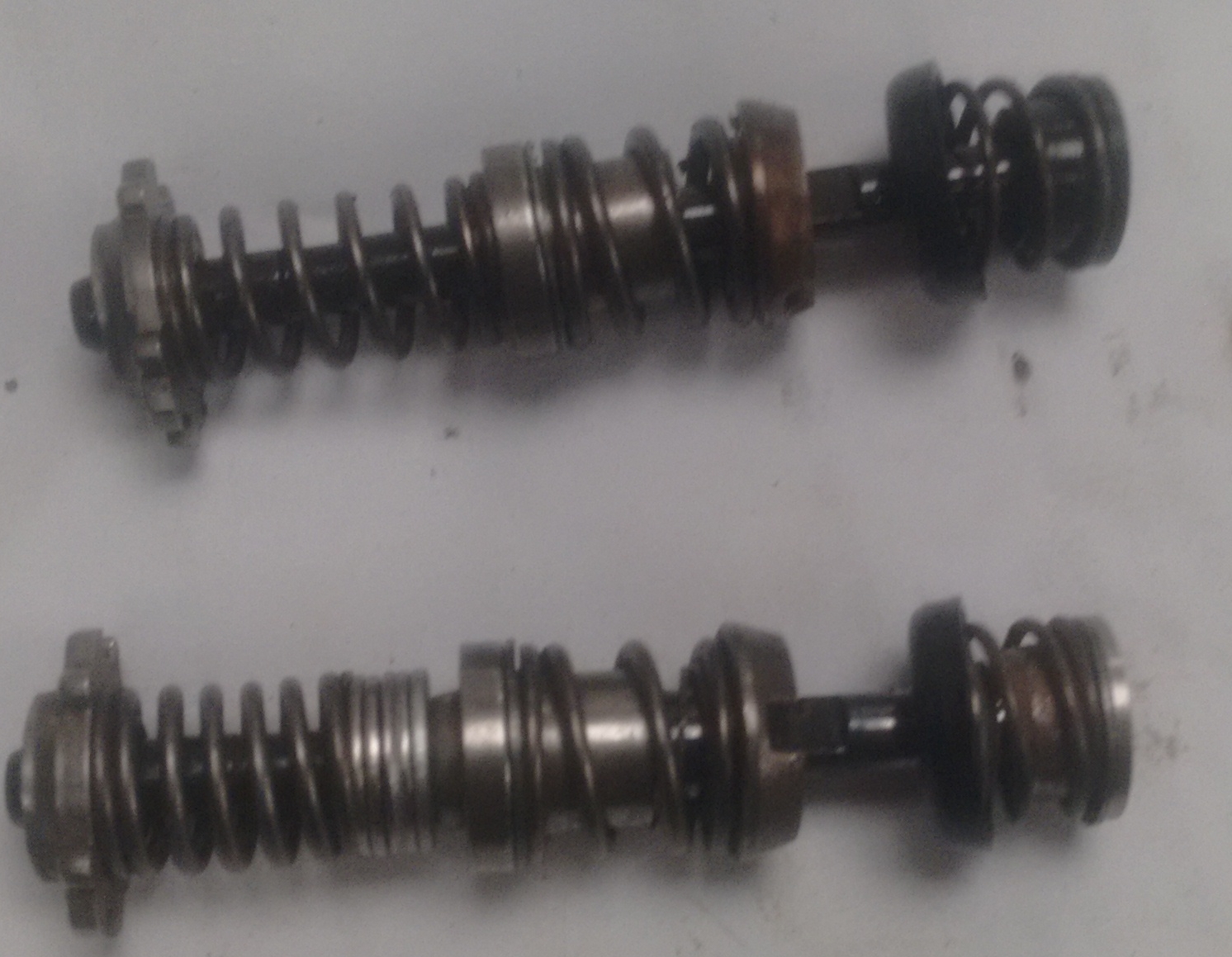

Also this came out of the old gearbox - definitely shot

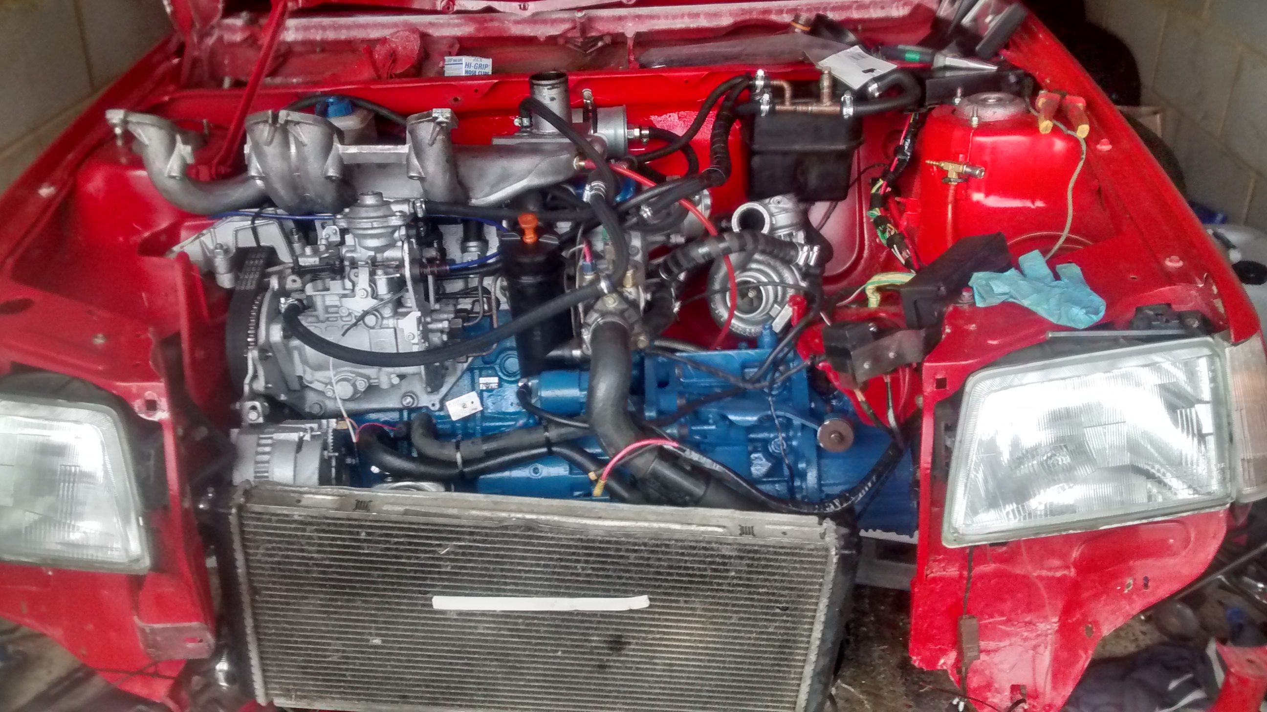

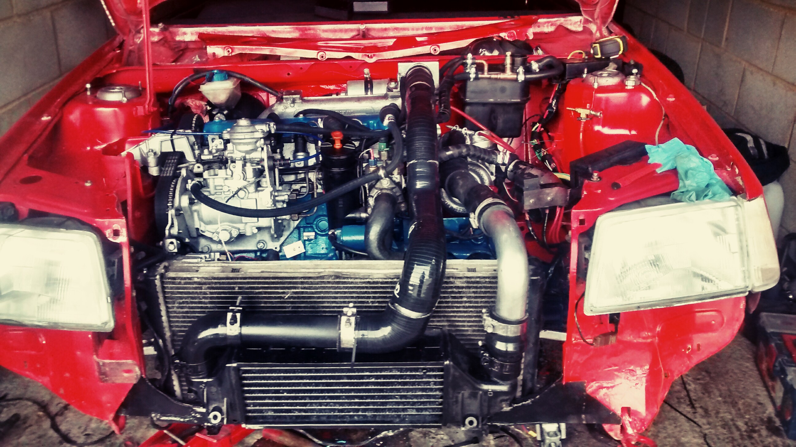

Put the engine back together then worked out the intercooler piping again as wasnt very happy with it last time, need to but 2 more 90s as its 2 reducing 90s bodged together atm and eventually will all go blue with black metal, except behind the bumper which will all be black. Painted the cooler black aswell as dont want it too obvious.
Cherry red 205 XUD VNT - Project thread here http://306oc.co.uk/forum/showthread.php?tid=25522
That looks bloody nice Inlove
Thanks! Should look better when I get the blue silicone but for now the black will do.
Today I finished the radiator/intercooler mounting bracket thing me and my mate made. I wanted to keep it removable cause it made taking the engine in and out soo much easier so drilled some holes made another little bracket and bolted it to.
Excuse the hidious welding on the bracket, it wasn't me I swear !
Then I stuck the bumper on to check clearances and all is good, need to move the licence plate or it will block the intercooler though
Does the boost pipe in the middle clear the grille?
It will when the 90 iv ordered turns up, currently I don't think the left one will
