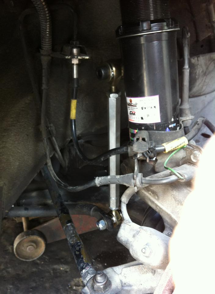

Anyone had experience with these? Looking to drop my car by 40mm
The length of droplinks are depend on the suspension set that you fitted, Some coil-over set (Like a D2 or K-Sport) when adjusted to lower about 2-3" the position of the droplink joint at Shock absorber cylinder will move lower too, And will cause to the ARB to touch with LWR arm.
In some case, If you fitted the Bilstein B8, OEM Absorber or another suspension kit with Lowering spring that can't adjust the position of joint position at Shock absorber cylinder, You need to find the longer Droplink.

I ordered the droplink from him also, Currently in use without any problems. Rofl

Maxxy is that your set up in the picture? It says in the description that you need to state desired length bolt to bolt, do you know what you ordered?
(05-08-2015, 06:40 PM)306rhys Wrote: Maxxy is that your set up in the picture? It says in the description that you need to state desired length bolt to bolt, do you know what you ordered?
Yes, the picture was my car.
The length of droplink that i ordered were 280 mm. (Up to your suspension kit and set up)
I ordered from him due to above reason, please measuring the desire length from your actual car when it parking on the surface plane and they can be adjust to more or less a little bit.
