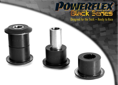

Ah so when fitted it will be more than 62mm so unlikely mine will fit. Be interesting to see how the new 1s they will send you are different
(23-06-2015, 12:45 PM)Frosty Wrote: Ah so when fitted it will be more than 62mm so unlikely mine will fit. Be interesting to see how the new 1s they will send you are different
Real simple, they just won't have that extra 1mm or so after the chamfer on the end of each bush
as per the stock product pic
[Image: %24_1.JPG]
