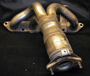

is the manifold like this one at the end, where it meets the down pipe?
[Image: 005-3.jpg]
No its 4 to 1, like the one on it now and the current downpipe.
[Image: signaturerrf_zps1c82612b.jpg]
hope you haven't bought the same manifold twice!
No its been sat here a few weeks, is a tube manifold with pre cat that goes to one pipe.
The one on my car now is cast.
It wont be going on for a while anyway, more concerned about mot time Wink
Like this one off google.
[Image: %24T2eC16NHJGgFFm8H!ZRMBRg9OwfTeQ~~60_35.JPG]
that looks off a later rover, as it has the ends for the manifold heat shield.
