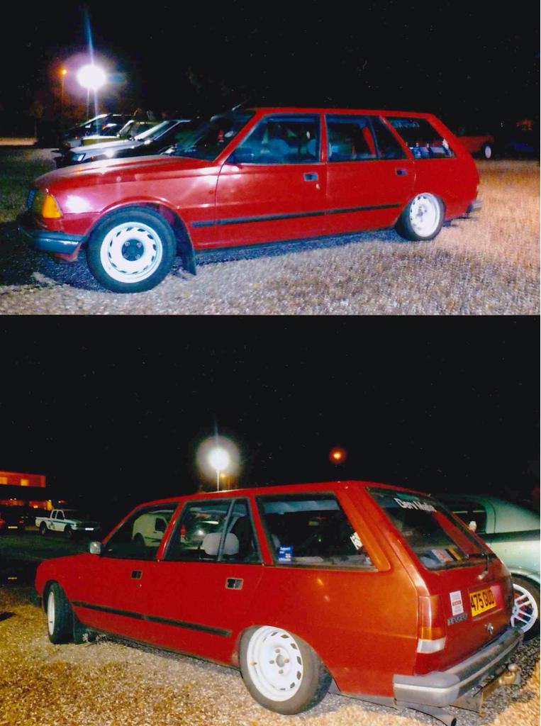

(20-11-2013, 09:36 PM)Sambarker Wrote: Couple of pictures from Retro rides start of the month
[Image: attachment.php?thumbnail=11602]
LOL parked next to the most retro of cars, an Astra G

[attachment=13975]
Wheels are getting coated white and skinnier tyres. Plenty of poke
