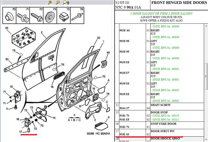

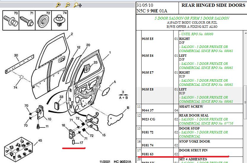

I've remembered the difference now, on ph3s they have a pin which is colour coded and flat on both ends (not like a roll pin that you can hammer out)...anyone with a ph3 can have a look..........I'd show you a pic if i still had the pug.
As tom says, the ph3s are 1 unit, but only on the front, not the rear.
For the straps them selfs theres a from and till build code, so the from ones will be the complete unit.
