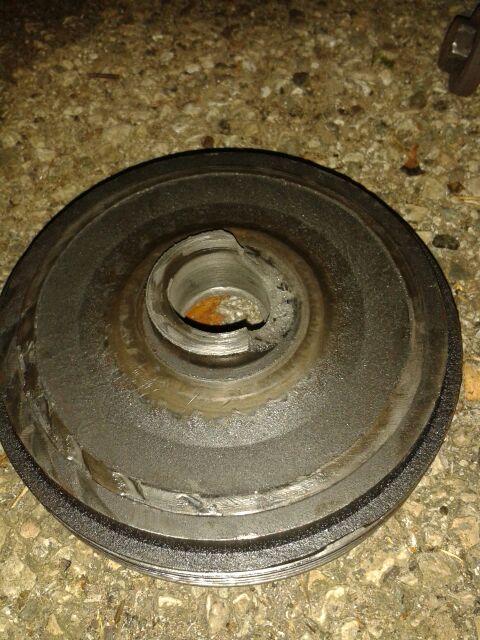

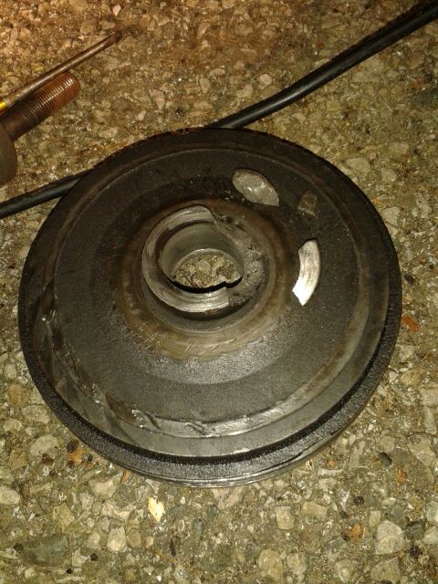

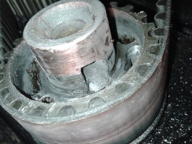

So, what seems to have happened is the woodruff key has worked its way loose and caused all sorts of issues.
It is a bit hard to make it out in the photos, but there are parts of the crank pulley jammed in the pulley behind.
Initially I felt quite fortunate, as it did not go into the cambelt, but the end of the crank is mashed.
Such a shame, as the engine still runs fine. Ah well, it's lasted 7 months Confused

So the cambelts still there and the engine is fine?
What the hell are you moaning about aha lucky as shit!!
cant you replace the pulley?
Change both pulleys / keyway and the bolt and you will be good to go.

(27-11-2013, 08:20 PM)darrenjlobb Wrote: Change both pulleys / keyway and the bolt and you will be good to go.
The crank's fairly mashed though, as you can see in the 1st picture, surely it'll just go again?
Exactly the same thing happened on my xrdt. Changed both pulleys, cleaned up the keyway with a dremel and put the crank pulley on stupid tight. Engine was fine 20k later (when the hg went)!
HDi Cabby Project Click
Ok, thought the damage done to where the key sits was too great.
So, if a new pulley is put on, it should be all good?
Just get it all back together, get some threadlock on the pulley bolt as well. Once its all on it shouldn't go anywhere. Even if it does then you are not much worse of than you thought you are now!! As said, mine did EXACTLY this and lasted 20k (could well be more than that)

Yeah, its mashed, but with new bits, and a good tightening, i expect it will be fine.

My concern is that because I am wanting to sell the car, I don't want to take risks.
I would just feel incredibly guilty if in 'x' miles/weeks, it was to fail!
We'll put it back together then and see if it works Smile
Sell if for f*ck all then.
If you spend 400-500 quid on a car and it makes 20K before it go's pop then you'd be pretty happy.
Just be honest when you sell it then. If it goes to someone on here they will know the score anyway and if it does die then at leas there will be a community here with advice on what to do next.
Yeah, it'll get fixed as best it can be and taking that into account, I'll drop the price.
I cant see there being any problem with that as long as you use two new pulleys, and torque the bolt TIGHT with locktight...the key dosnt hold strain anyway once its tight, EVERYTHING just pushs against the rear of the crank, so unless its so worn it wont run true, it should be fine Smile
