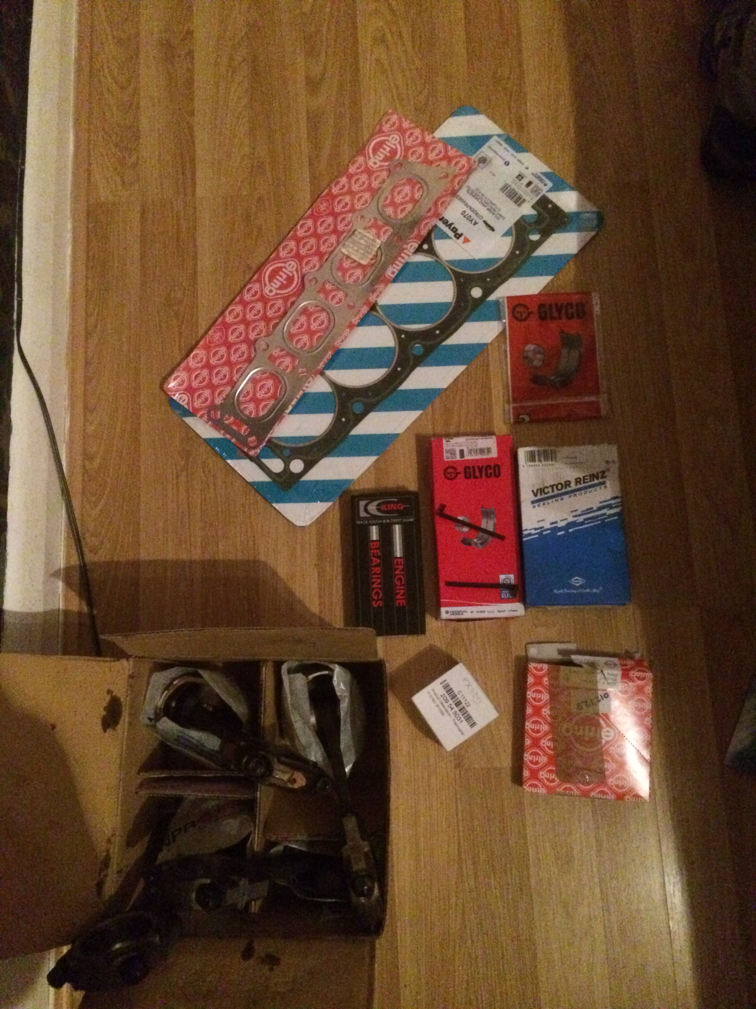

Right so few bits have happened but nothing really worth shouting about. Im in the process of hoarding engine bits for the engine rebuild but hoping by the end of the week, ill have all my engine parts so i can spend next weekend rebuilding my engine! More pics in the week Big Grin
So nothing has happened to the engine since the weekend. Just been hoarding parts which i have got almost everything i need now Big Grin

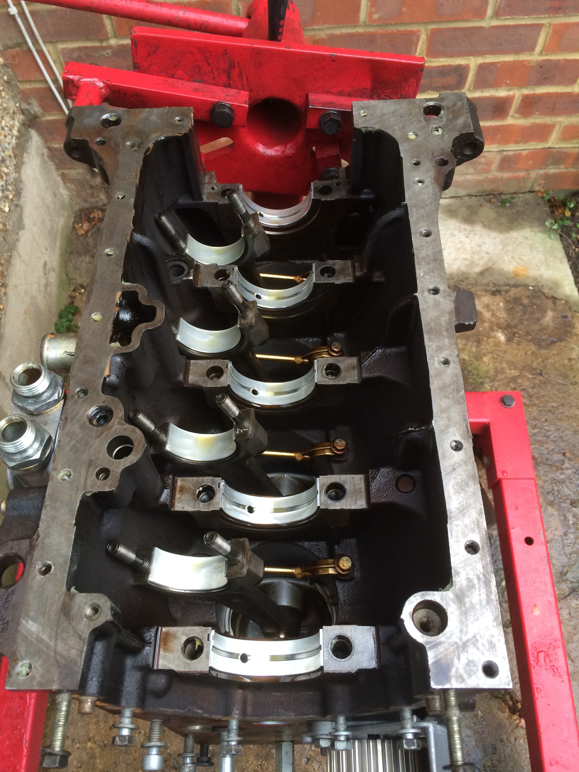

Bit of work done on the block last weekend
On call this weekend but providing i have a quiet weekend, the engine should be mostly rebuilt Smile

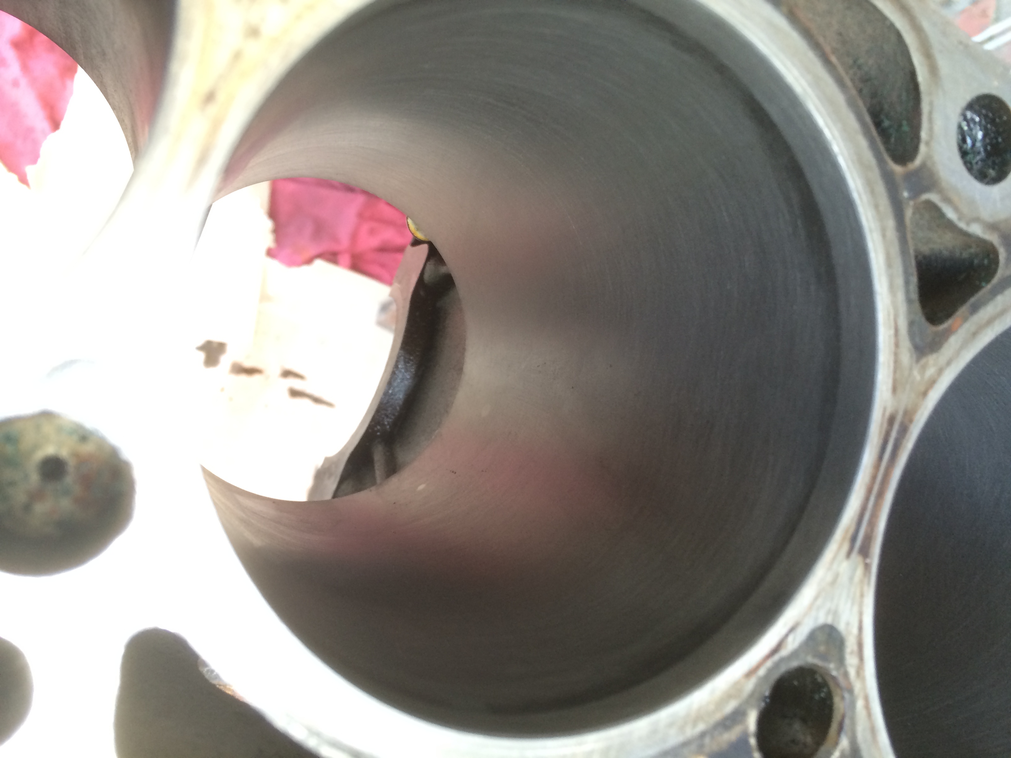

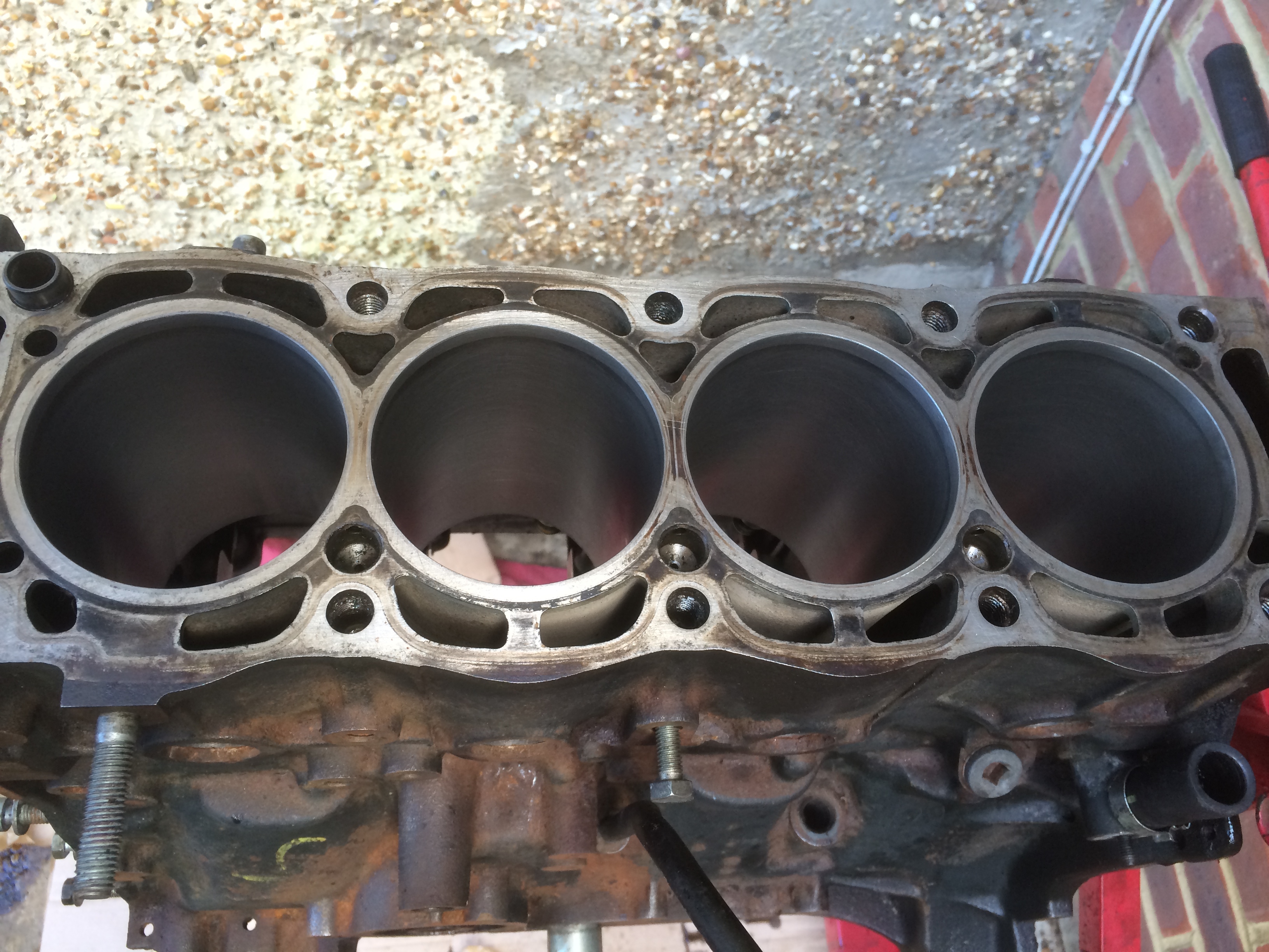

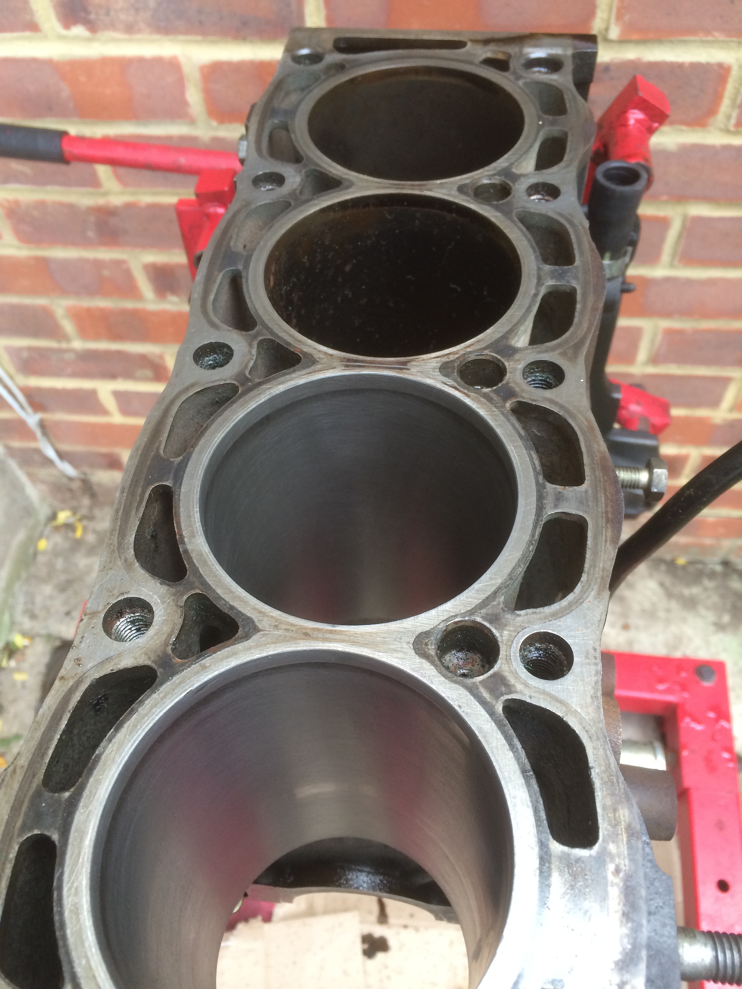

How well does that 'home brew' kit work;
Looks like it's done a good job! Have you measured after also, havnt taken too much off?
In the words of the virgin Mary, come again?
Do you mean the bore honing?

Sorry, yea, the honing tool.
I would have though a machine shop would be a place to get that done? Is it as simple as "sticking it in" and drilling. Doublegiggedy
Why pay someone to do it when you can easily do it your self? The tool was £20 and I've used it several times now so it's already saved me money! It's not quite as simple as sticking it in and drilling but it's a fairly simple process and doesn't take long at all.

So how do you know your honing completely central bud?

The 3 arms of the tool are sprung so they only apply the same amount of pressure on each arm no matter how central you hold the drill.
Think a lot of people get honing confused with boring. It will have taken off a stupidly small amount of material. All it does is score the surface of the bore for oil control.
Edit: This should explain it slightly better although its a bit mind numbing lol
http://en.wikipedia.org/wiki/Honing_(metalworking)
Nah not confusing ιt with boring bud, just used to seeing honeing done on machine not a guy with tool in a drill lol
[Image: SDC10442-1.jpg]
its glaze busting / Honing and as nial has done you can do it yourself just dont go mad Wink
You need to hone a cylinder to create a "rough" surface so the new ring will wear in and seat in the cylinder. Without honing the new ring will not seat and you will have power loss, greater oil consumtion, low compression and a poor running engine.
Exactly as above, all it does is break the glaze. I didn't think anything of it but then I've done it before.

Yeh as I said I know what honing ιs just never seen ιt done lιke that!

A machine shop will probably use a big machine which will be very accurate but these cheaper ones rely on a law of averages for accuracy. Its done a really good job actually but then, the bores were in a very good condition to start with in the first place.
(02-11-2013, 10:46 AM)silverzx Wrote: That tool looks funky..! £20 sounds reasonable!
We used them in the garage, good cheap tool and saves time
