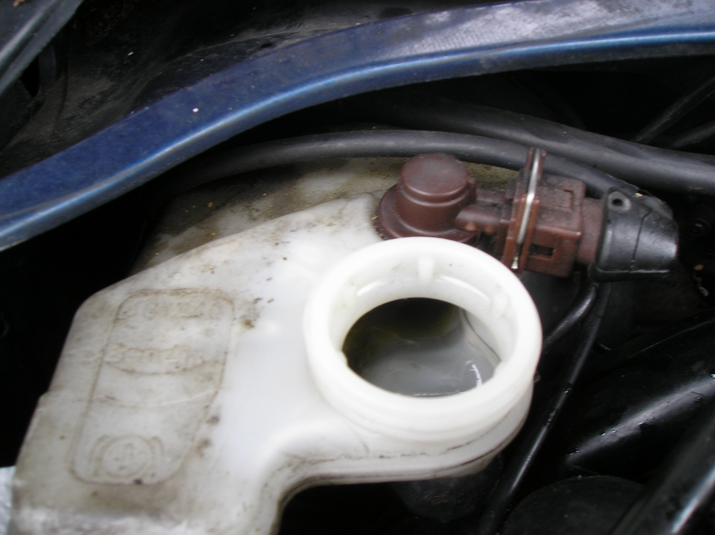

Just wondering if this crap in the brake tank is rubber from worn master cylinder seals?
[Image: P1010032_zps9074637e.jpg]
Am I better off having a bash at refurbishing it or buying a replacement unit!?
Best bet is to drain out all the old fluid put in some new stuff and see if the bits come back again.
Bye Bye D-Turbo
looks like you've just got shit in there from filling it up and knocking the bonnet liner
Yeah where the hell is your fluid strainer? That should never be removed for this exact reason. To try and stop shit getting in there.
Fluid looks a bit manky though. Id suggest a full system flush. Think you would be surprised at the effect it will have!
^^^ as above should be a strainer.
and that fluid needs changing, so just flush it all out Smile
ew, that's manky!
drain out all the old fluid, then flush the system out by pumping some washing up liquid and water through a few times, then put some fresh brake fluid in, that'll sort her out nicely ThumbsUp Smile

Fluid strainer!? Never had one! What do they look like and where could I get one? No, no, I am not trolling :roll: I had flushed 1 litre of fluid through but then I jacked up one side too high to bleed the brakes with the tank too low so air got into the master cylinder and then I didn't have enough fresh fluid left over so had to flush the old stuff back through again Sad Had to get it done before the MOT you see Sad

It's literally just a metal gauze in a plastic ring that sits over/in the filler hole. I'd go to Peugeot and see if they stock them. Can only be pennies.
Perhaps before the flush, either vacuum out (syringe?) or just remove and tip out that reservoir, no point pumping that crap in there through the system.
And a litre of brake fluid costs about a fiver, so no excuses to reuse dirty stuff!
Yeah I'd siringe that all out. Will do some damage if that dirt gets into a calliper.

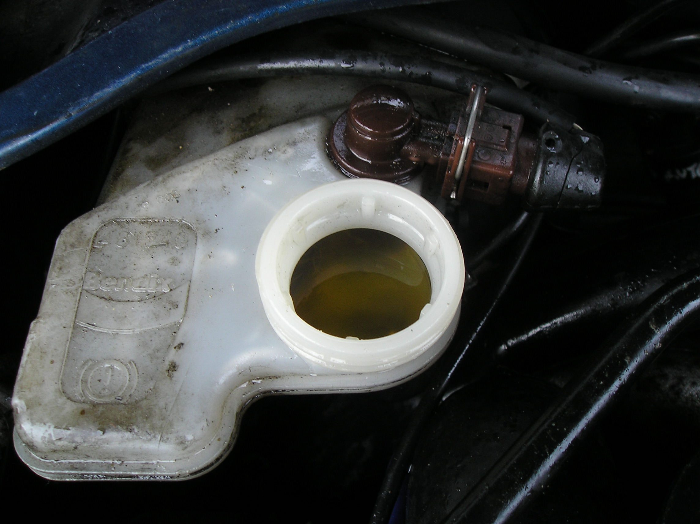

Right, got myself a turkey baster, sucked a good amount of fluid out, but I couldn't see the suspected rubber particles in the reservoir anymore? Hopefully it hasn't gone down and buggered something up.
Anyway, got the reservoir nice and empty as possible, you can just about see the old fluid is still covering the inlet for the master cylinder:

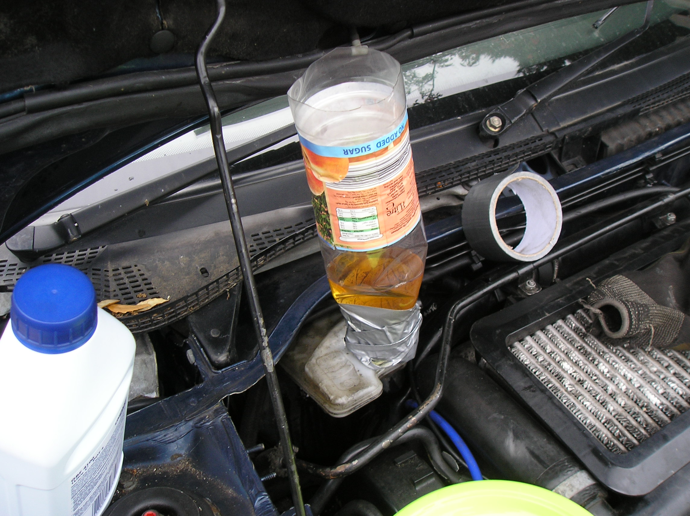

Then I tried gravity bleeding in the same fashion as you would bleed the radiator, but I couldn't get a decent seal, resulted in about half a litre of wasted brake oil!
After bleeding the best part of 2 litres through (allowing for the wastage from my unsuccessful gravity bleeding attempt) I had nice fresh fluid all the way through and a firm pedal, save for a few drops of rain as it had annoyingly decided to start raining on the one day I had free to do the jobAngry

Also, that fluid you topped up with is that dark because it's been sat on a shelf too long and absorbed moisture, fresh fluid should be a pale translucent yellow that's almost clear. (Or blue, if you're using ATE Big Grin )
yeah I thought it was dark ...but I use 5.1 and its almost clear compared to 4
They should be the same, that just means the '4 has been on a shelf longer somewhere. Or left open.
(25-08-2013, 10:24 PM)Rippthrough Wrote: They should be the same, that just means the '4 has been on a shelf longer somewhere. Or left open.
Spot on.
That fluid was brand new bought and opened that day.
