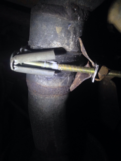

Bought Midnightclubs Sportex system off him the other day, I got too excited and put it on that same night along with a fail DIY exhaust clamp. Then put my old one back on as I want a centre silencer for it And this is the latest photo of the 6. It was taken near Combe Martin, pretty happy with the results actually.
26-08-2013, 11:19 AM
Hell that clamps worse than I thought! Eurocarparts quality that is!
Looking awesome though apart from the exhaust ![]() ![]() Midnightclub Wrote:All the cool kids have ph 2 Nile 6's!
