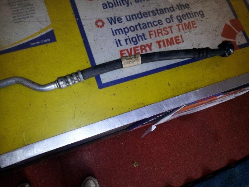

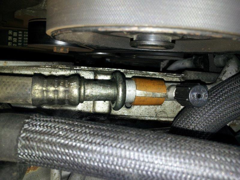

To give you some help this was my experience, I recently repaired mine after taking it for a regas at Kwikfit only to find it stopped working after 2 weeks they told me if I get it repaired they would regas it again for free.
I got a local fella to do leak test for free and it was found to be leaking from long pipe on the P clip, condensor and from the seals on the long pipe after the schrader valve 3 and 9.
[Image: HJ67P27A.gif]
He wanted over £300 to replace the condenser and £120 to replace all the pipes in the engine bay with rubber and reroute them around the battery tray, I declined.
There are various companys on the net that will do weld repairs on these pipes for around £25 a weld. A local company to me wanted £140 to replace the sections with ally pipe and regas and test.

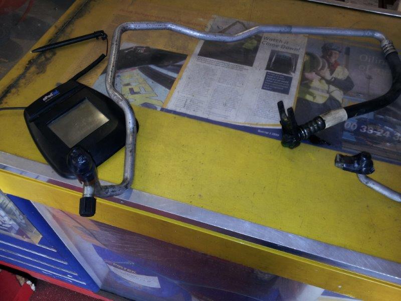

Instead I took the two bottom pipes to Pirtek (the long and the short one 3 and 4) and had the sections with the p clips replaced with rubber for £77. Peugeot wanted £190 for both bottom pipes and trade discount would only be 5 to 10 % on these items, Part numbers: Long 6460-40 short 6457-WT. It should be noted that the connections at the end of these pipes are unique so there is no off the shelf non-oem pipes to be found.
I bought a new condensor from GSF for £53 using code "offer10" it turned out to be Valeo item. http://www.gsfcarparts.com/260pc0130
While you are at it you will also need to replace the receiver drier this is the one I bought and it fitted well. http://www.ebay.co.uk/itm/390590662773?s...1439.l2649
I replaced all the seals of the bits that I removed this kit seemed to cover all that I needed. http://www.ebay.co.uk/itm/310354569645?s...1439.l2649
A spring clip tool is required to remove the pipes the long one and another from the condensor 2 and 3. I made my own from some 25mm and 20mm copper pipe I had which used to push back the garter spring to remove the pipe.
Total cost was around £210 to fix including the original cost off the Kwikfit regas.
You could just repair the double pipe but you might find that it will only be a matter of time before either or both the two bottom pipes and the condenser will also start to leak as well.

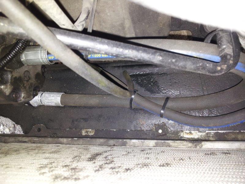

Got mine done in Leyton in London dropped them off and collected the next day because they needed to order in some connections otherwise they can do them while you wait.
I asked them to remove the corroded lower portions of the pipes and replace them with rubber they decided how it was best do do it.
I would advise you to personally go in to see them and discuss how they are going to carry out the repair and if you are confident on what you hear and happy with the quote then go for it.
If it was a single hole and the pipe and was otherwise in a good condition I would have had it welded. These guys charge £20 per weld http://www.robertsfabrications.co.uk/air...epair.html

(01-08-2013, 05:11 PM)Ican Wrote: Got mine done in Leyton in London dropped them off and collected the next day because they needed to order in some connections otherwise they can do them while you wait.

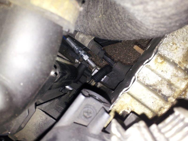

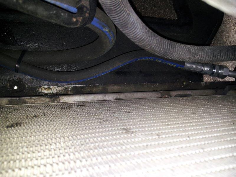

Got pics of your replaced pipework? How much hassle was it to remove them?
[Image: wallye-gtd.JPG?raw=1]
HDi Owner for 200k/9 years
(04-08-2013, 08:23 AM)C2K Wrote: Got pics of your replaced pipework? How much hassle was it to remove them?
I you need to jack it up get, remove the undertray, front bumper, headlights and unbolt the slam panel. I disconnected the pipes from the compressor and the receiver drier and the upper springlock coupler.
With the slam panel pulled back there is a big enough gap to lift the condenser out with two attached pipes.
Refitting a new condenser and pipes will take a lot longer due to adjusting pipes to fit properly. Also you may find the condenser housing may need modding to get it to fit and also the lower pipe connection which I had to bend further than I liked.
Not the tidiest way but certainly looks like it will work! Might have to take my last pipe to these guys payday!
