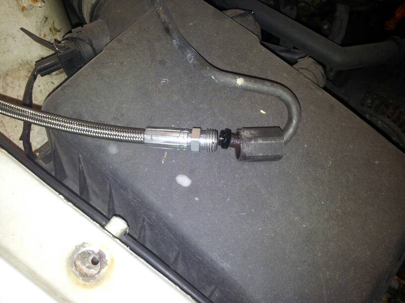

got my braided oil line today for the td04 off of Jenkosowls

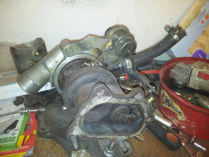

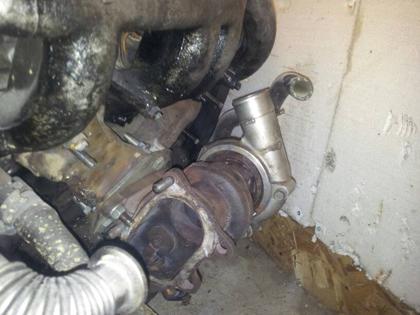

Got the turbo mounted to the manifold have made up a bracket for the actuator hopefully will get the engine out of the 205 this week and start to tidy up the engine bay and start to get the ball rolling.
Anyway pics of the turbo
I also going got this from work hopefully it will work as a manual boost controller
#34
Are you sure that actuator wont catch on the steering Uj ? il get some photos of mine but i think it needs to be further round under the turbo
#35
Im not to sure tbh I just built it up and didnt think of that lol. I still need to get the engine out lol

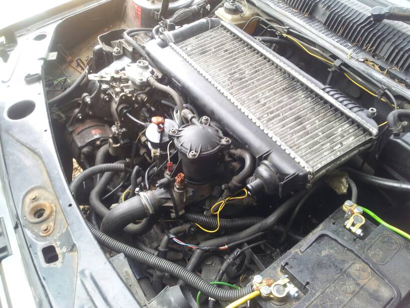

Right bit of a big update I have now got the engine out of the 205 heres a pic of how we started this morning

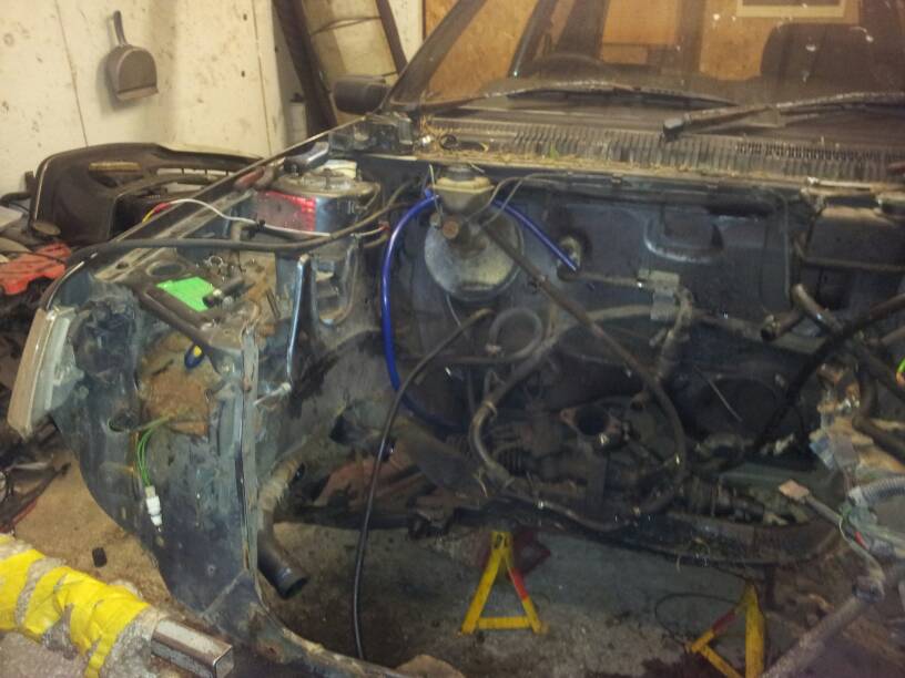

A few hours later the engine bay looked like this

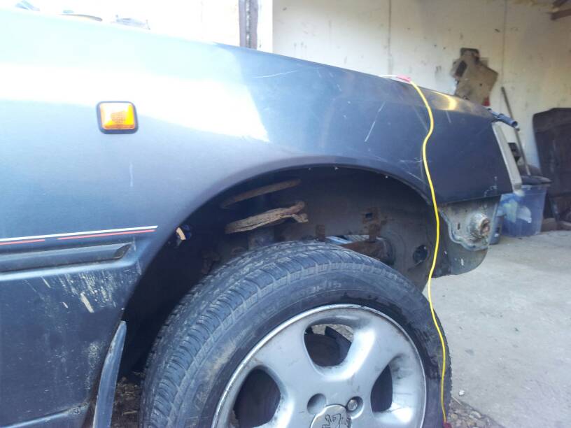

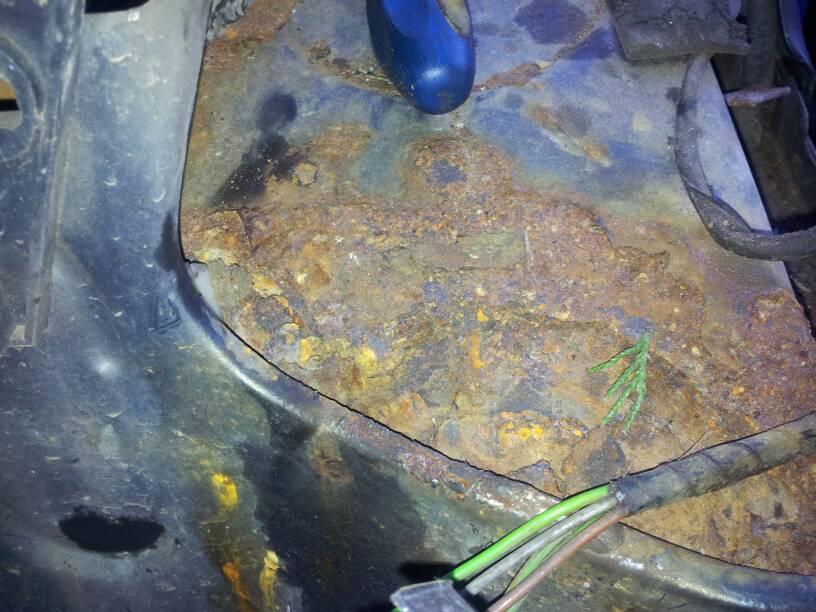

The car needs a bit of welding behind the drivers headlight just a little bit crispy.

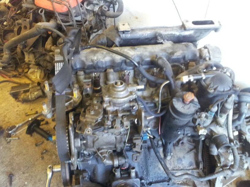

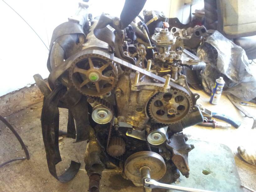

So then I took the bosch pump off the 1.8 and then put it on the 1.9 with a new cambelt kit

I also have put a new valeo clutch in and the engine is now in the car for a trial fit with the td04 the actuator does hit the steering UJ as someone has mentioned so will have to come back out and look at that but all in all not a bad day would of got more pics but my phone diedBig Grin

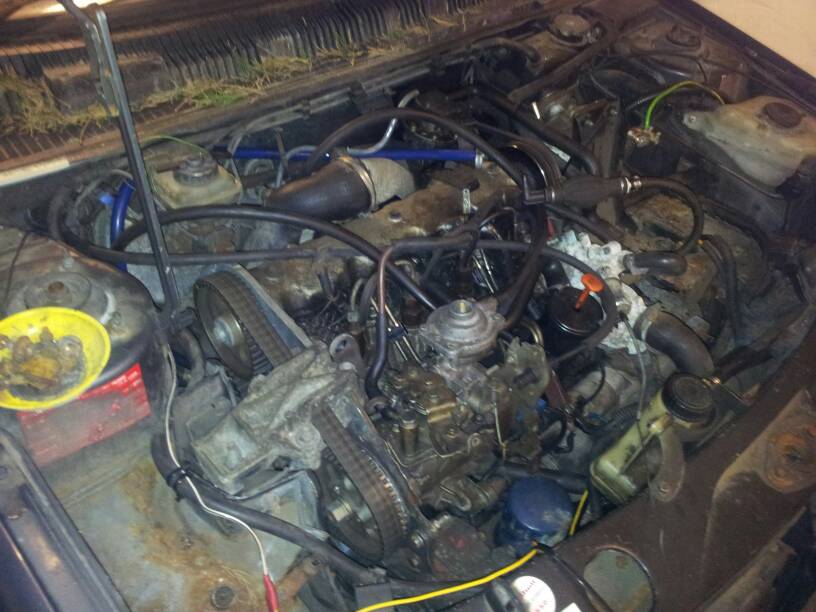

Bit of an update on this I have now got the engine in

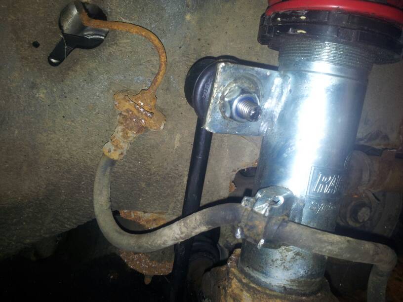

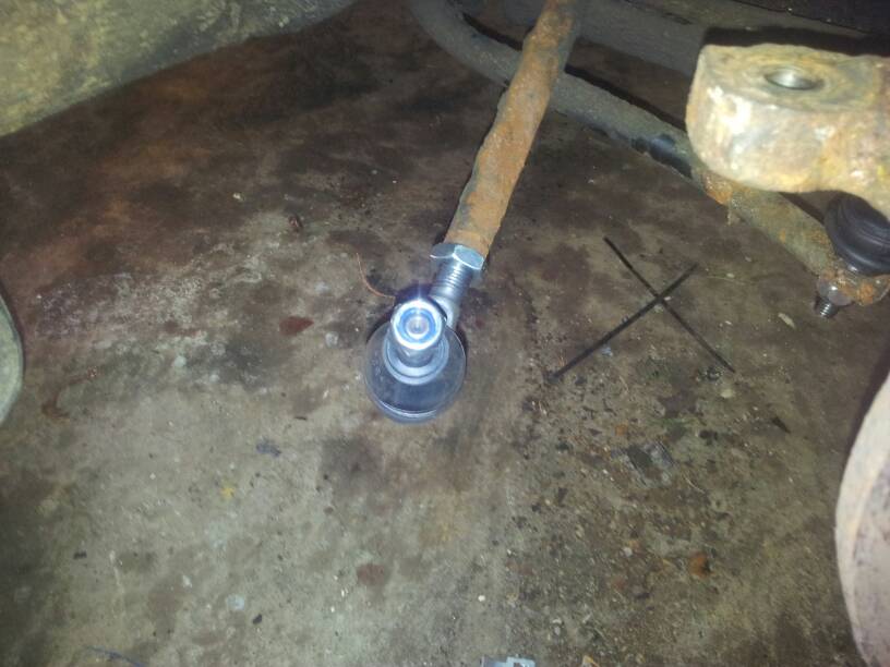

I have fired it up started pretty much first time with no issues realy I have also sorted the clutch cable as I am running a 1.9 box I have got my coilovers, droplinks and track rod ends on aswell
I have had a quick spin in it and it dosent seem to have any go when it should be coming on boost it was like that with the 1.8 with the bosch pump so I am certain it is the pump thats causing this can anyone give me any ideas what this could be?

i'm right in thinking the coilies for the 205 are the same fitment as the 306 coilies (except the brak line holder ofcourse)

(24-04-2013, 11:04 AM)ginge191 Wrote: i'm right in thinking the coilies for the 205 are the same fitment as the 306 coilies (except the brak line holder ofcourse)
Im not to sure tbh they do look the same though and my brake lines fit in the holder aswell Tongue

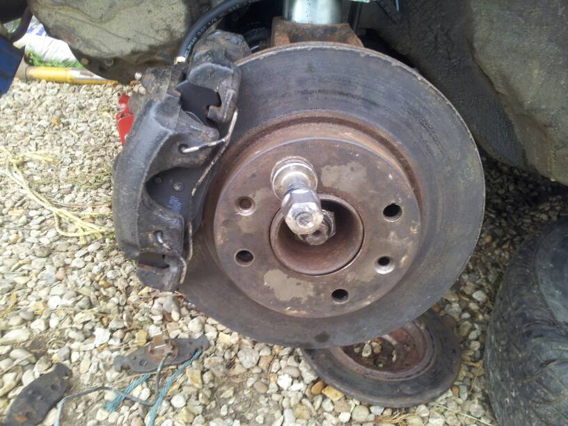

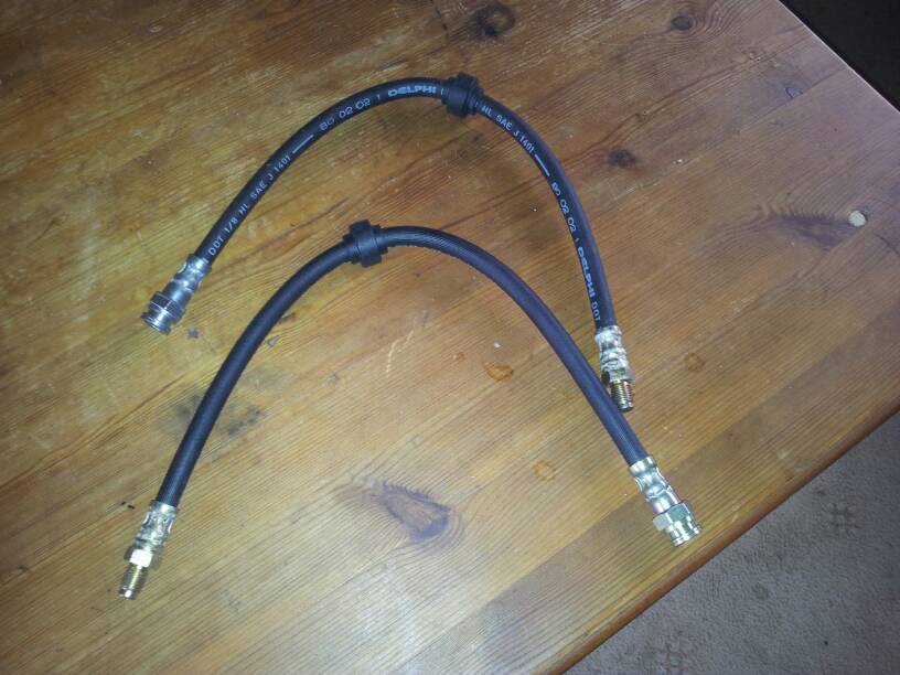

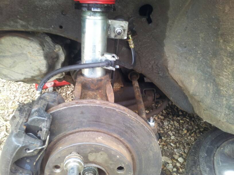

Right spent a few days on this and have got a little bit more done. I got hold of a new pump and put that on and has solved all the boost issues I was having so boosts well nowSmile. Have put the loweres axle on from the 205 cti I had all new axle bushes, brake lines and hoses all the way through and also some 306 247mm calipers and discs I had kicking about atleast there vented lol.
Also I was having issues with gear linkages I kept the 306 selecter on the gearbox when I put the engine in what a bastard it is to get out in the bay lol.

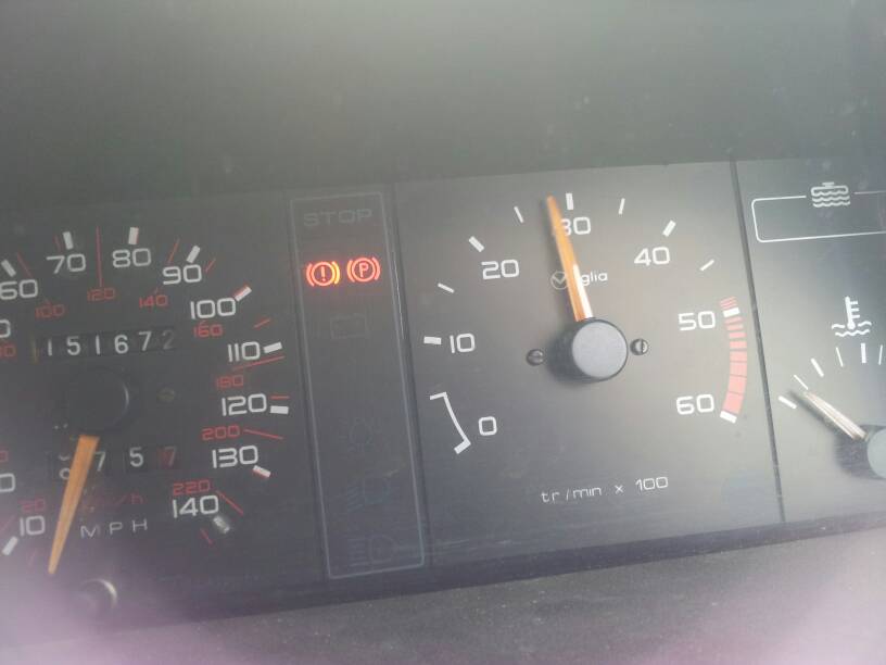

I tested the rev counter sensor today and found out that didnt work so I got a replacement and wired that up and now I have a working rev counter
Gonna put the front end on tomorrow and start to tidy things up in the engine bay and put the cam belt cover on then all I have to do is make up a new exhaust and I think its nearly there for an mot once I get some new tures or wheels lol

Jealous of the rev counter! Also with my TD04 had to "modify" the arm that links to the gear linkages as it hit the downpipe.
They're different with the drop links too iirc

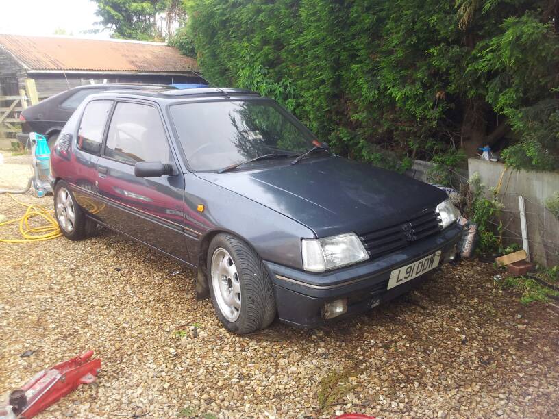

I started to tidy the engine bay today cable tied a few pipes/cables etc in place put the cambelt cover on etc etc
Then decided to put the front end and put the bonnet on first time in months it actually looks like a car again
Then I gave it a wash aswell as the s16
And a few stickers aswell
