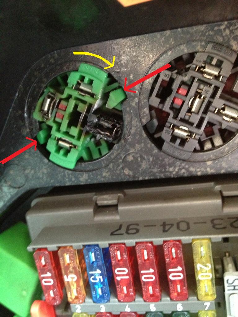

Here is the fuse box, it's the brown one on the top left
[Image: 23C636EA-0813-44C8-8073-4E0541F3BD5C-992...C87E8A.jpg]

(15-04-2013, 10:21 AM)cully Wrote: Looks like a relay!
Pull it out and check the base terminals of the rely and the socket for burned connections
Cully the relay an plug are fried like a chippy !!! Help !!
Can I change the plug or..?
[Image: 4CC4A1CA-1C2A-4DBD-9E52-39804953D5DC-642...956214.jpg]
[Image: 54004DE5-8902-4BAA-A100-6E4D7DFD5D46-642...4A0751.jpg]

clean up the terminals pinch the connectors tighter fingers crossed it fixes it! (bodge)
or
replace the green plug
go to the scrappy cut one out of another car and crimp into yours or cut yours out
or
cut you green socket off and crimp connectors that push onto the relay Wink
to remove the green socket push green tabs (red arrows) and twist (yellow) clockwise and push out the back of the board

yes i do have some relays but i need them for kayleys car
and its normaly loose/bad connections that cause burning like that over time
its quite common on older cars to find this on removable plugs and relays supplying higher current items
oh and green sockets normaly have green relays

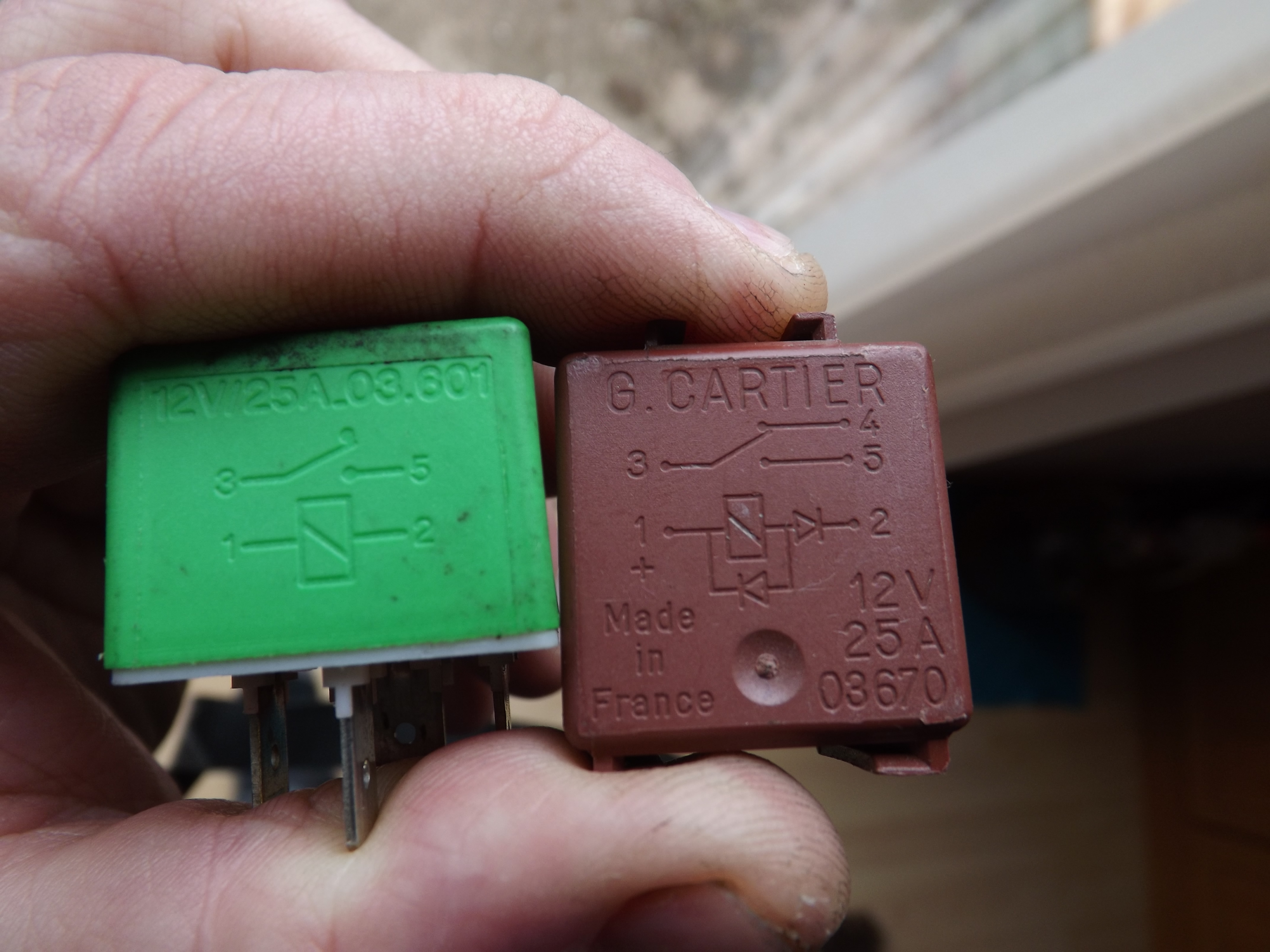

This is what's in the top of the brown relay
[Image: A811F088-1CFA-4DF3-9282-8AC0DC96AD9E-642...DC738E.jpg]

there are two versions of the green relay 5pin(2pole switch) 4pin (1pole switch)
both fit the same socket
the brown relay is the same as the green 5pin relay except its polarised +/- coil and has a transient spike suppressor to stop inductive spikes killing electronic controlling systems

So the brown relay is the right one then, didn't want to put the wrong one back in again if that was the case Smile

I have received 2 green relays in the post today, they are 4 pin and not 5 pin so wrong.. still looking for 5 pin relay from a ph2 with aircon - I guess they are brown and not green ?

Just had a look at a Haynes manual and pre 97 car is a 5 pin relay, post 97 is 4 pin but MYA is 97 (on the change from ph1 to ph2) ...so...
if the wrong relay is fitted will it do electrical damage or will the fan just not work?
