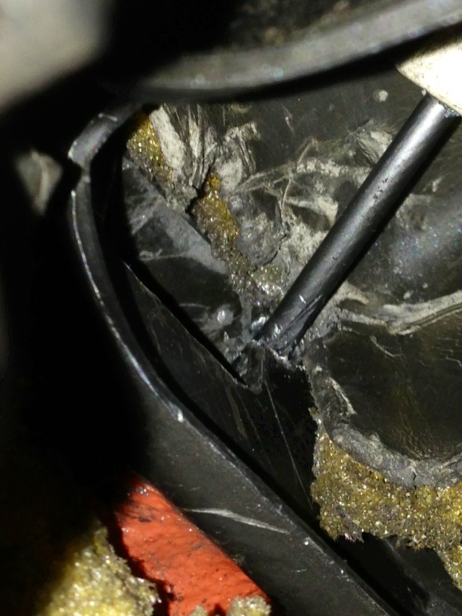

    i had this problem on mine from where some knob had fitted it last and not routed it properly.... I had the same thing low biting point and then couldnt get it in gear..... The cable as you can see had cut its own groove in the bulk head and made the aduster go to its max position because of the extra resistance it need...
