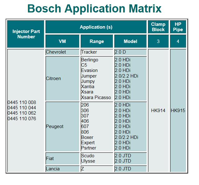

heres a list of compatible injectors and where to find them
might come in handy to some
there is also a pdf file for many other Bosch CR injectors across many makes good for cross referencing

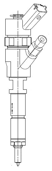

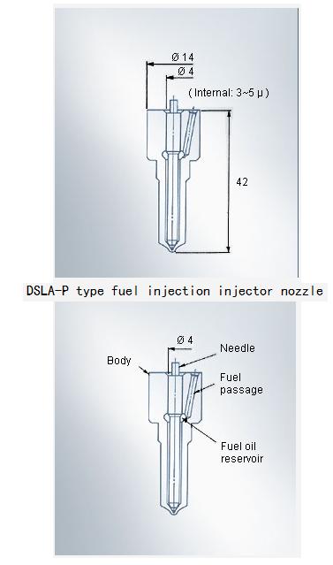

Bosch P/N MFR number Type Nozzle number
0 445 110 008 198058 CR/IPS17/ZEREW10S 0 433 175 196 / DSLA142P795
0 445 110 044 96375360 CR/IPS17/ZEREK10S 0 433 175 196 / DSLA142P795
0 445 110 062 96400887 CR/IPS17/ZEREK10S 0 433 175 281 / DSLA142P988+
0 445 110 076 198084 CR/IPS17/ZEREK10S 0 433 175 281 / DSLA142P988+
The "DSLA" means that the nozzle orifice is cut into the needle seating area.
The "P" is the needle type that is in the nozzle- a 4mm diameter needle,
the "142" is the spray angle of the orifices.
The last number is not the orifice size, it's just the name or mfr sequene code
specifications
adapted to the engine version, for example: 5 holes, 0.16 mm in diameter or 5 X 0.20 or 6 X
0.15
i have not been able to find any info on Hole diameter other than this but ive only been able to find 2 different fitted nozzle codes
