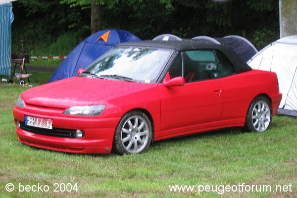

Everything started on 11th July 2002 when I bought my second 306.
It looked like this:
![[Image: QxFPAshi.jpg]](http://www.directupload.net/images/user/14132/QxFPAshi.jpg)
and I made my first plans of changing small details...

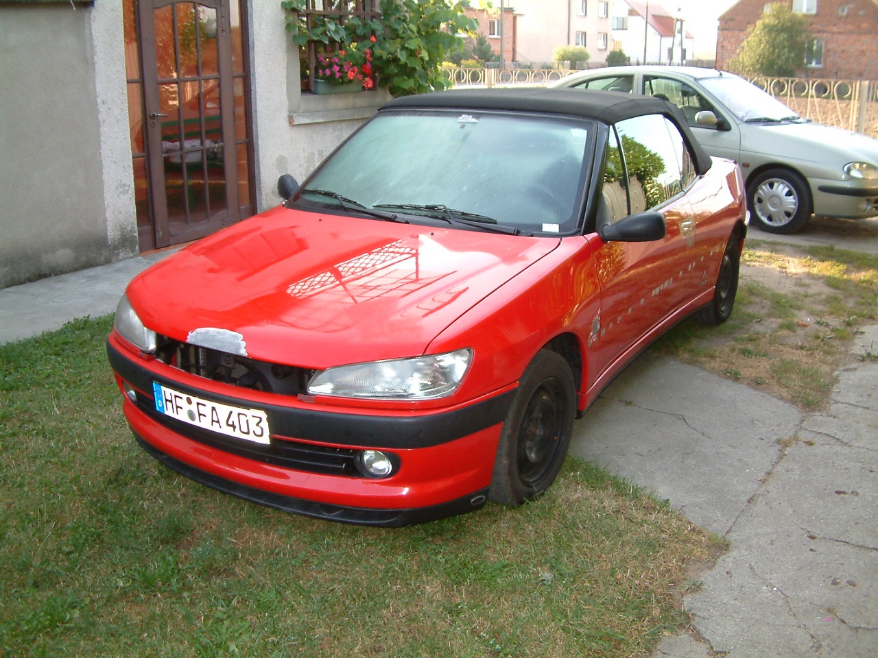

Specs when I bought it:

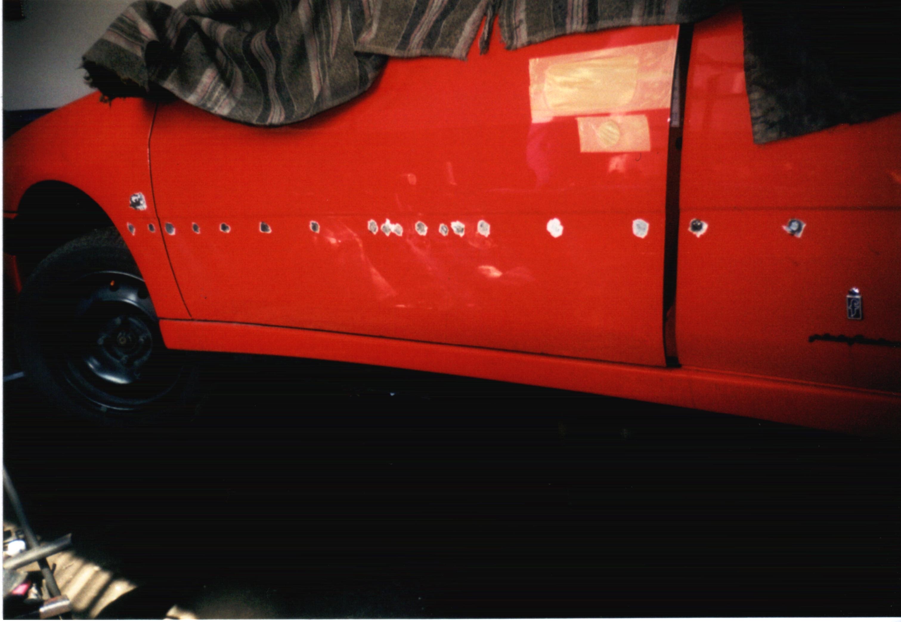

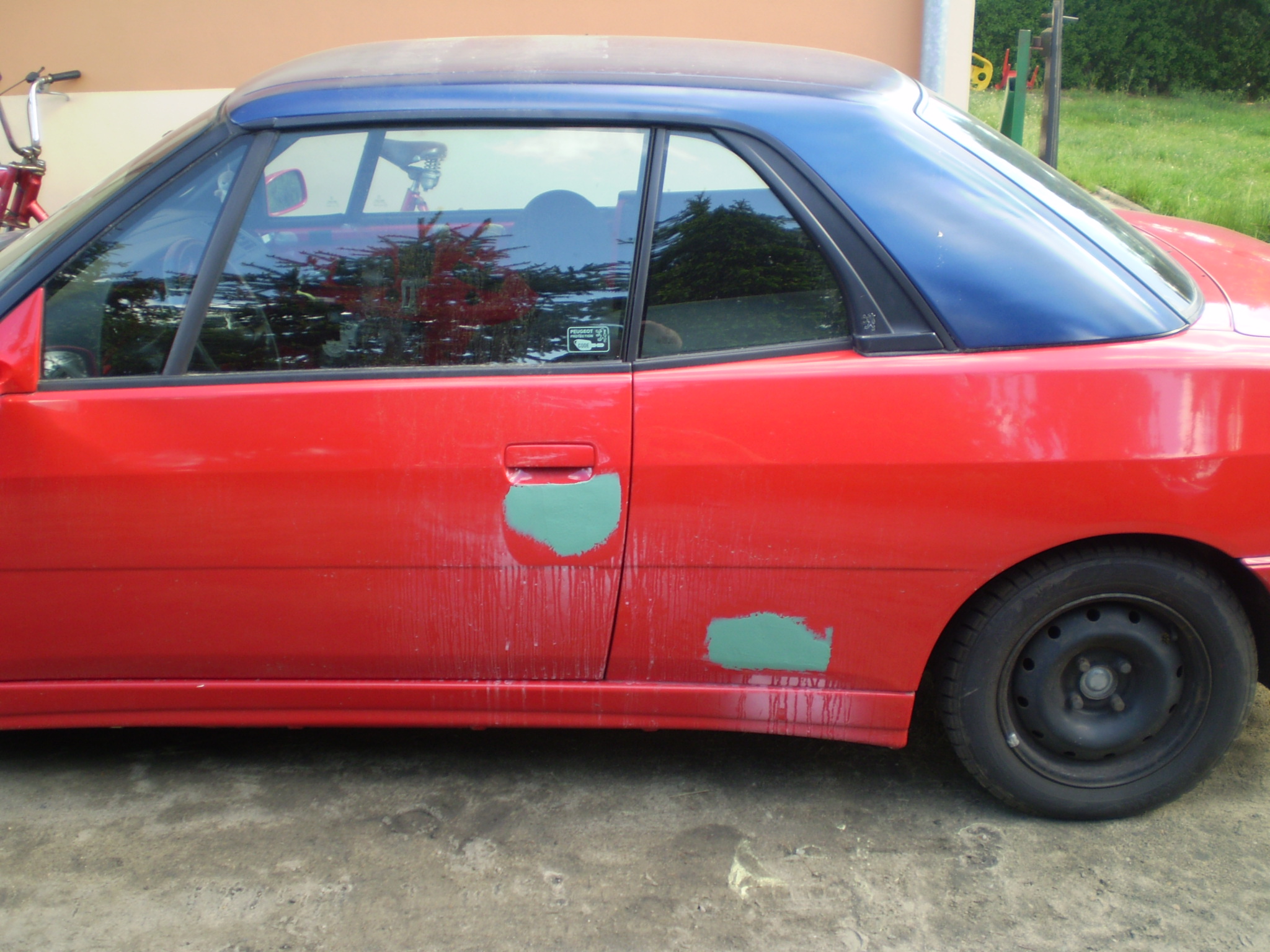

Engine: -1,6l TU5J4 engine with 72.000km -247mm Breaks at front and drums at rear Exterior: - Typical phase2 look with H4 headlights, quite shabby with marks and dents all round. - steel wheels Interior: - fabric seats - standard heating First plans were to - debadge the bonnet and boot - refresh the paint job - get clear phase3 lights and fogs - get a set of alloy wheels Stage ONE: Lot of welding

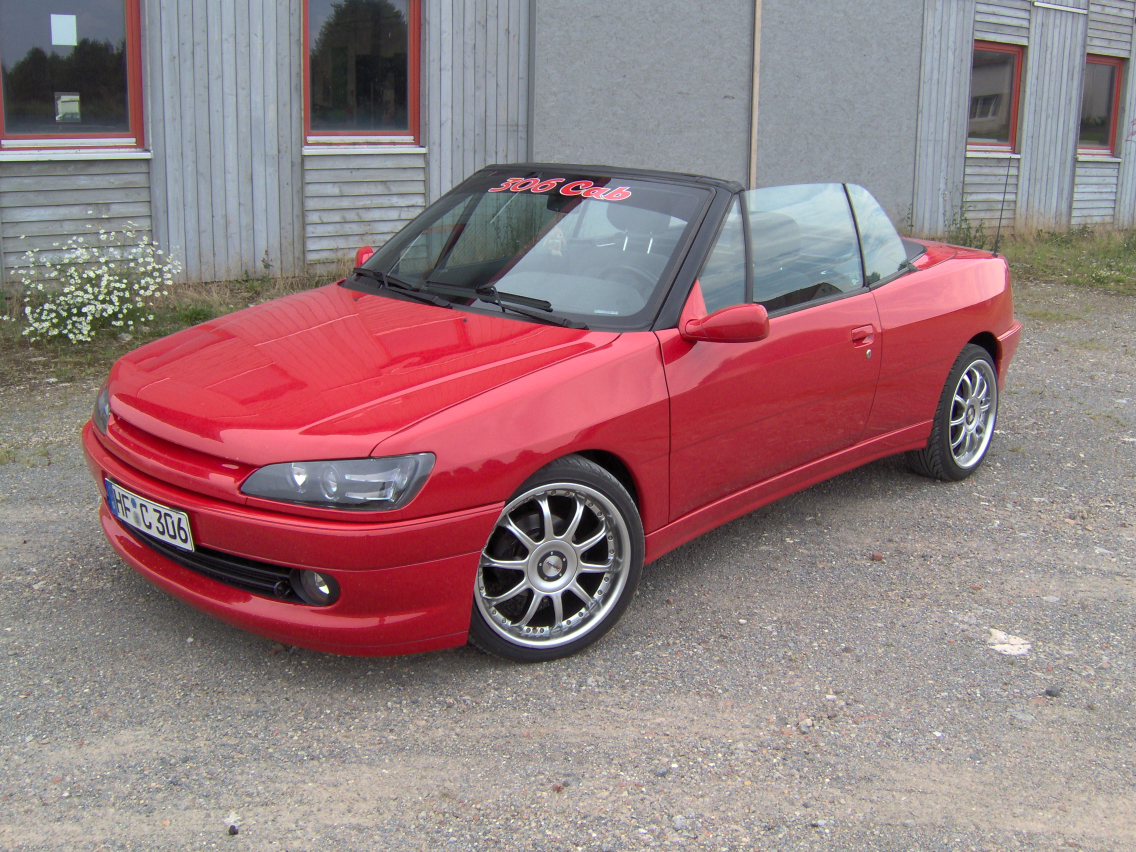

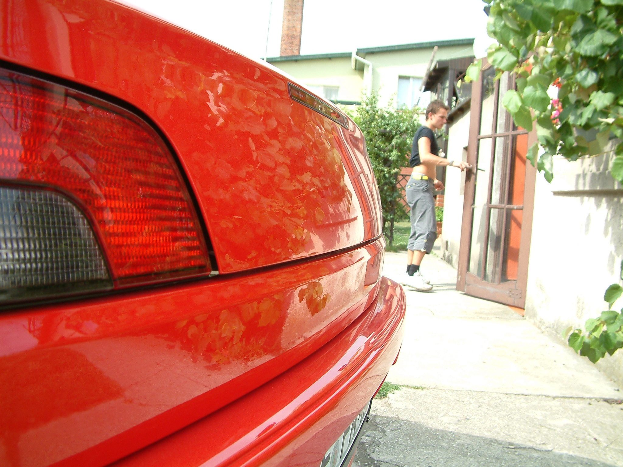

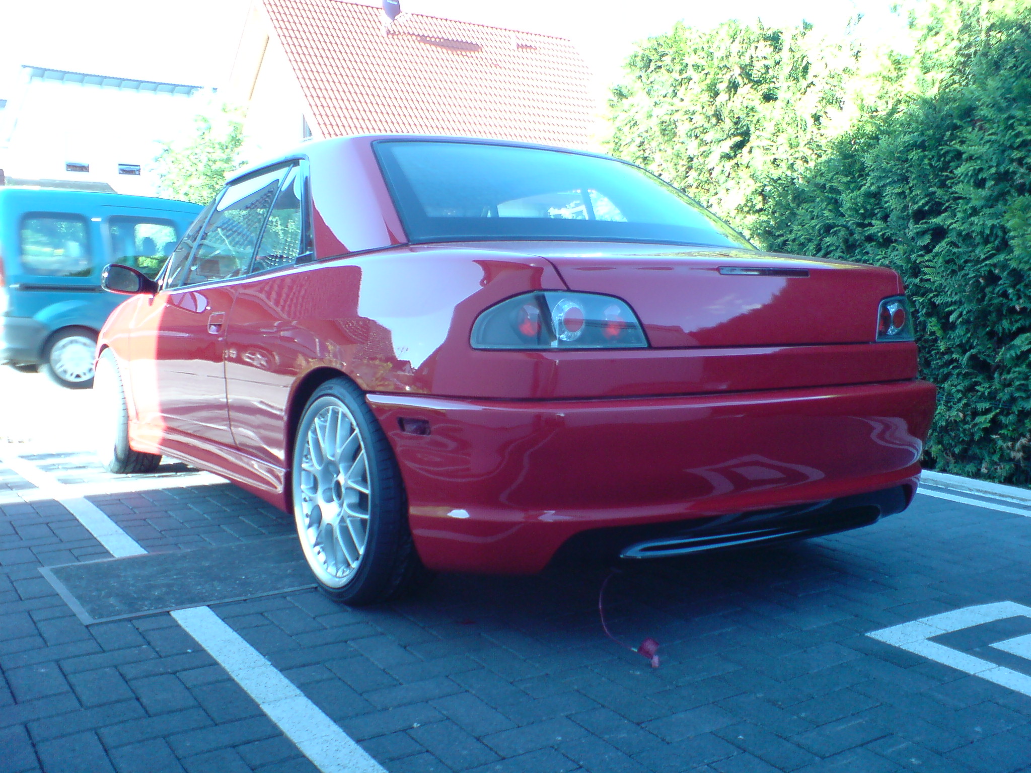

After paint job

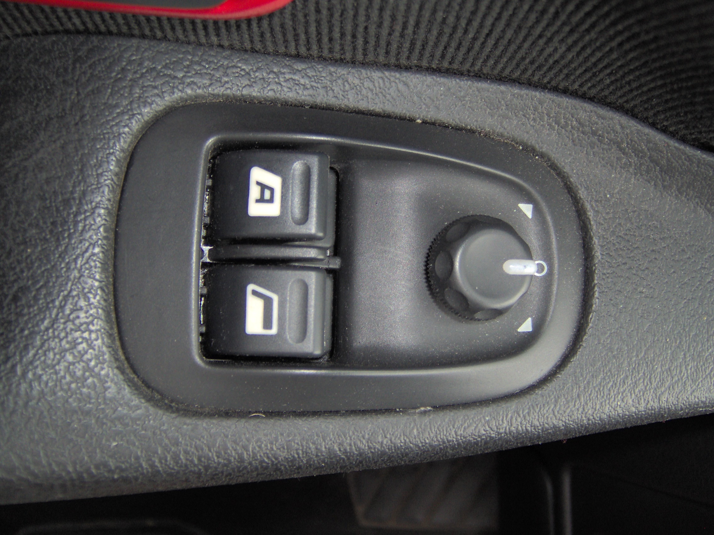

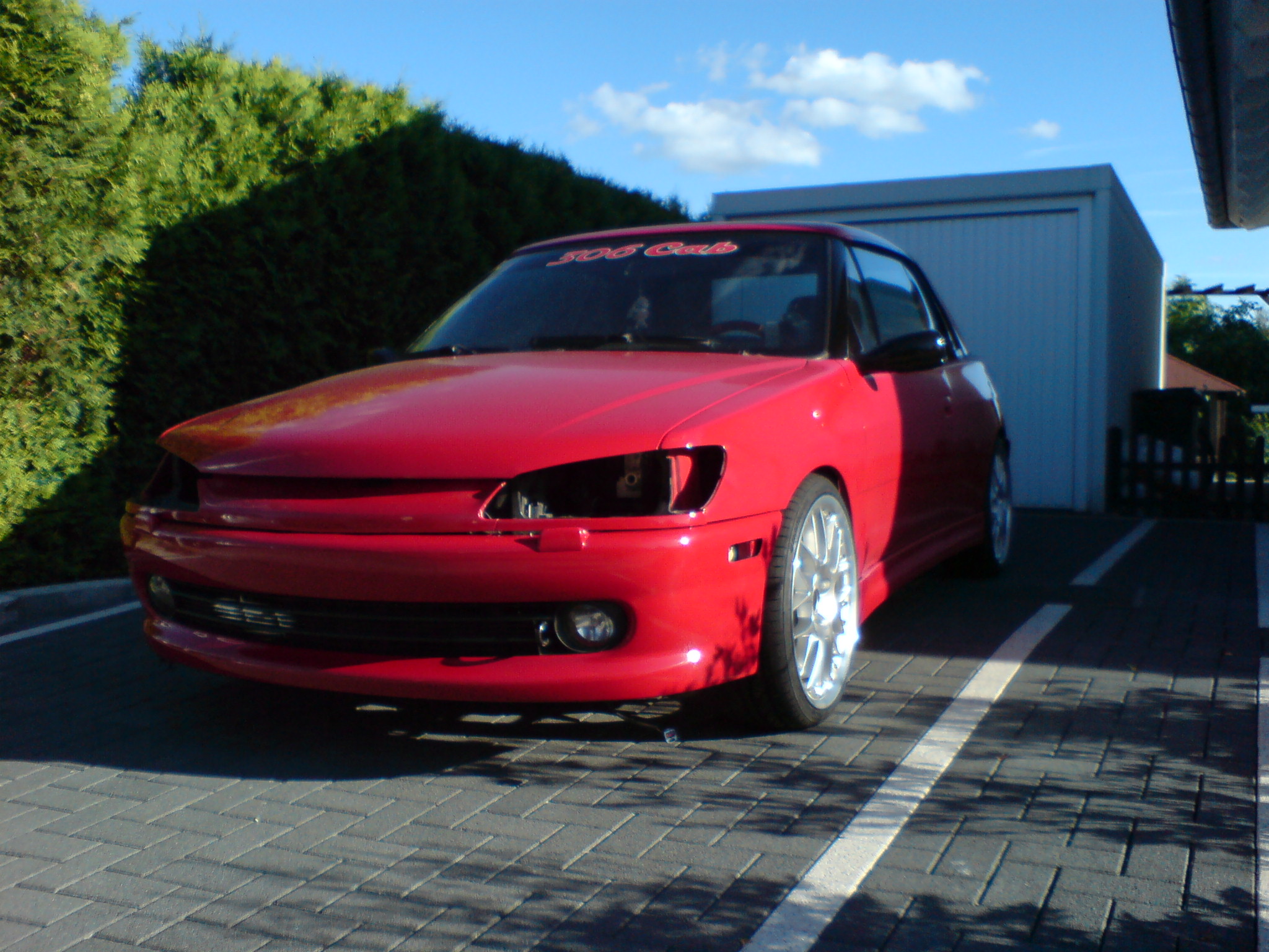

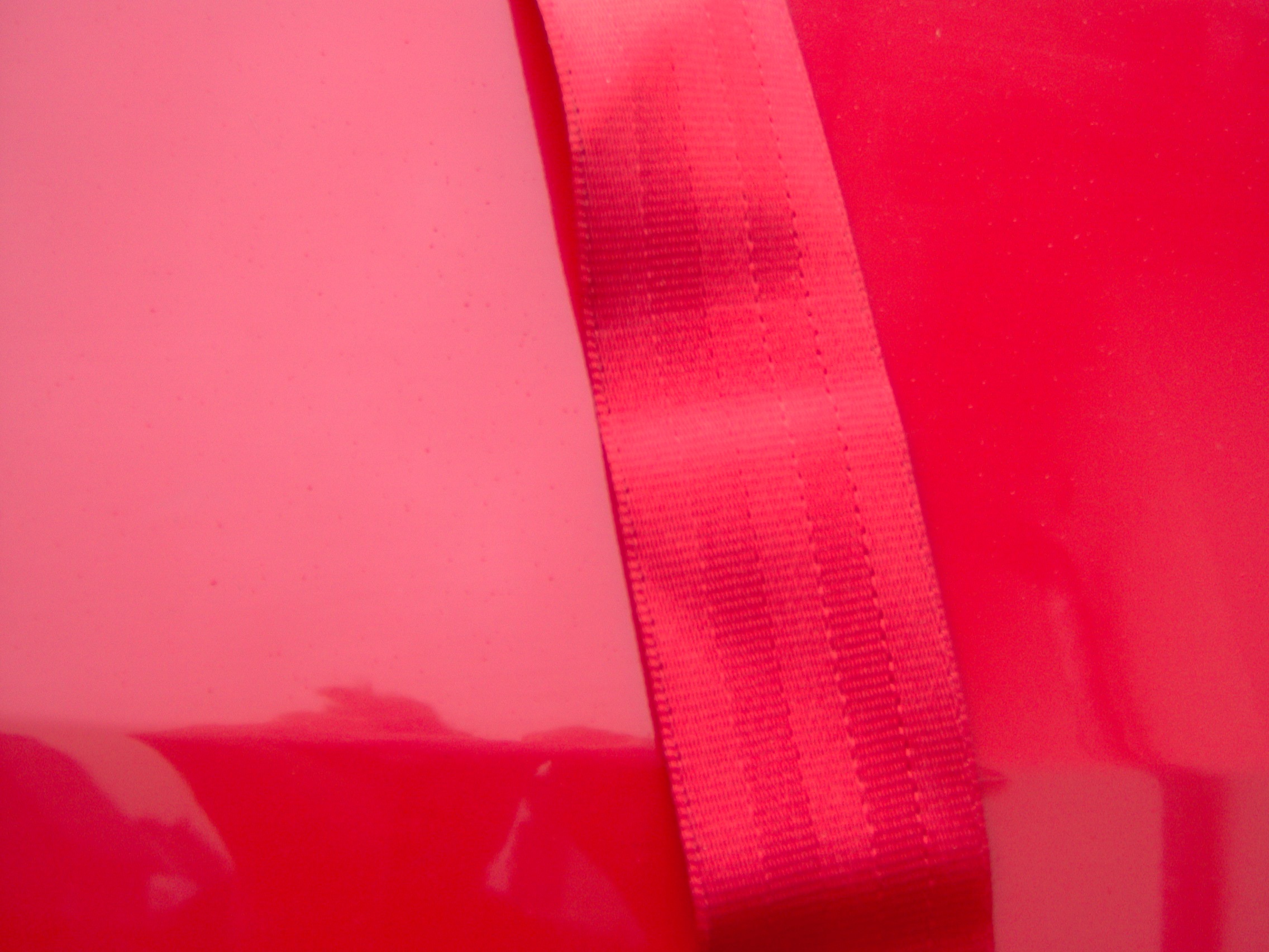

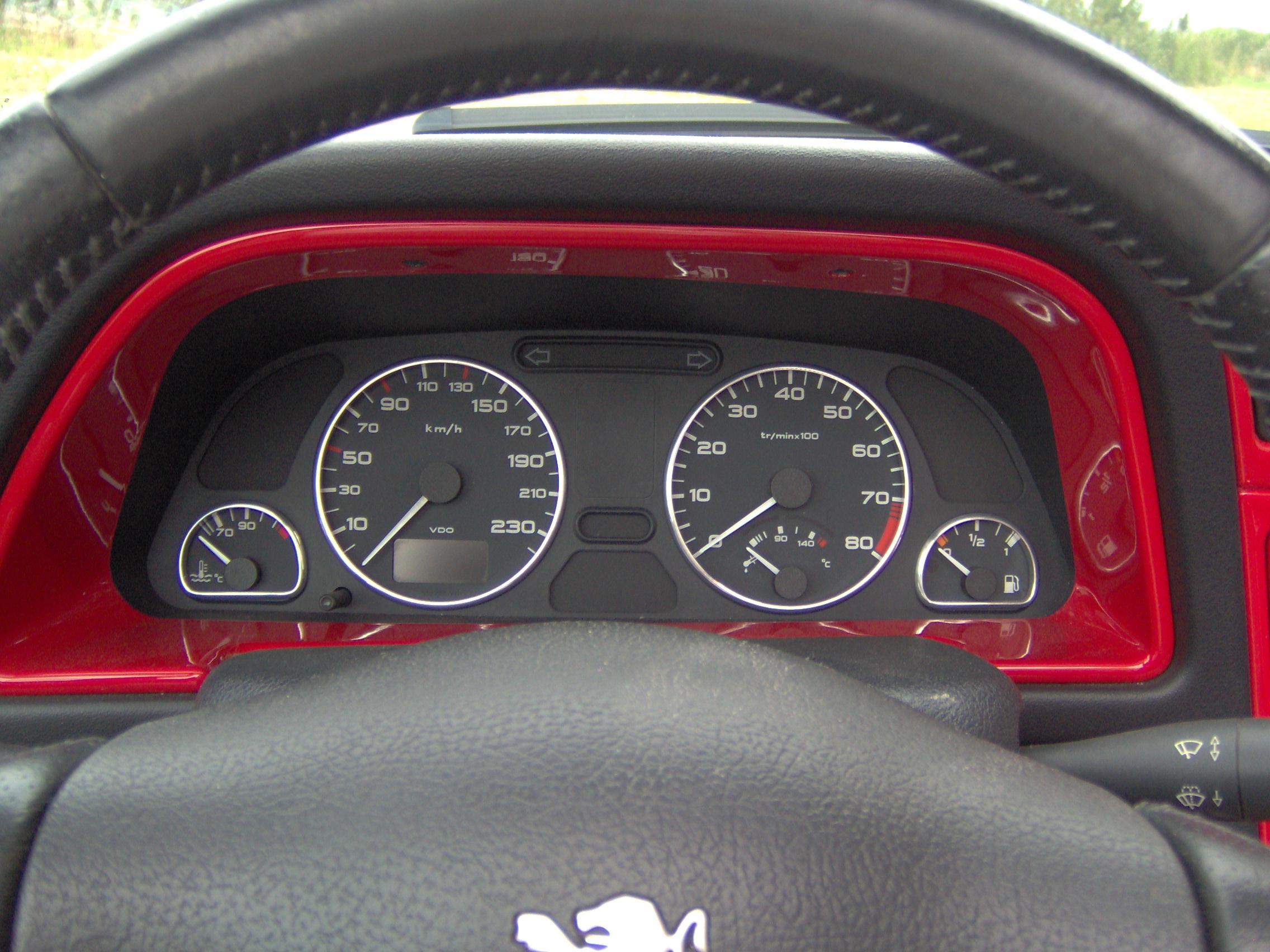

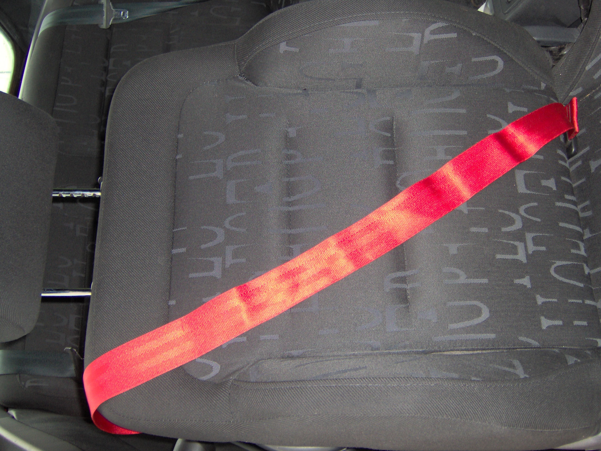

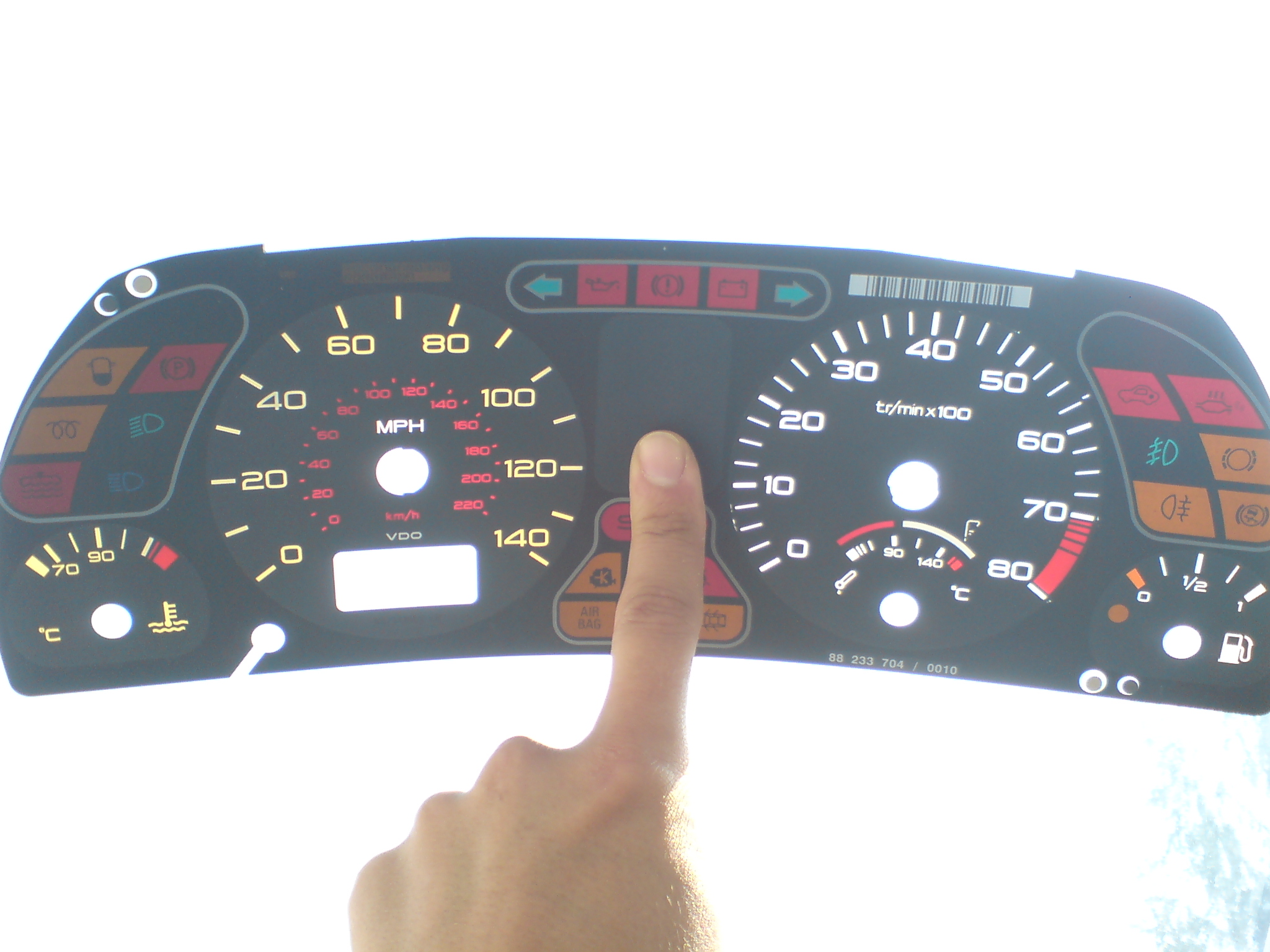

Ignore the strange looking fellow in the background ![]() (08-01-2013, 12:39 PM)ozonehostile Wrote: Just noticed its left hand drive, where you based mate? I am from sunny Germany *joke* but nevertheless I enjoy the days with no rain and whenever it is dry, the roof is open ![]() Finished bodywork with 6,5x16" Nimrods on Stage TWO: (some work on the interior) Automatic window switch from phase3 Color coded seat belts from a vw golf 4 Jibi edition Phase3 fabric interior Painted dash-facia with self made knobs for heater Phase3 speedo with 206GT steering wheel
Stage THREE: new wheels
Fitted 7,5x17" team dynamics diablo wheels with 205/40/17 tires and new lights Clear rear lights

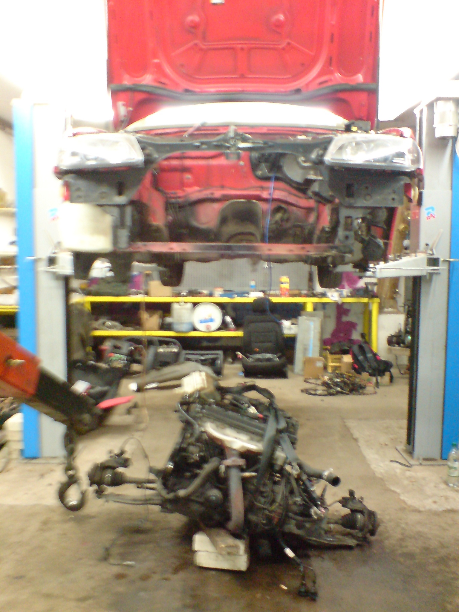

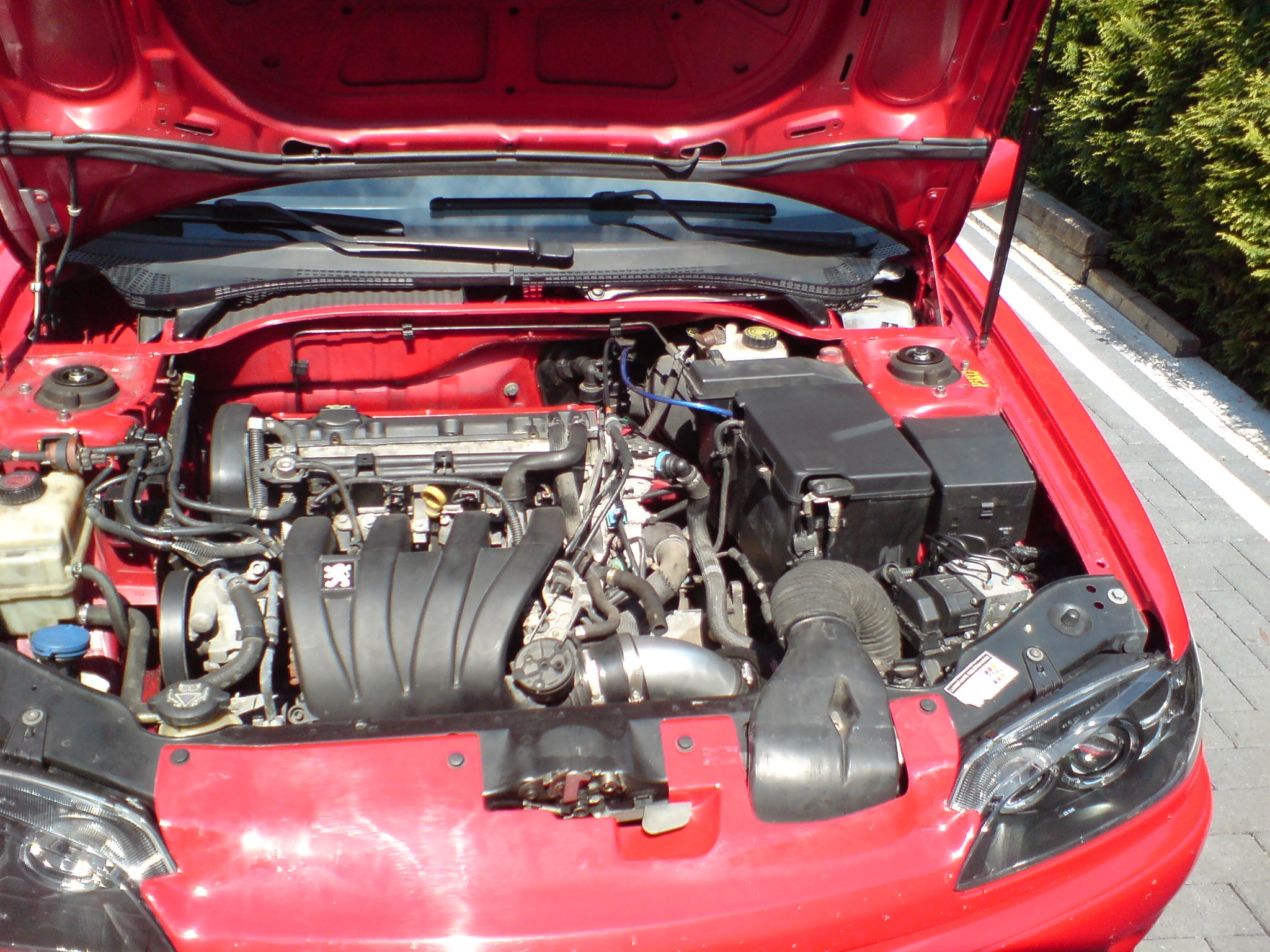

Stage FOUR: new engine
![]() Out with the old one 1,8l 16v LFY XU7JP4 inside ![]()
09-01-2013, 03:54 PM
That's a very late engine with the strange anti-polution device next to the crank case breather on the head. I never understood what it did or how it worked on mine!
Yes, it was an engine of a 2002 model with only 42k km down

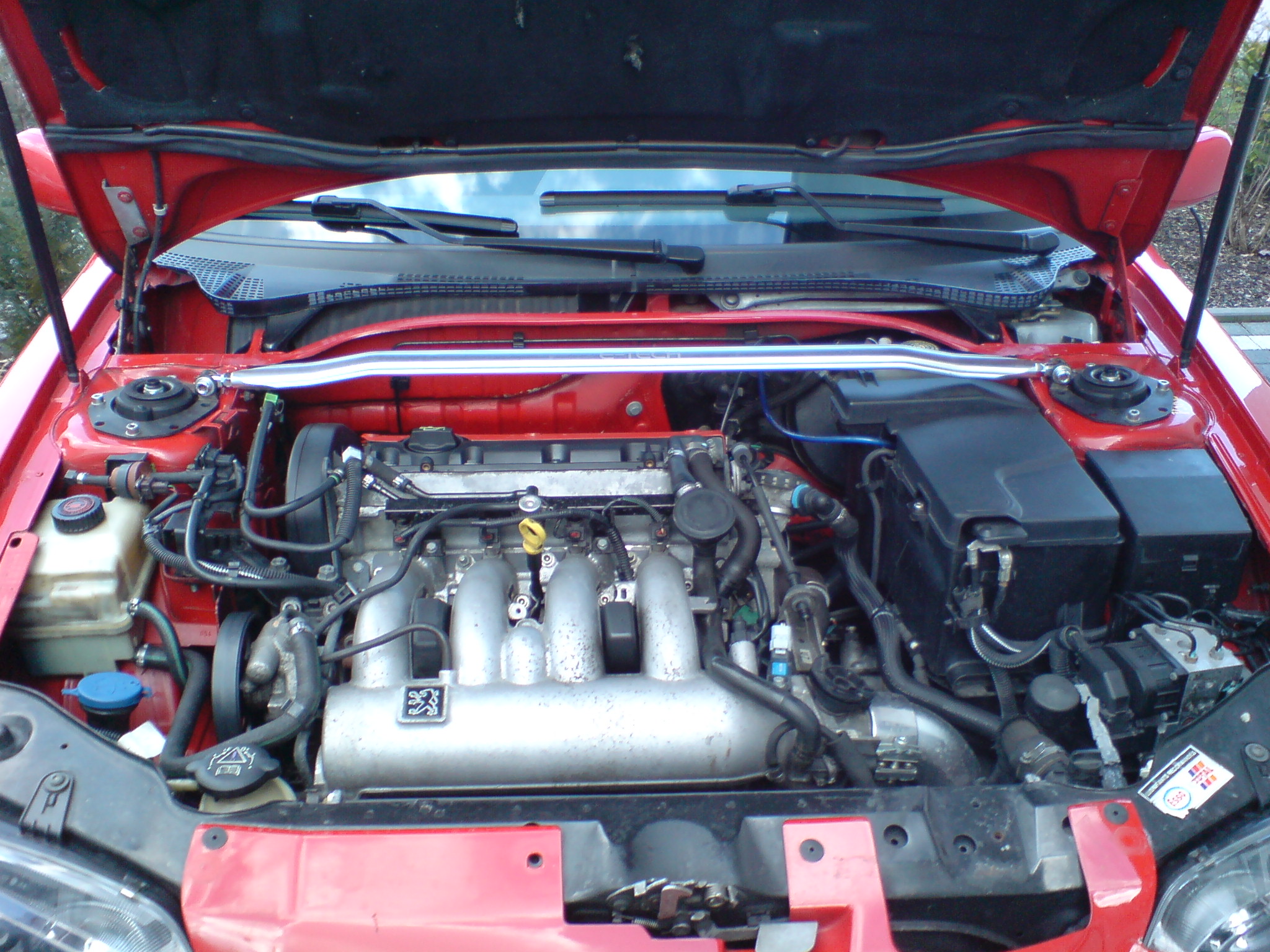

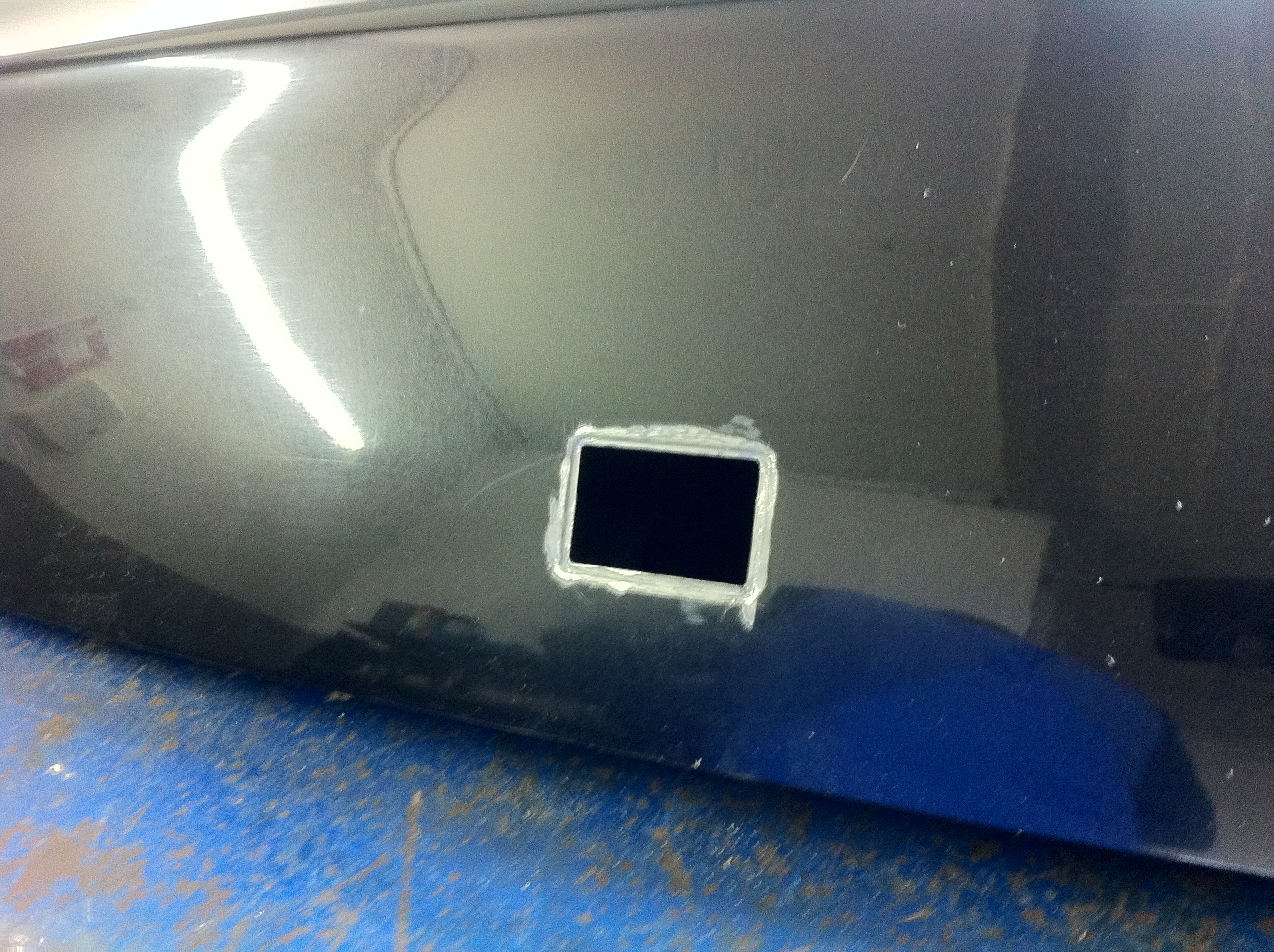

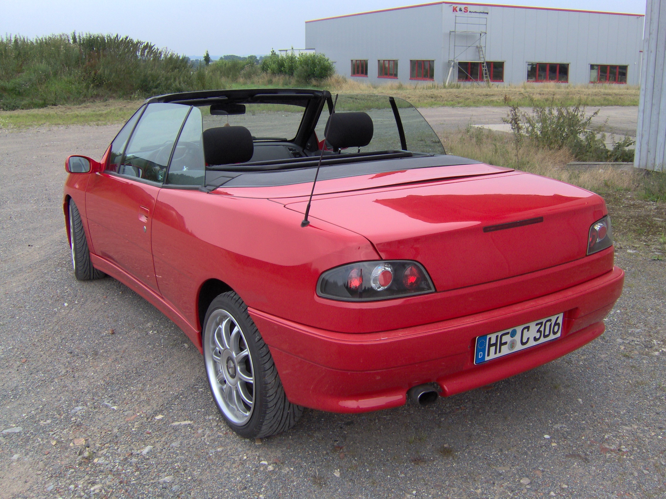

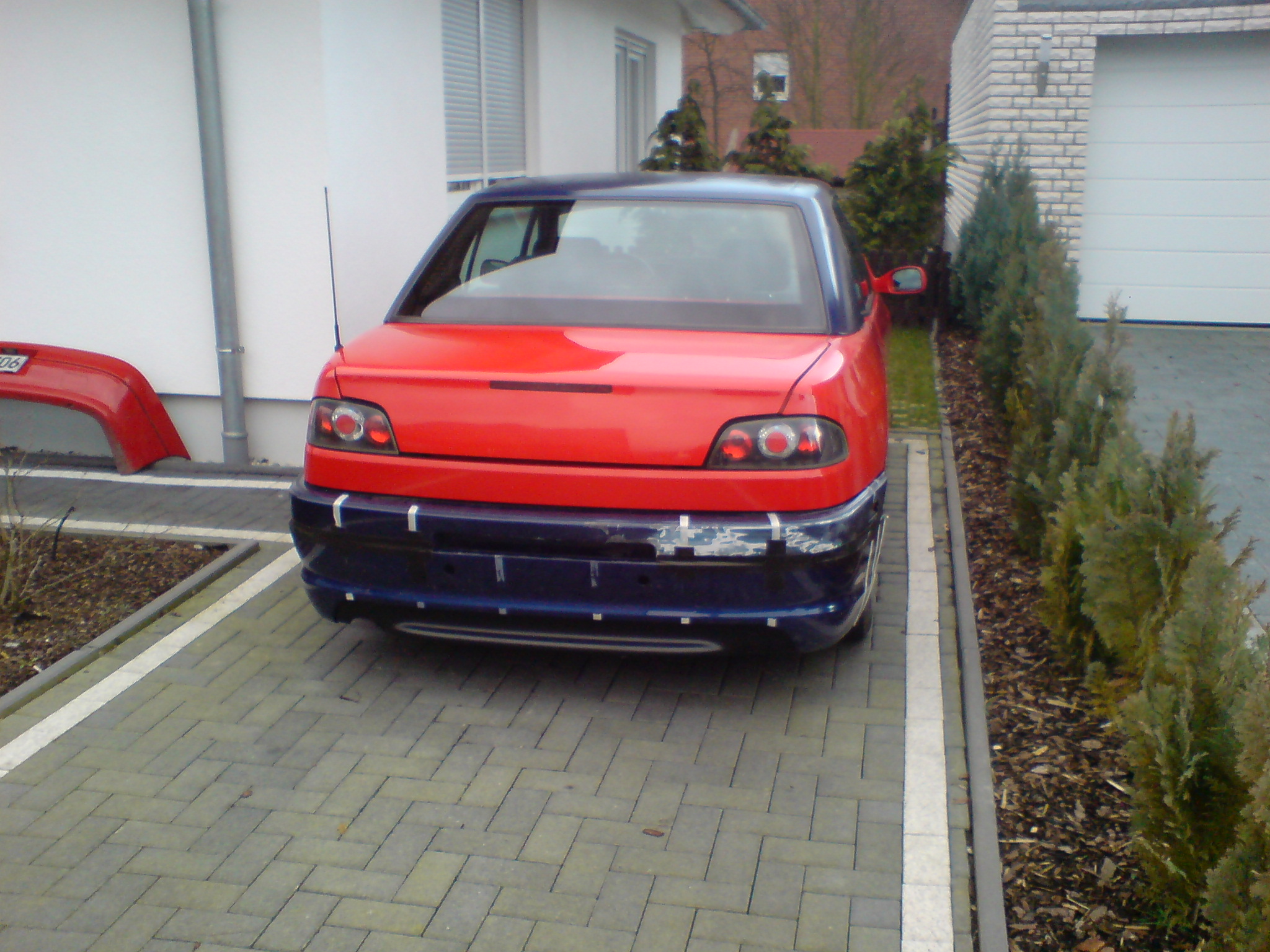

![]() Later done some work on the engine and swapped the intake manifold to the gti6 one. Also monted a E-Tech-Upper-Strut-Brace ![]() ![]() During the winter months started updating some things inside: Stage FIVE: Bodywork again ![]() Wanted to go for some more USA-Details and updated front and rear bumpers. Rear bumper was modified by an part of a BMW E46 ![]() By the way removed door locks, aerial, wash mists on the bonet.

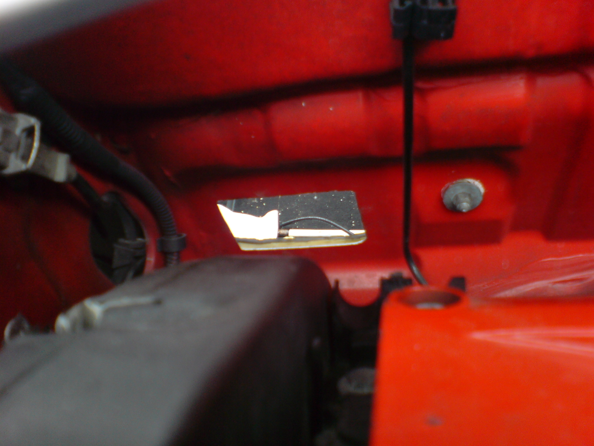

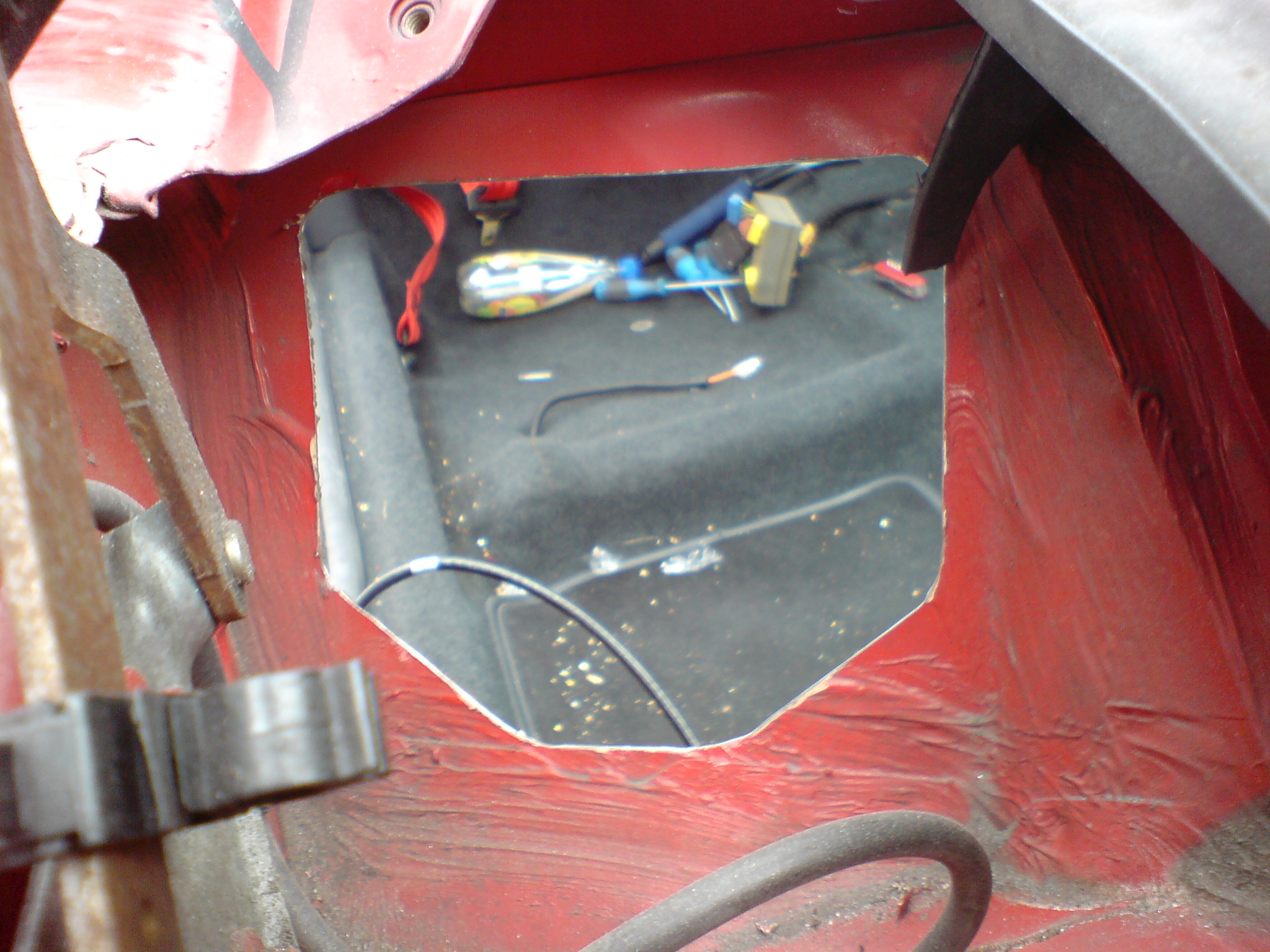

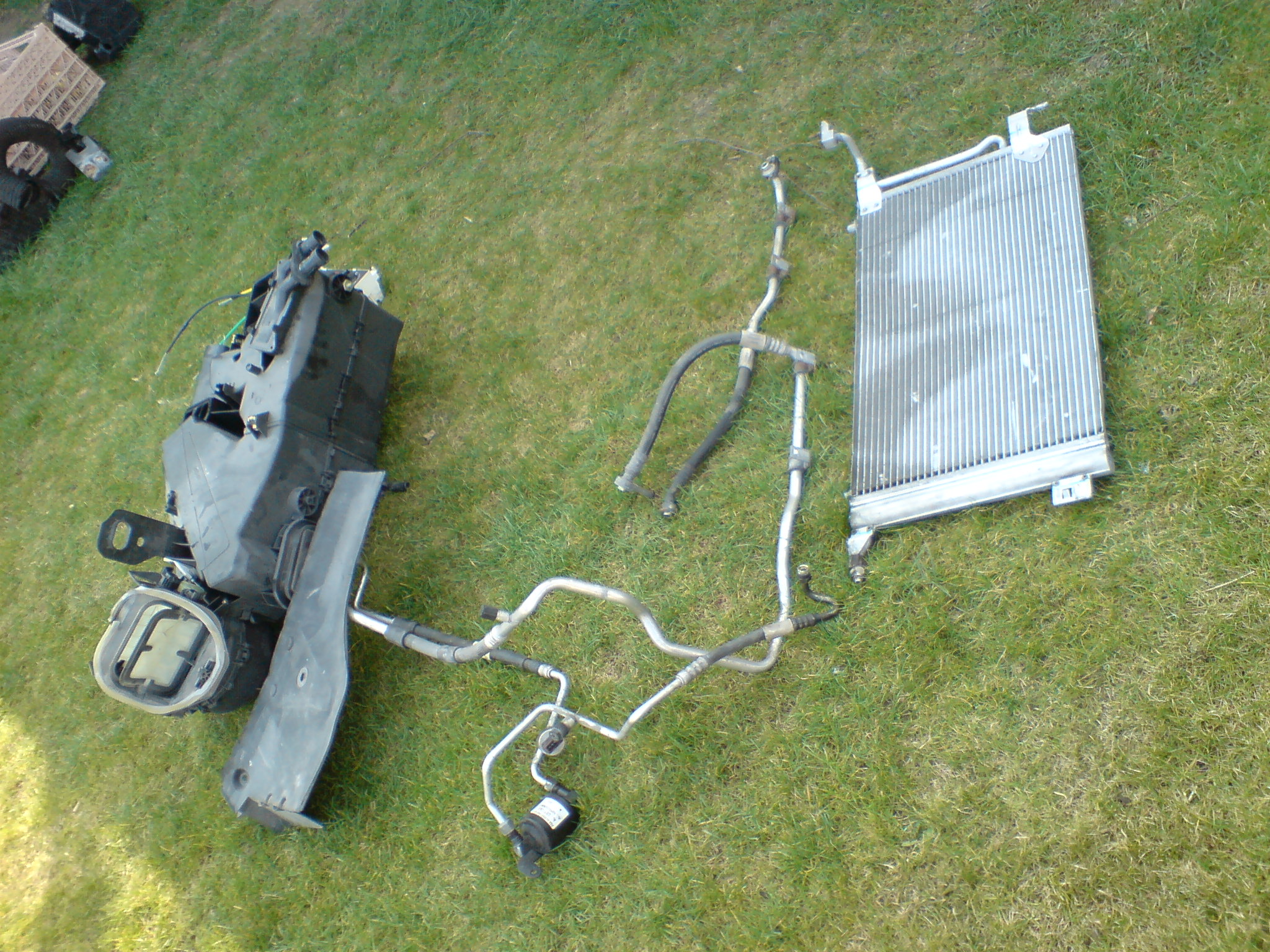

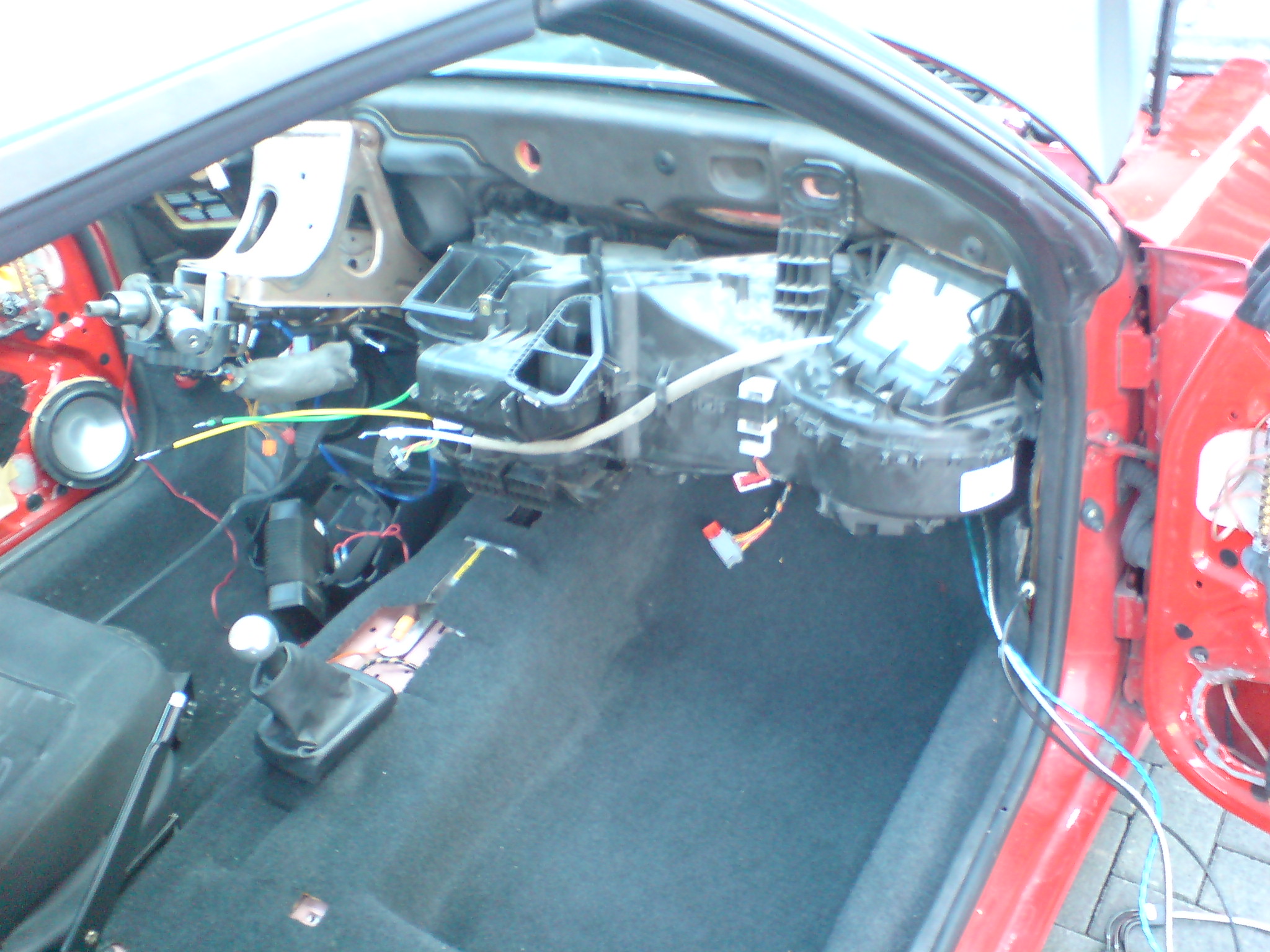

Had of the donor car still the complete AC-Setup, so decided to build it in
![]() Two cutouts later: And than changed the whole heater-matrix-fan-thing on the inside:

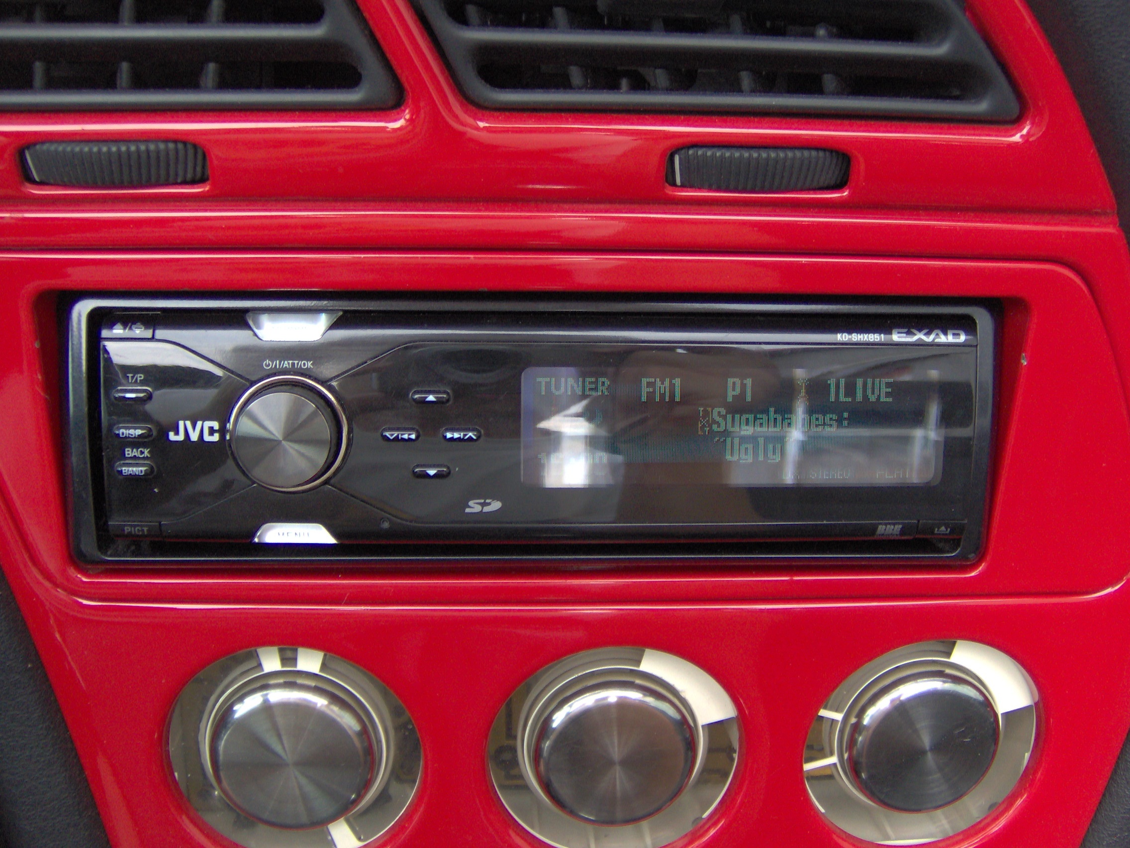

What did you do the heater dials with, doesnt look too shabby that ![]() ![]() Member of the 99% warning or you're nothing club 2000 Moonstone 1.8 Meridian - Sold 2000 China 3dr XS - Dead 1998 Diablo 3dr XSI

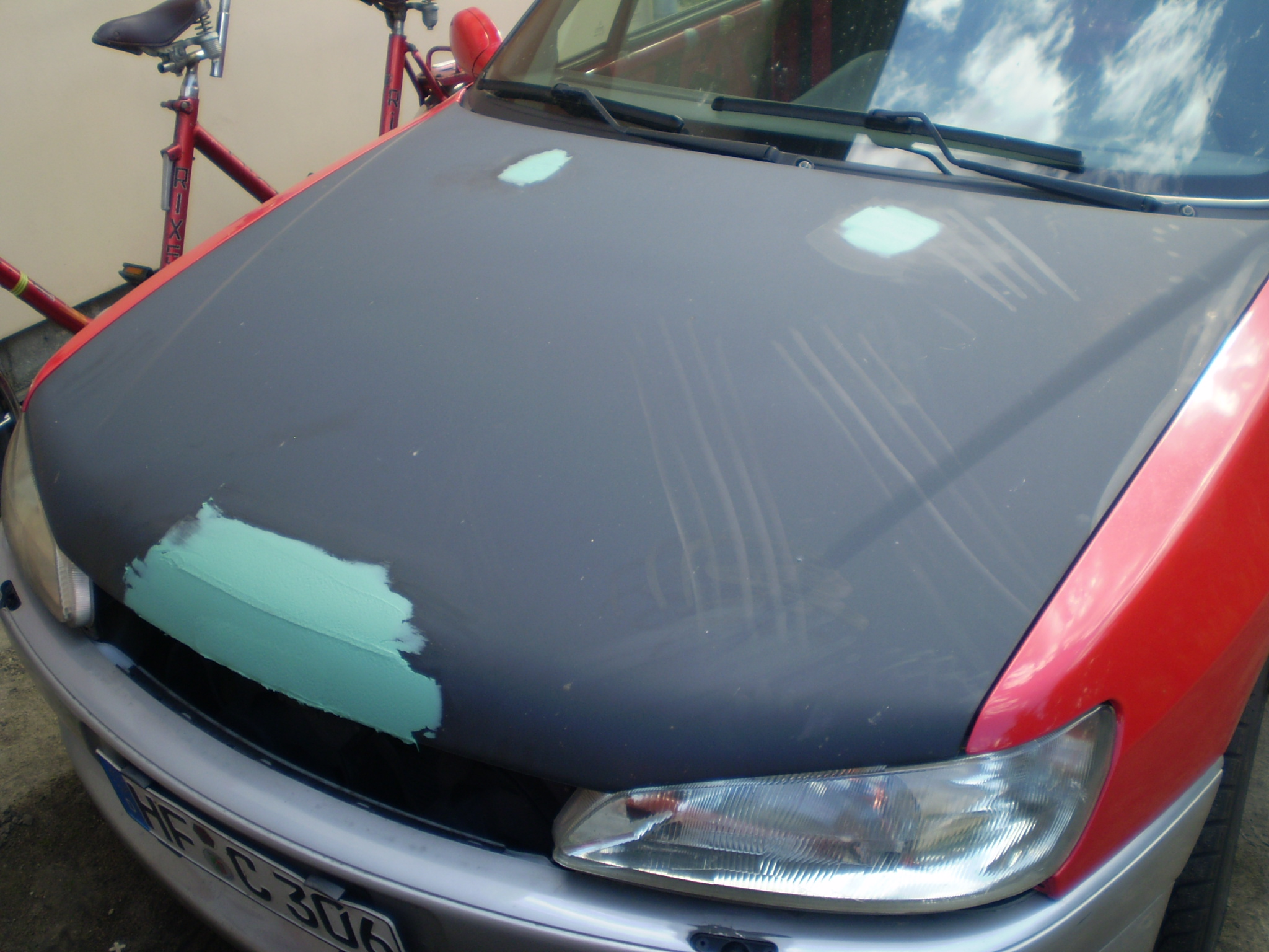

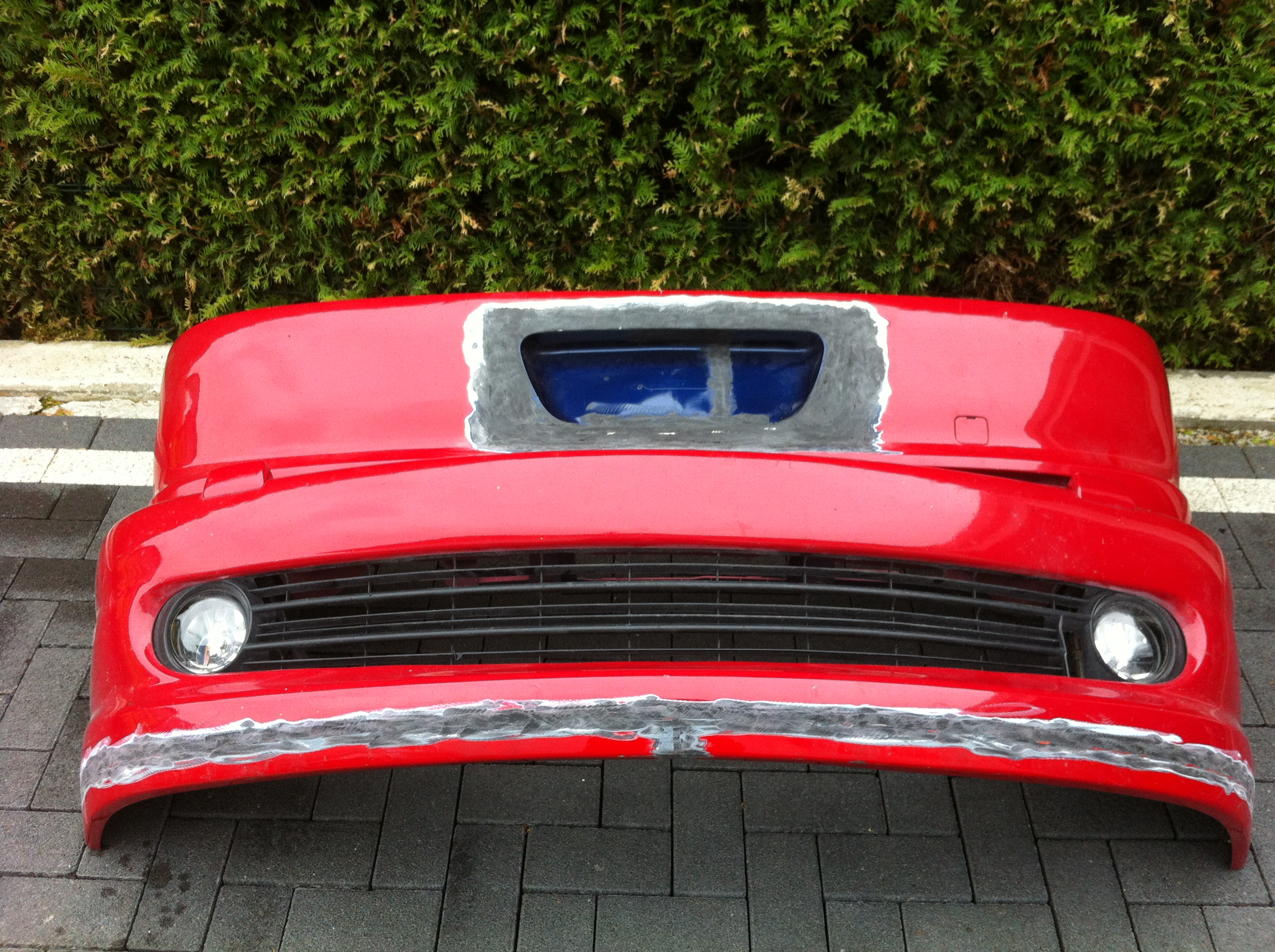

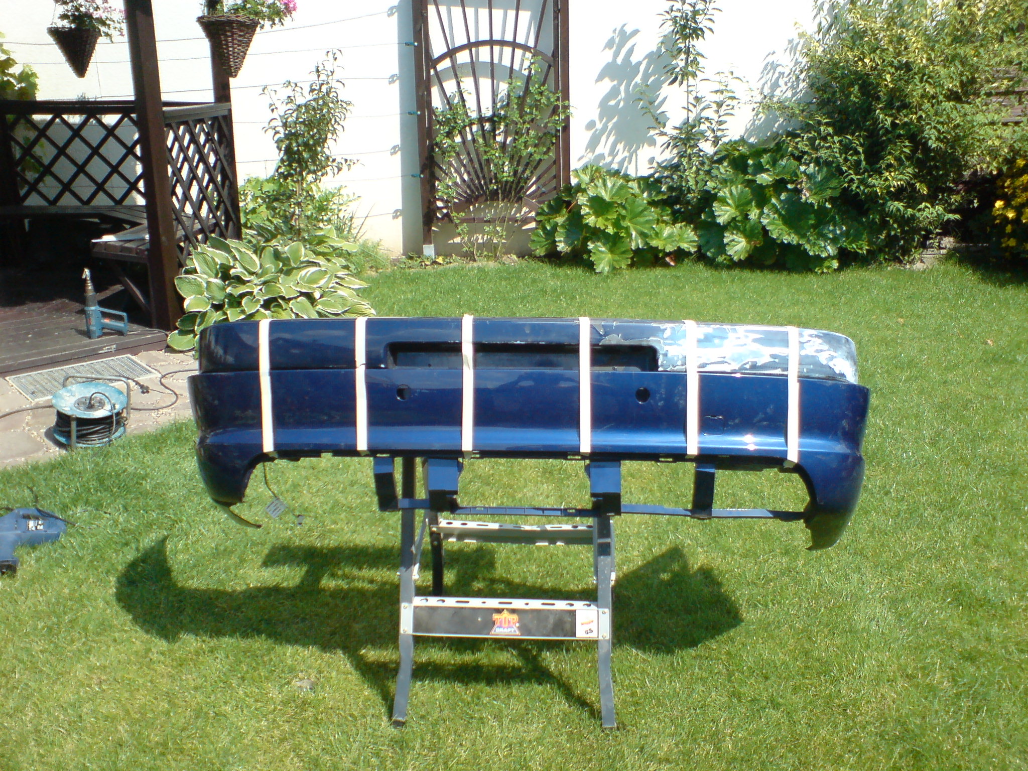

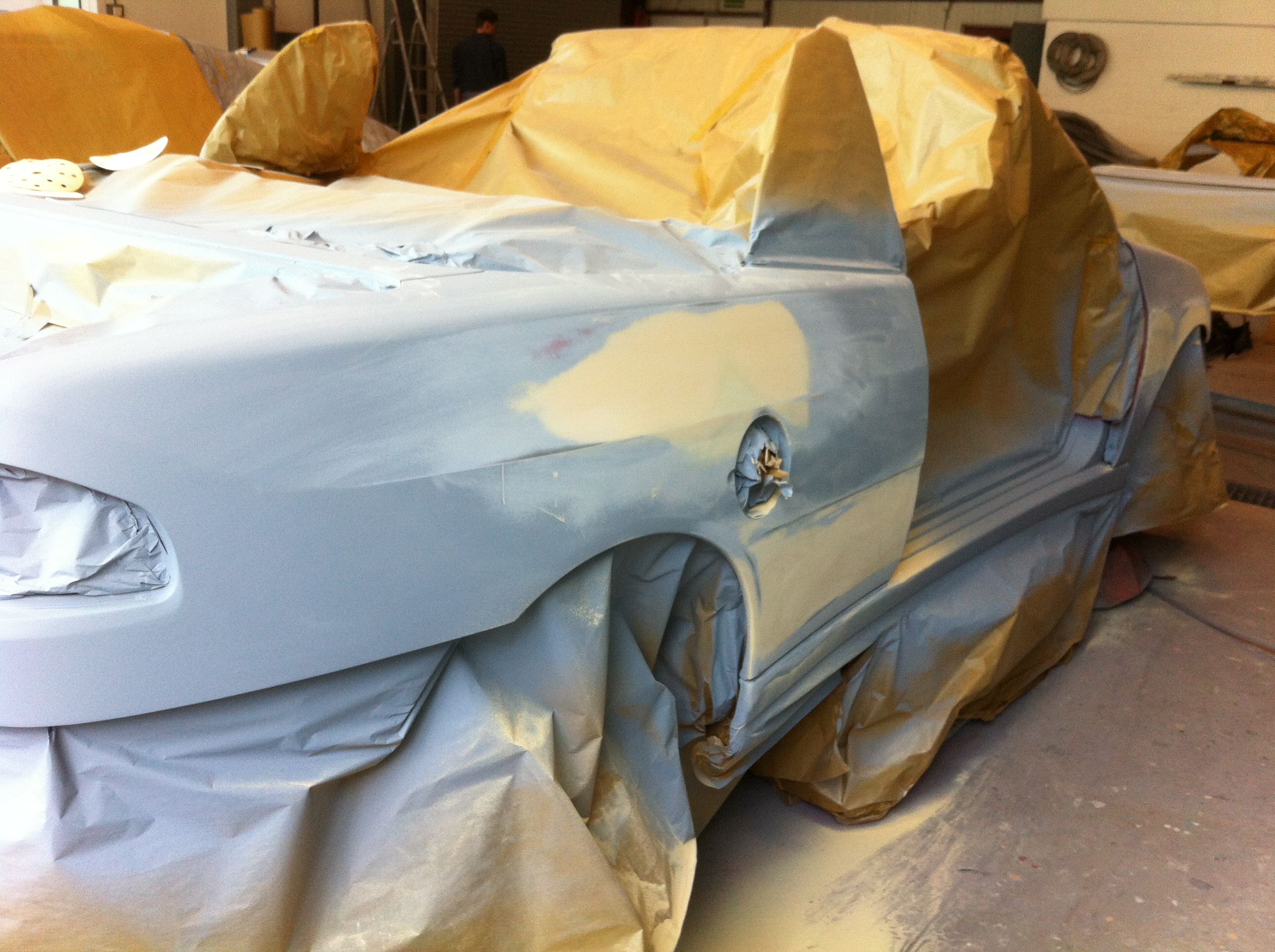

![]() Stage SIX: Sold my Phase3 bonnet and got a Phase2 one again. Had problems with the height at the washer-arms when opening it. After welding and zinc plating: Also modified the bumpers: Front one was extended about 2" at the bottom and the rear one become an number plate tray which was plastic-welded into. Have used a part of an 307 and shortened it to fit US-number plate size. By the way changed the boot for a Phase1 without 3rd braking light and smoothed it. End of Summer the Cab went to the bodyshop where all the old paint was removed and a fresh basic layer of primer went on: Had for a long time an idea in mind to change something at the interior and this was the moment to put into practice. So went out to the scrapyard and bought some donor parts. It is still french and also PSA ![]() ![]()
