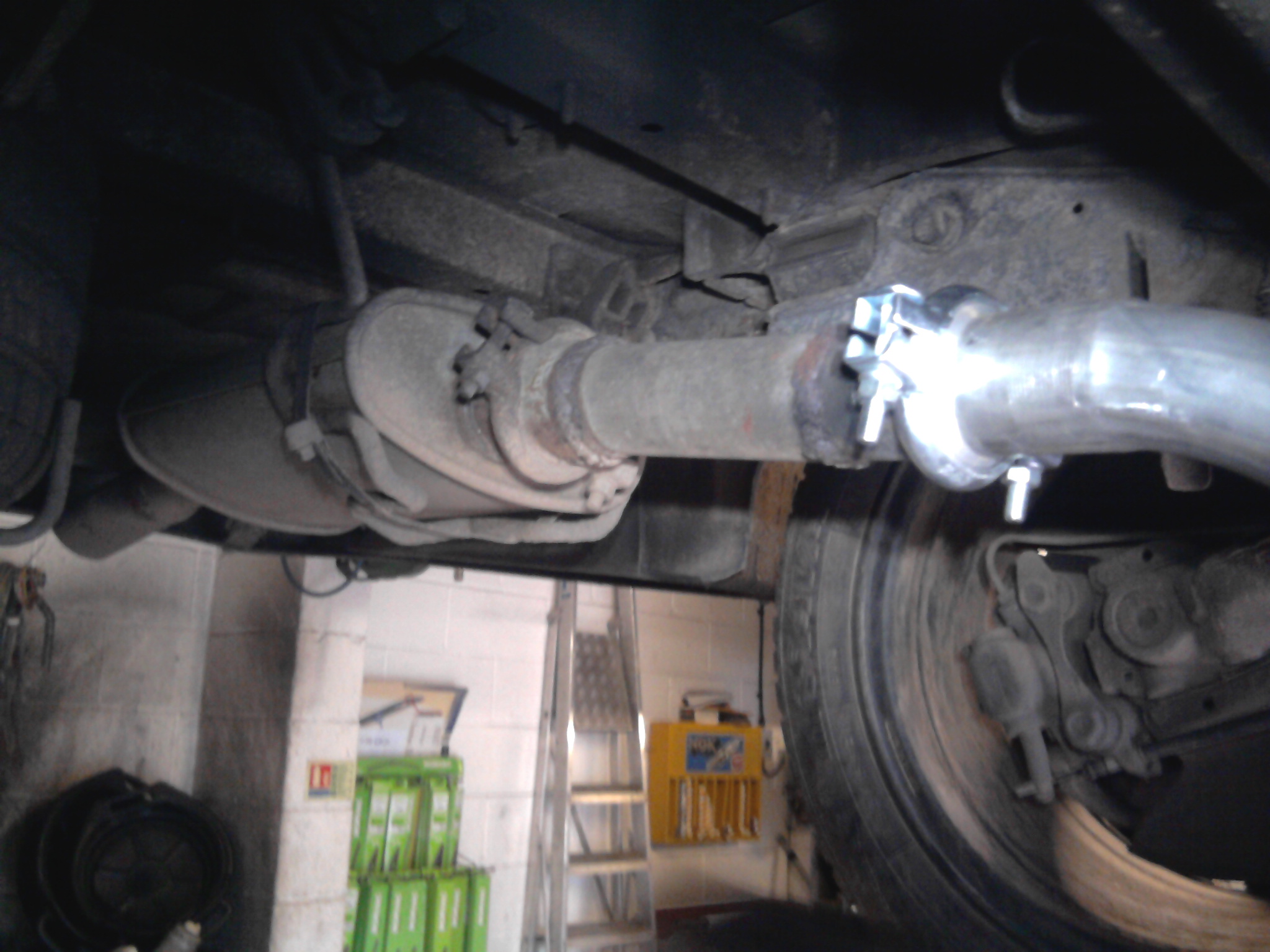

heres a picture of mine
i made a short extension section to link between the centre and backbox this is so the box was raised up so i could use the cradle from the old backbox
Tidy Job there cully!
