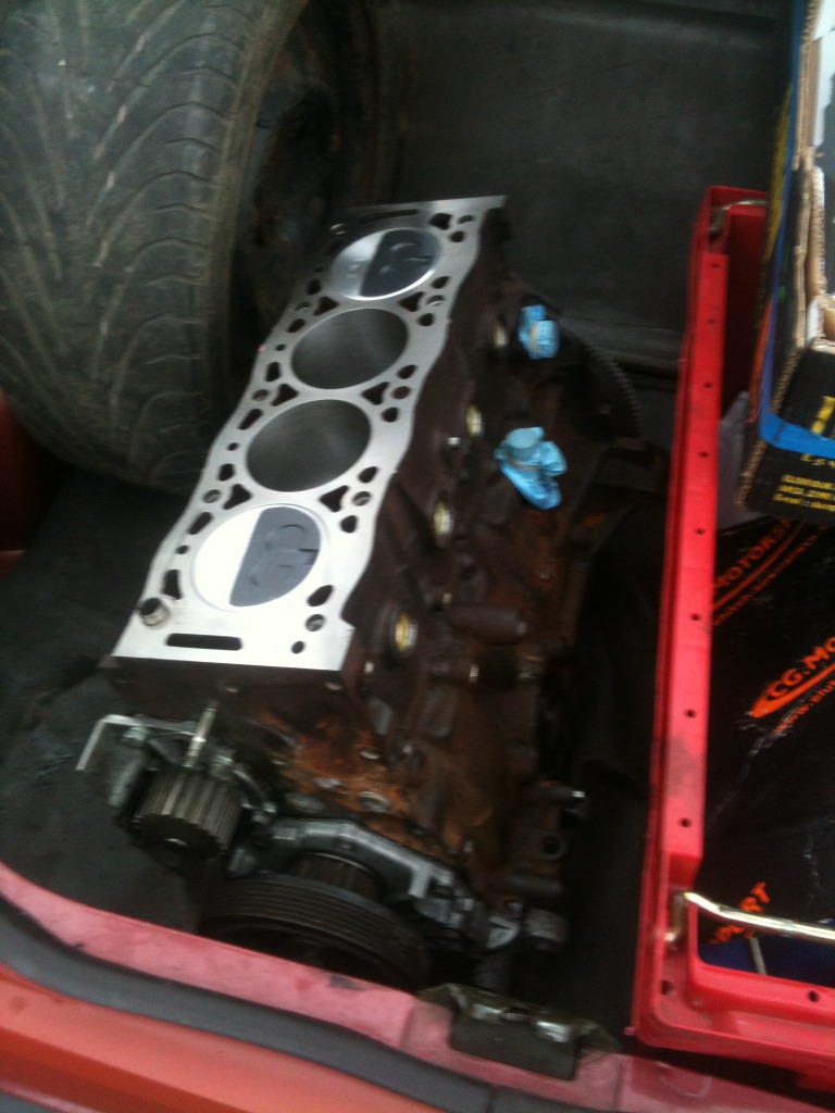

Picked up my engine today after a rebuild.

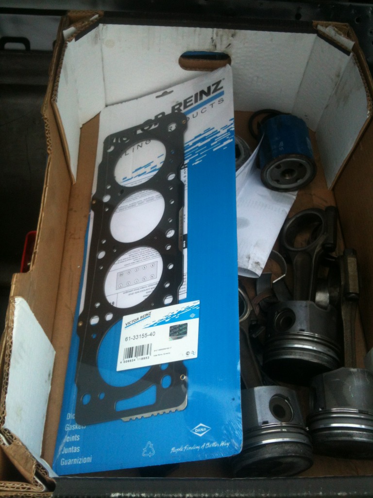

It's has some beefier rods fitted, some new pistons and rings, as well as a full bottom end rebuild, and balance.
They also managed to get me a victor reinz headgasket
Getting some uprated head studs, and got my brand new cylinder head to go on.
Completed engine will then be getting treated to a fully rebuilt 11mm Bosch and my hybrid t25, with a cg paddle clutch and perhaps a '6 box

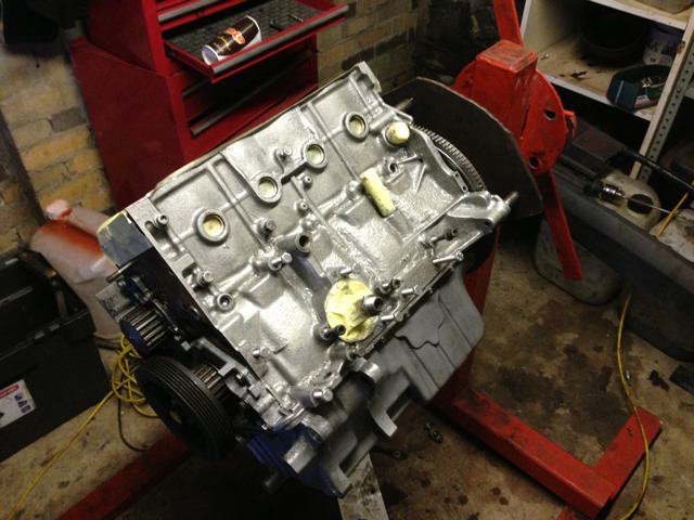

Engine in stand and painted!
Looking good Smile cant keep away from builds when they get to that point can you!

Will you be using standard head bolts?

Good looking project though mate, what kind of paint did you use for the block?

(14-10-2012, 08:38 PM)strictly_derv Wrote: Will you be using standard head bolts?
The best in-betweener of the DT box and 6spd is definitely the 205 DT box, that ripped through gears, topped out about 110-115mph on 185 55 14's though.
Getting some uprated studs for the head.
Think I'm sticking with the dt box, perhaps a xantia box

Where did you get them from? I planning to get some for another engine build
