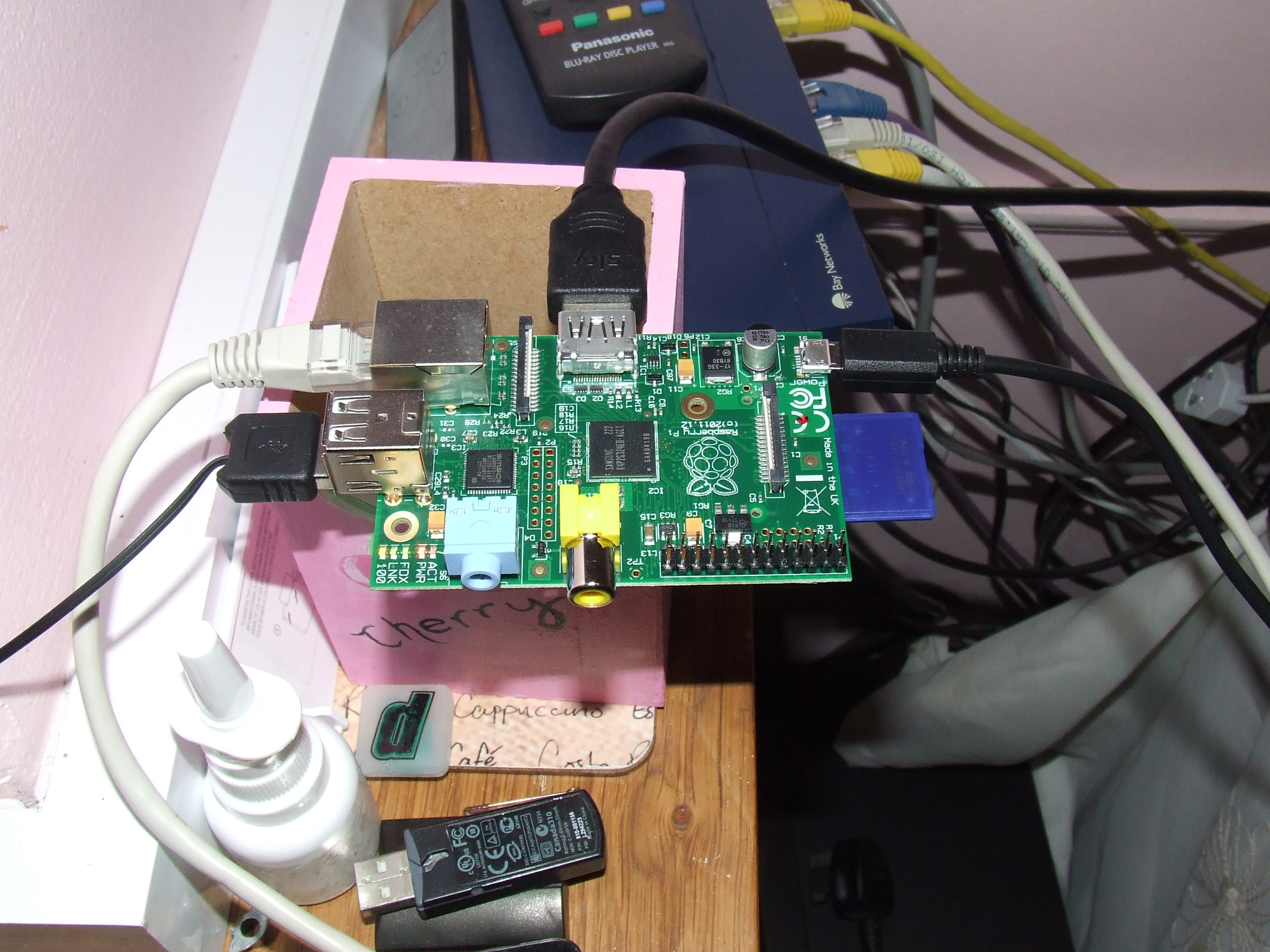

all my bits have turned up over the last few days and today i decided to have a build.
to be honest there weren't much to do other than load a SD card from a PC with the boot loader then it all set up automatically via a wired net connection
so basically Ive built a media centre that can access and play all my stored music and videos its got iplayer/itv/4oD/5 on demand channels
Ive also found NASCAR speed on demand redbull web TV and there are loads of other stuff
its Linux based running XMBC and its operating system is all on an SD card so if you have other applications for the board you just change SD cards and plug new peripherals in and away you go
say an incar computer with touch screen or home automation system controlling lighting heating via an app on your phone

yes it recognised my 8 gig mem stick i assume it will see a external hard drive too as it has two usb ports but can be split using a hub
i have my media centre controlled by a ir remote control too but what would be nice is a glass touch screen for the coffee table Hmmmmmm!

the board was £29.95 delivered from Farnell
remote control £5.85 play.com
usb power supply £4 Farnell
HDMI cable 99p Farnell
SD type10 4gig card £6 play.com still waiting for this. using a type2 @the mo
usb keyboard and mouse for original setup already have here

No, it has a full size HDMI port for HDMI out, uses micro USB to power itself.

if you get one i advise to get a fast sd card
i started on a class2 4 gig
my class10 4 gig is here now all installed and its very quick on the menus compared to the c2 card

Ive got this up and running now it works really well,
there are lots of add ons available some work some don't trial and error seems to work for me.
list of add ons i have working include

these all stream via the Internet connection

follow the blog link instructions all the software links are there
once you have the base running add ons are just downloaded and installed via a menu or onto a mem stick from a pc then transfered via the menue again
get a fast sd card class10 as it speeds up the operating system as it uses it as cach for video streaming if you use a slow card you will get bad buffering
