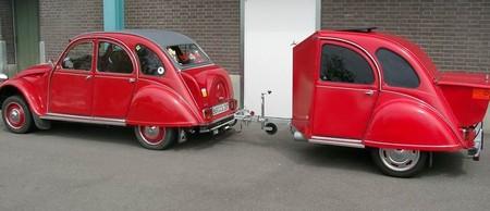

Make one of these 306 style ninja
[Image: signature.png]
There was one of them for sale on ebay that had been made from a 306
