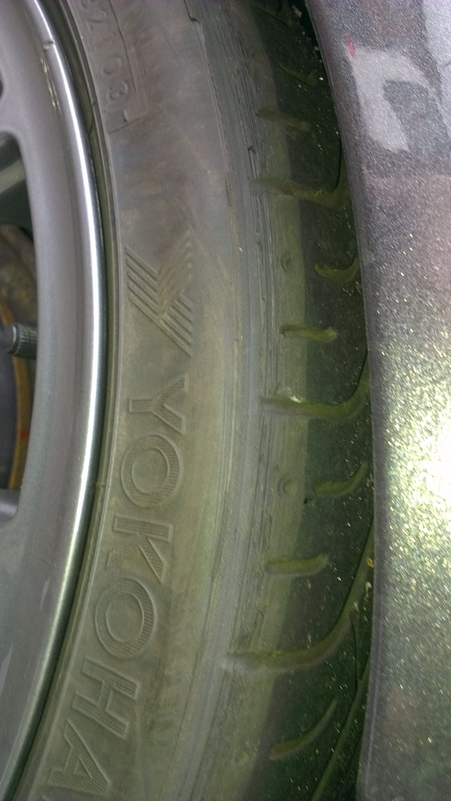

If the outer edge is able to flex that much at the *top* of the tyre, then the sidewall is a bit wank...
I've got an arch roller. You can borrow it for a million pounds.

Sorry Curt btw I just saw your post, if they do need it then yes please to borrowing your arch roller, but I may have to repay you in man love Tongue
Ruan, these are summer alloys, they're not going to be uses over winter, and not really much in the wet either; so ny question if you think I need to look. Beyond spec2s is what should I be looking at? the price bracket suits me too; most tyres are 110+ and spec2s are 90....

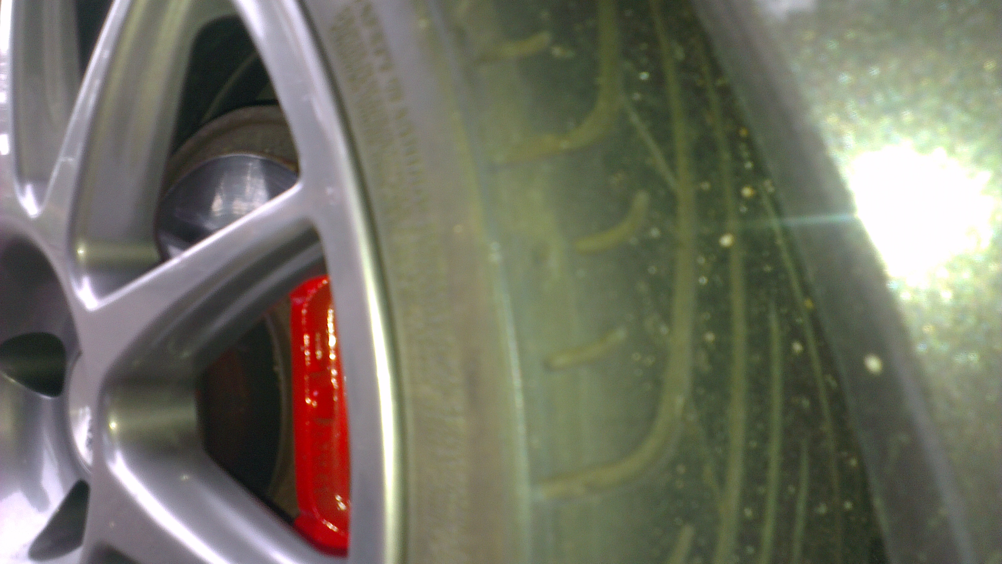

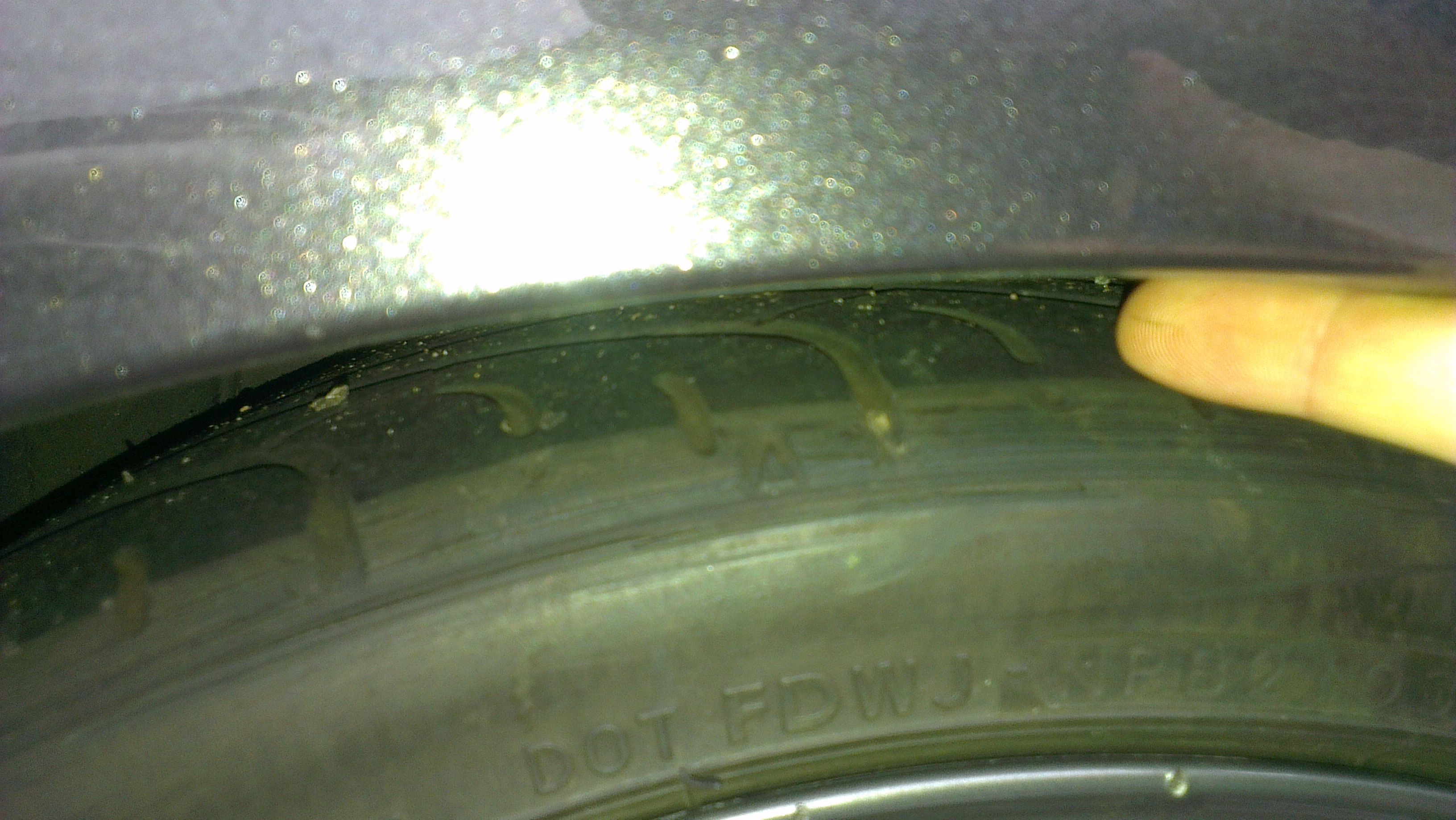

Also, these are the pics of my ns rear;
I would just curl the lip up bud bit o heat on the paint and a rubber mallet! Job done
[Image: SDC10442-1.jpg]
(07-08-2012, 07:28 PM)Jonny b Wrote: I would just curl the lip up bud bit o heat on the paint and a rubber mallet! Job done
+1 on this Ed ........... Dont roll the arches ThumbsDown
You don't have to roll the arches out, you can do the above with an arch roller. It's what I've done on mine
Ok thanks for clarifying guys, I'll have a bash at it some point, do you mind maybe helping me with it possibly Curty darling? Tongue
does it look definitely lime its rubbing then?
Defo looks like the lip is rubbing bud
