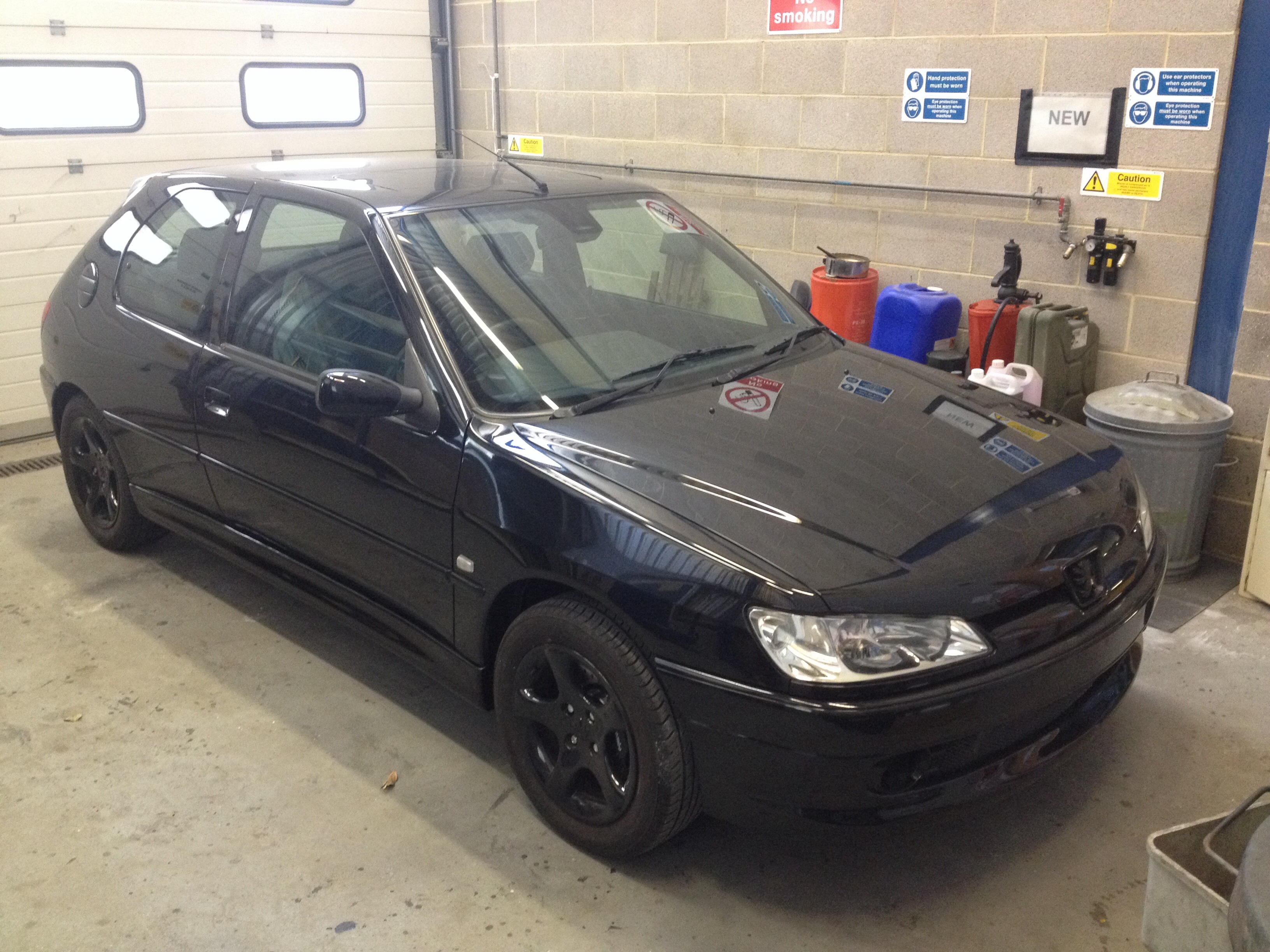

Got the front bumber finished off today and is ready for painting.
Got a set of Nimrods on the advice that they would fit over my brembos, well they dont, i still have to use the 20mm spacers.
So  Brembos with 288 mm xantia discs, will not take 16inch rims without spacers, i think i could get away with 15mm spacers.
Going to have the nimrods powder coated black when funds permit.

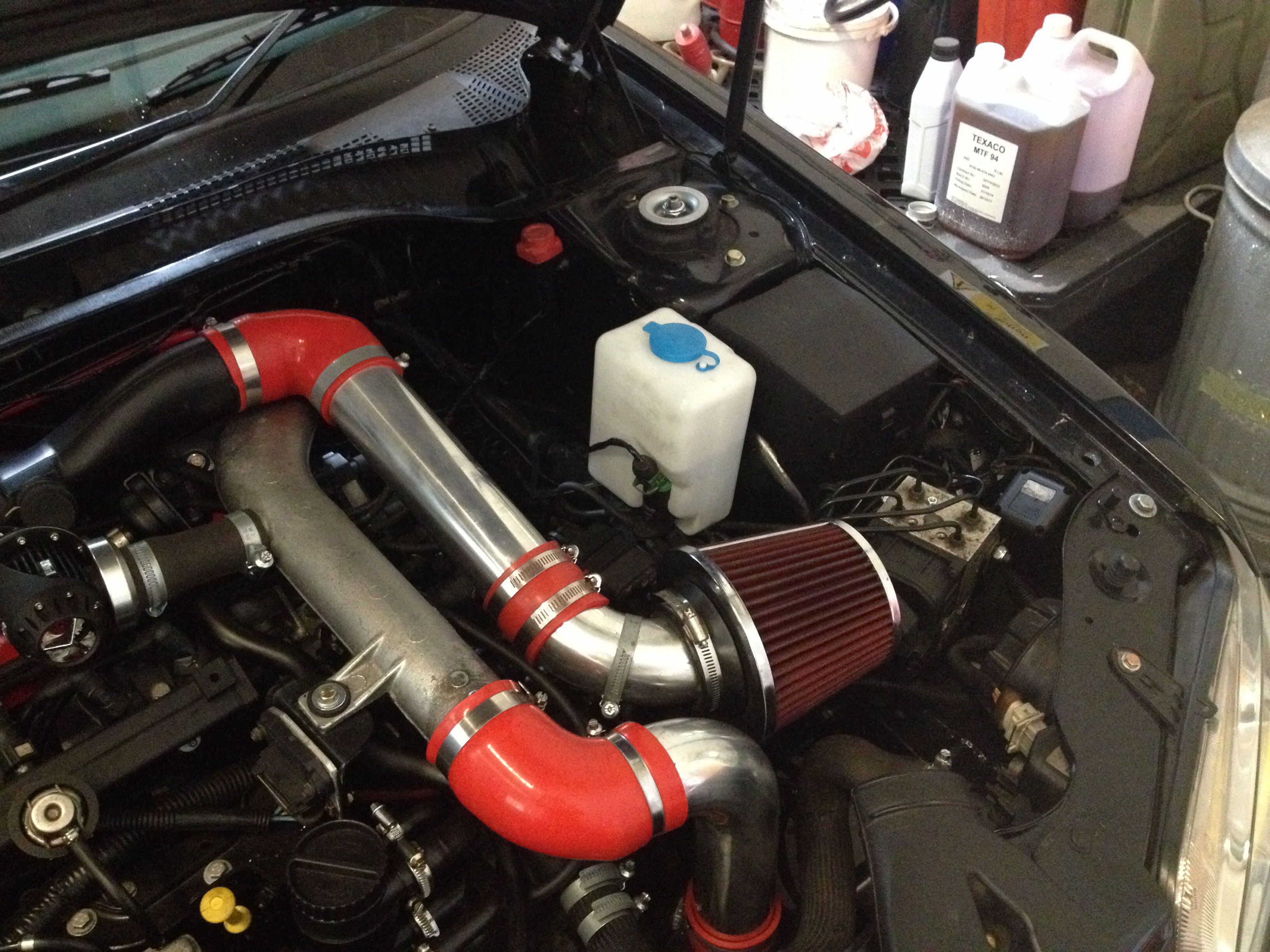

Today I got the washers plumbed in, got a kit off eBay for £7, the Peugeot washer pump fits a treat too and the bottle is the perfect size.
Ordered a pair of rallye fog light blanks from Peugeot, having to loose the front fogs because of the boost pipes.
