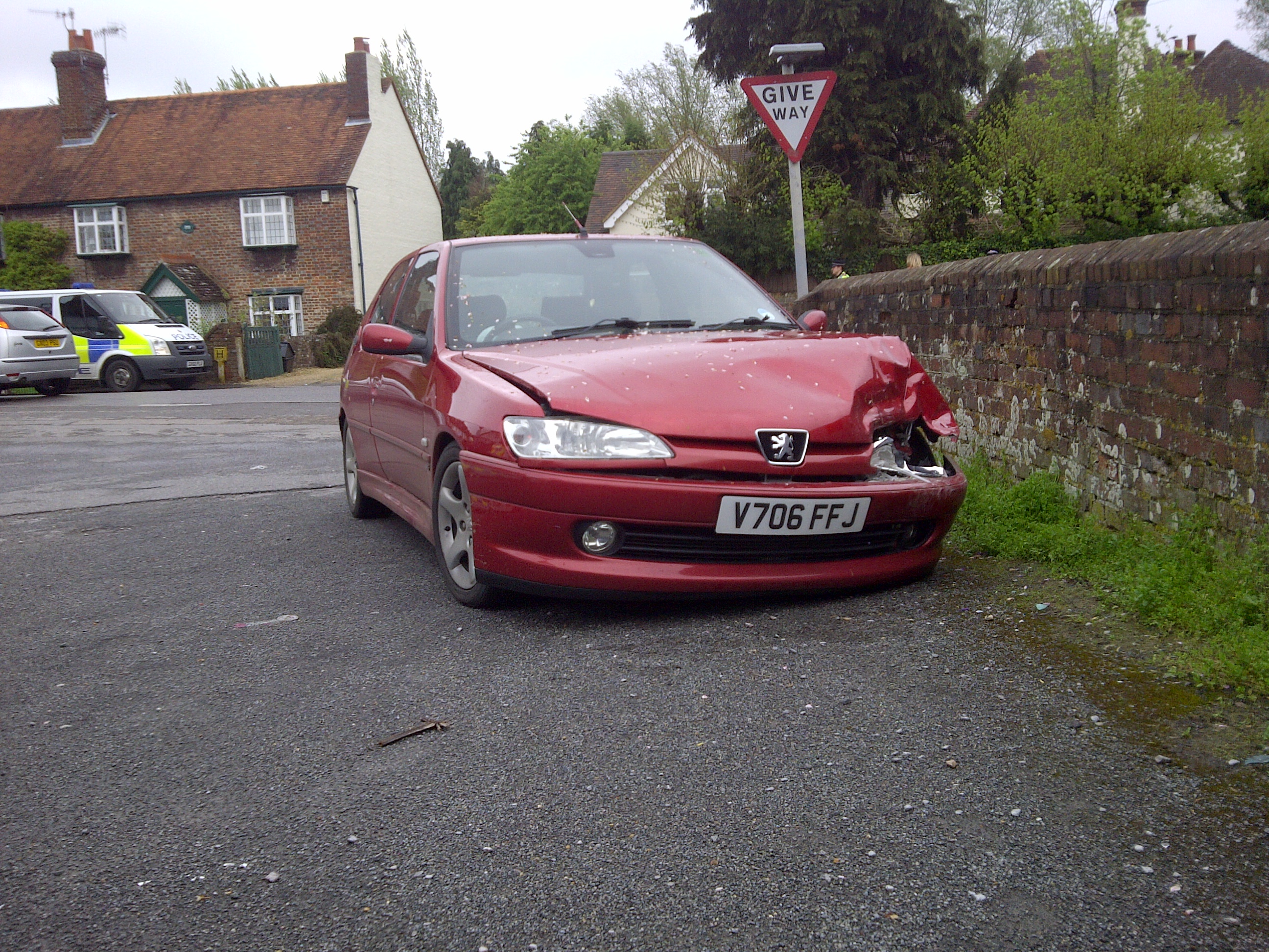

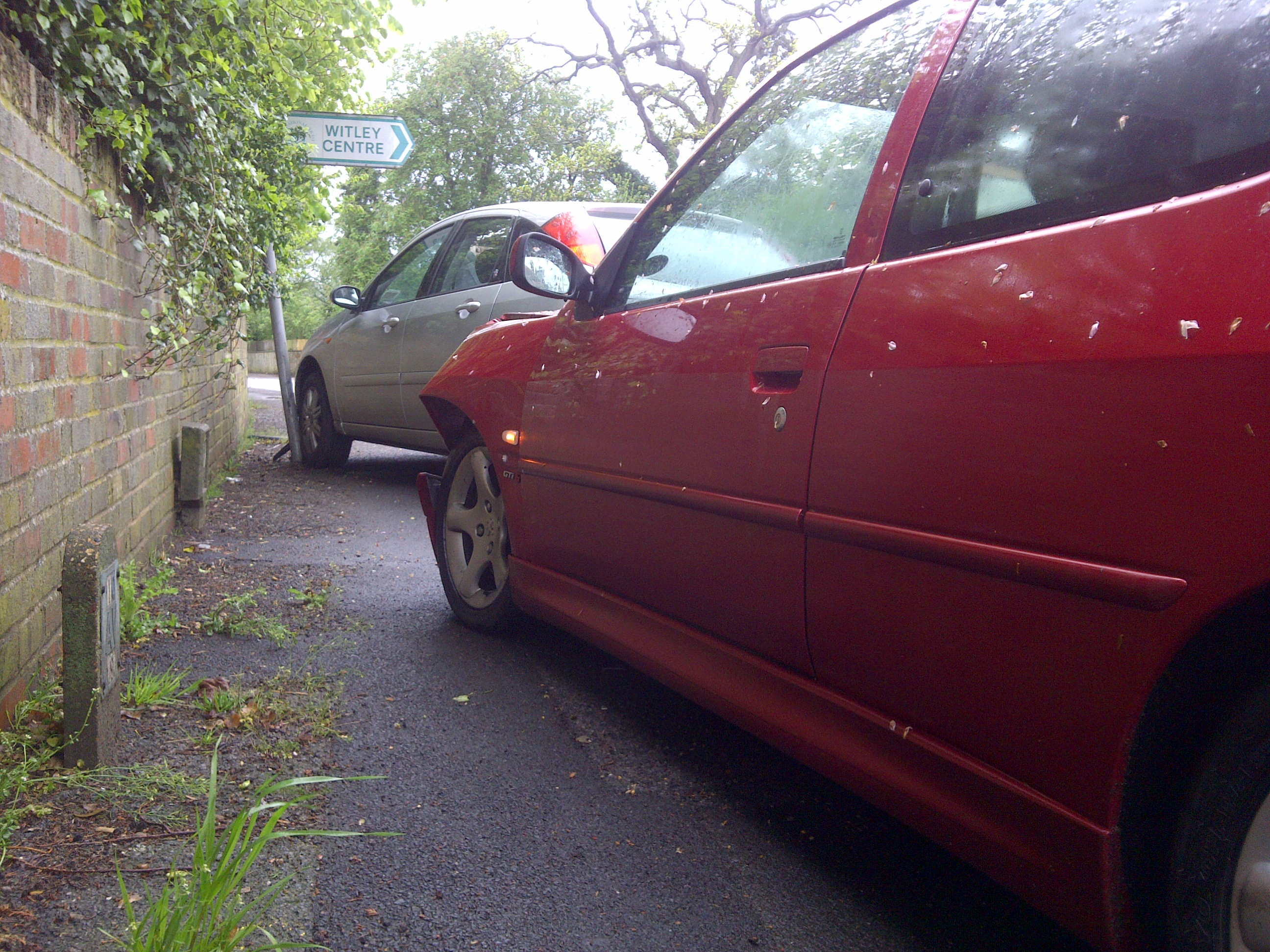

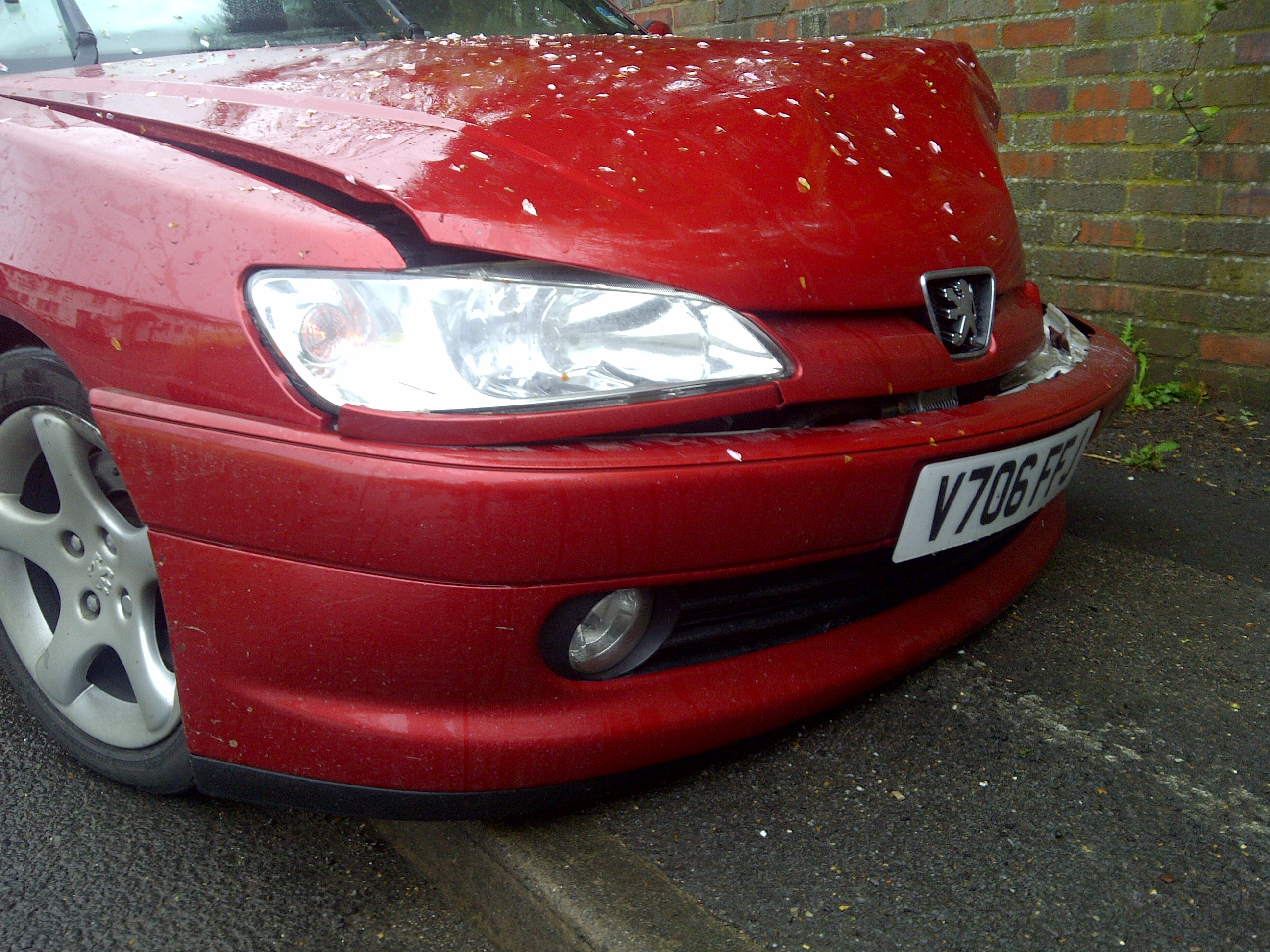

Well it's all over.
I binned it this morning on the way to work.
[attachment=3]
[attachment=2]
[attachment=1]
[attachment=0]
I'm fine, bit burnt from the airbag on my arm (the driver & passenger airbags went off, UN BELIEVABLE!), but I made it to work eventually! I could definitely have come off a lot worse!
Long story short, a car reversing out of a drive on the left hand side of the road pulled out onto the kerb, causing a cyclist to swerve off the pavement and into my path (cycling towards me). I was obviously occupied avoiding the cyclist, and missed the car in front breaking (so hard his abs kicked in and he had to ride up a kerb to avoid the car in front of him he later told me) so I just went into the back of him. Realistically I've written his focus off (old style 52plate iirc...) seeing as he cant open his boot, and Ruan is probably coming up this weekend to take a look at mine to see if it's repairable. If not I've prettymuch decided I'm gonna suck it up and buy another one; I can't be without one over summer!! Just praying all my shiny bits aren't screwed; the ones I'm worries about are the coilies and eccentric topmounts, and the oil cooler. I dont *think* it got hit, but I'm not even gonna have a look till the weekend, it'll just depress me futher.
I am totally distraught. It sounds so gay, but you get so attached to these cars, and with all the work I put in (with Ruan too!) over the 2 years of owning, I feel like a person has died rather than me just binning a car! I know that's wierd, but I love my car, so there it is!
So there we go. I'm f**king depressed, I can't look at the photos right now.

O.o that's a bit of a bash you've taken there.
That must be fixable though.

Oh and seeing how bent the front corner is it is repaiable but it wont be economical. To be done properly it would involve cutting a chassis leg off another 306, having it welded on and then the whole chassis jigged.
If you want to repair the pikey way hammers, jacks, big pry bars, rope and a lamp post will get the leg relatively the right shape then youll just need big washers and new bolts to make a new wing fit.

the outer wing looks bad, but the inner wing looks ok I think. I don't know really though without taking a proper look. Tbh I don't want to think about it or build myself up that it's fixable before getting a properly good look at it. So we'll see, hopefully I'll have a chance over the weekend, and I'll report back when I do.
That sucks Ed Sad
On a plus note, how closely have you looked under the bonnet, Im not sure that the leg will have been bent to much looking at that....if thats the case its just a case of another diablo breaking car for wings / bumper / slam panel, bonnet and lights etc, which wouldnt be hugely expensive...if the front of the leg is bent a bit can easily be fixed, only real issue is if its properly bent the leg, but looking at the damage id not have personally said it has...try and take some photos in underneath around the front of the leg (abs pump area) etc so we can see better..

I'm going to stick my neck out and say the bumper didn't take much damage, so likely you haven't hit the leg behind it. Maybe slightly bent it where the light meets it.
£1 says it's repairable.
