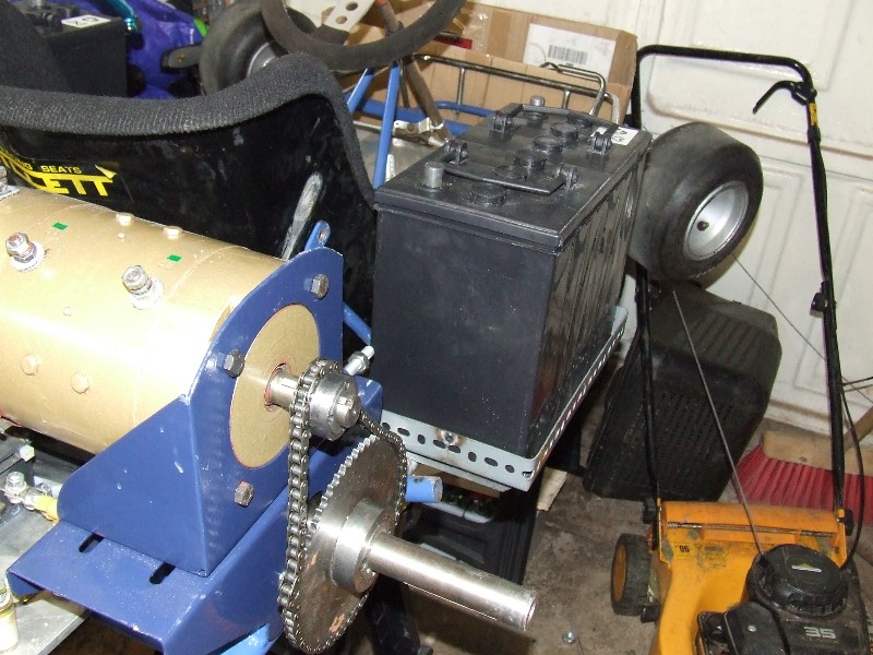

one of the issues i have is mounting the large motor as it wont mount on the existing motor mounts so i have had to fabricate a beefy mount that wont flex with the torque of the motor, so i have built this out of 3mm plate steal
am hoping its adiquet if it flex's i will weld some ribs onto it
another photo update
have finished the motor mount system, fingers crossed its going to be strong enough to hold the torque of the motor
all painted and have mocked up the install

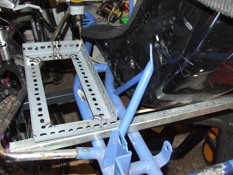

so ive cut off the seat supports off with a disc cutter
i love the disc cutter Smile
so now ive had more ideas on battery mountings so im having to refabricate the seat mounts which gives more room for the batterys Smile one ether side of the seat
have also bought battery cable crimp lugs and a crimper for 35mm crimps

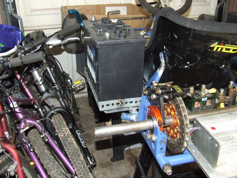

well it looks to be getting worse as ive cut more stuff off
then suddenly stuff starts to come together again
have made up two battery trays one for each side now i can offer up the seat and trays to get some sort of fixing ideas
had a mass build day today in and out of calls from work
and finaly the fat bastard can sit in the Kart seat mounts and battery trays are in !
Epic. What do you reckon the total weight is going to be? Should be under say 150-200kg?
(08-07-2012, 08:27 PM)Niall Wrote: Epic. What do you reckon the total weight is going to be? Should be under say 150-200kg?
im going to guess 200-250 with the Fat driver Itwasntme
