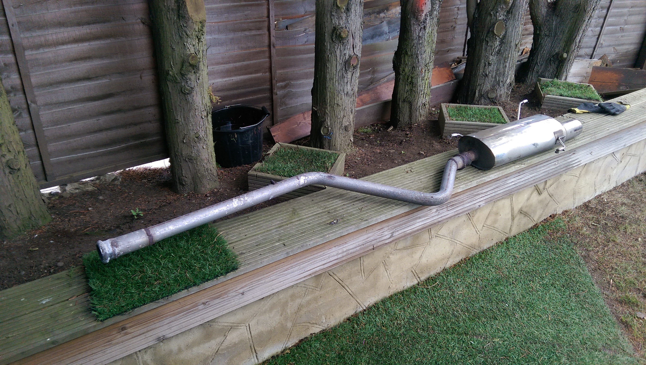

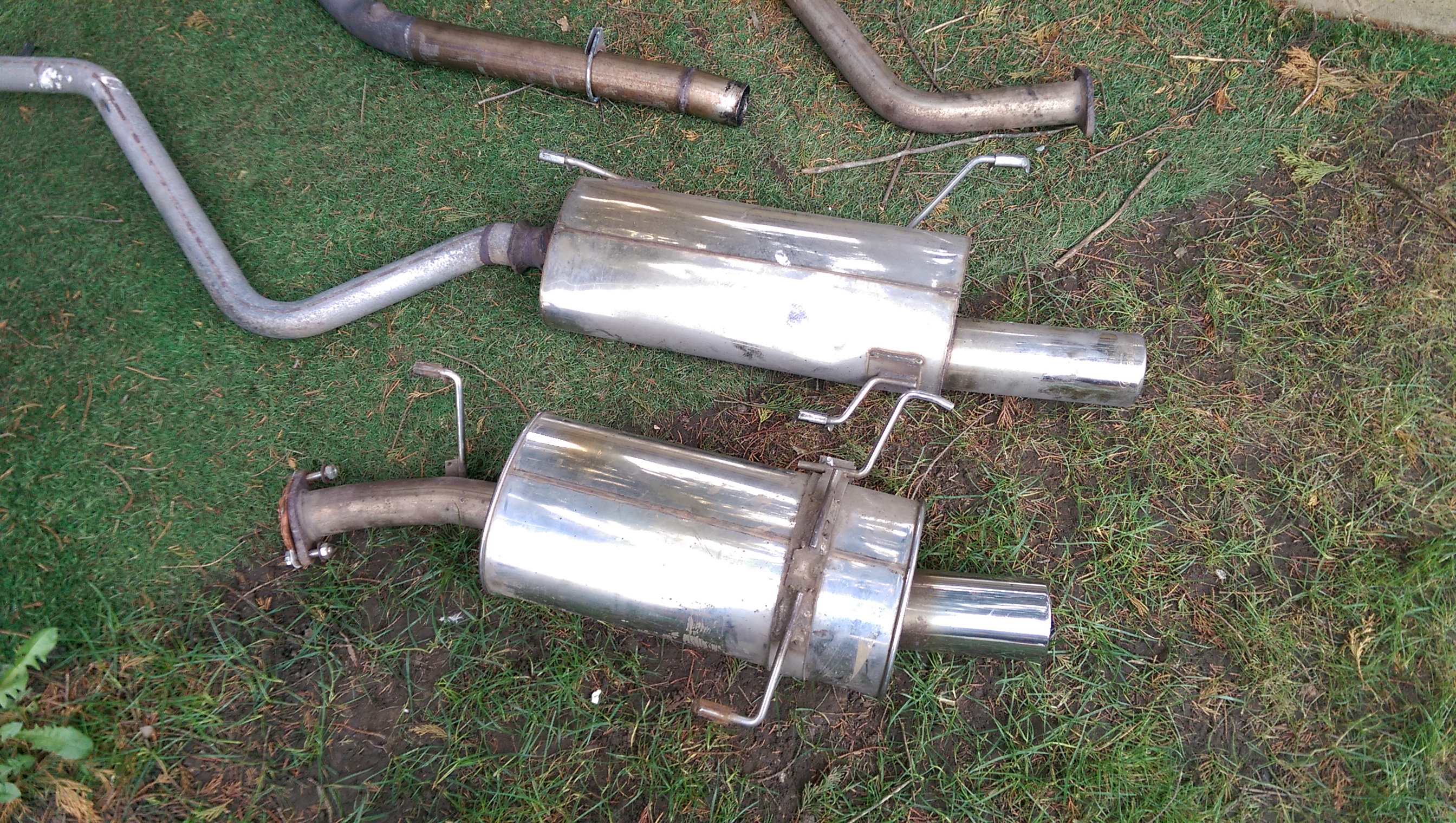

In the interim I managed to pick up a full de-cat Mongoose system and a couple of Sparco seats with subframes:
Bye-bye noisy straight through and loud Scorpion backbox:
Hello Mongoose
Took a little getting use to, but way quieter!!

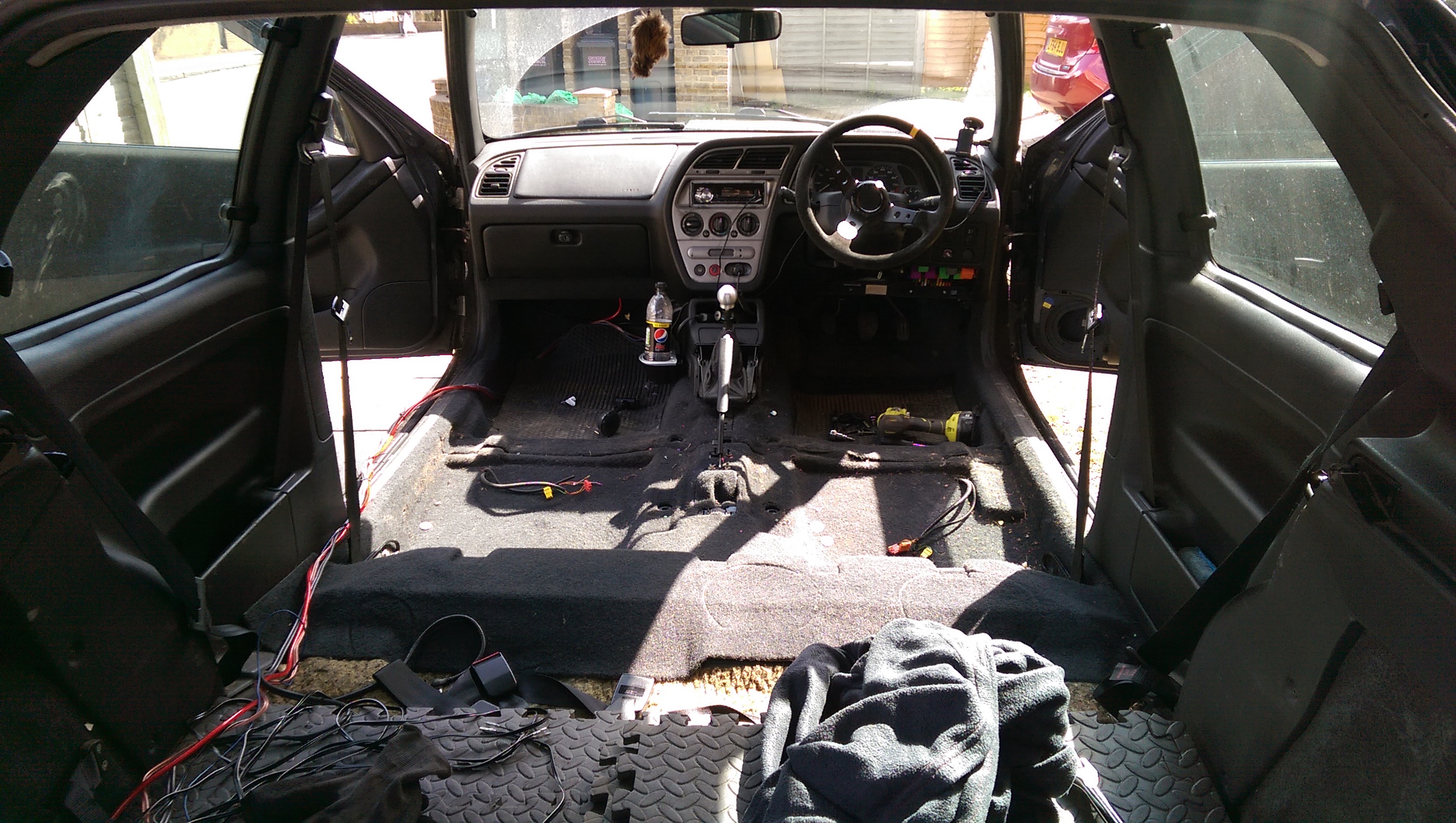

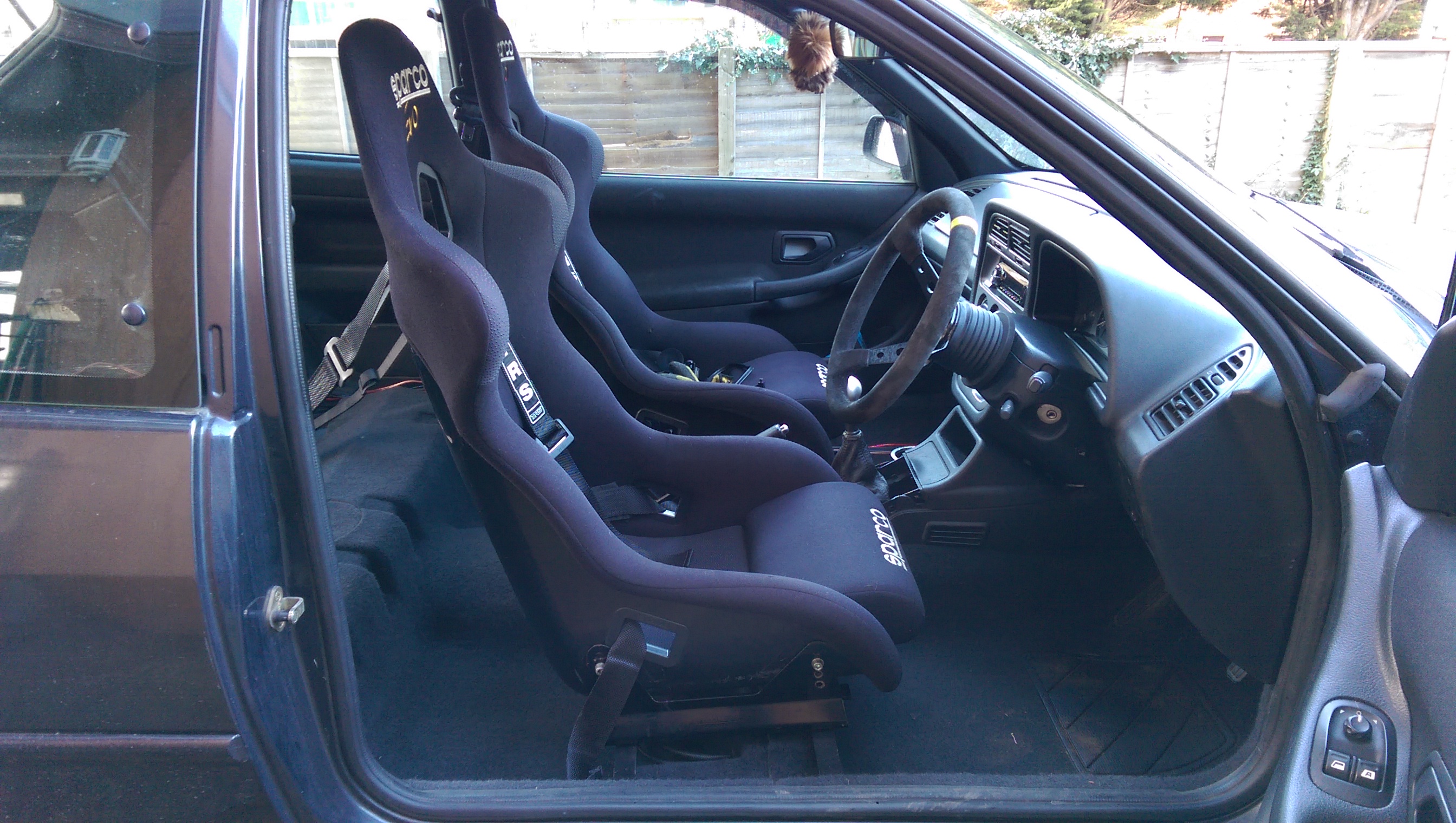

Stripped out all the seats and dropped the Sparcos in:
As of this afternoon the car looks like this:

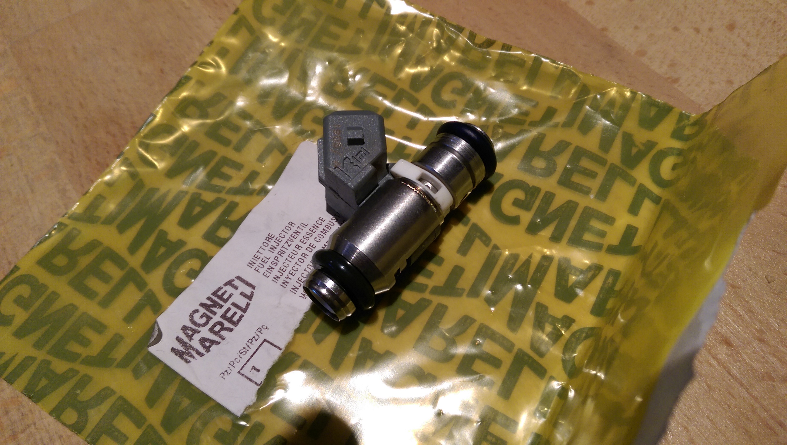

Ohhh and some Weber/Marelli PICO fuel injector - 377cc/min
The reason for these will become apparent later on Wink

geezz do you plan to run boost with those injectors? Wink tad big
90' 205 gti6 supercharged
05' Evo 9 IX GT
Team eaton.
#94
(01-05-2016, 07:53 PM)Stef205 Wrote: geezz do you plan to run boost with those injectors? Wink tad big
I believe they are good for 250bhp Wink
#95
you need to run injectors at 95% duty these will be at 50% far to big they are even listed for boosted apps

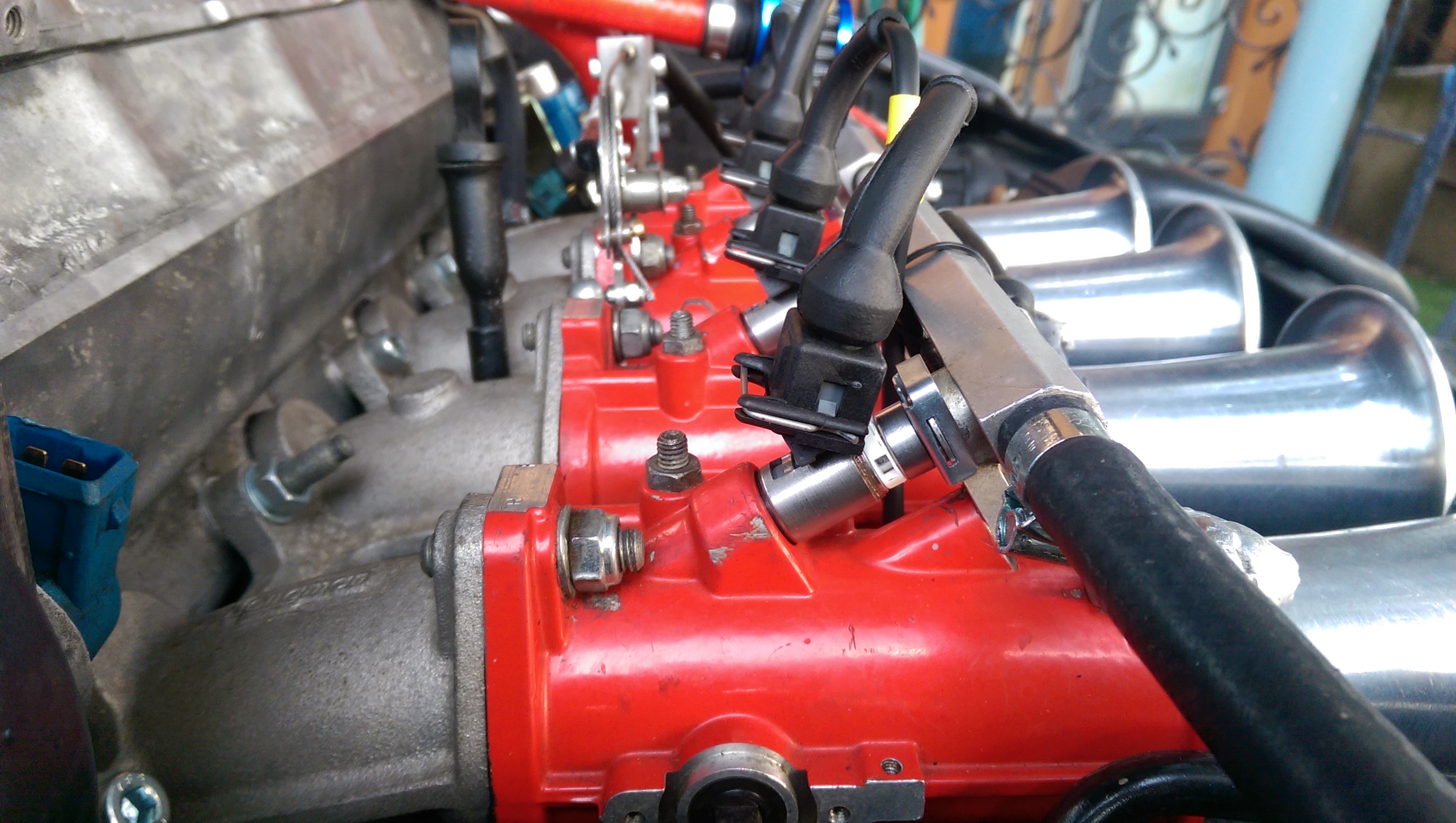

I have two questions. Firstly what are you planning to do with the oil breather? I had mine like that on my 1.8 with bodies and it leaked oil everywhere after some time so definitely get a can fitted. Secondly what is the vac line setup? Ive gone straight from the vac pump to the brake vacuum lines with nothing to the manifold. Yours look likes it goes back to the bodies so i presume you have a double or single take off?

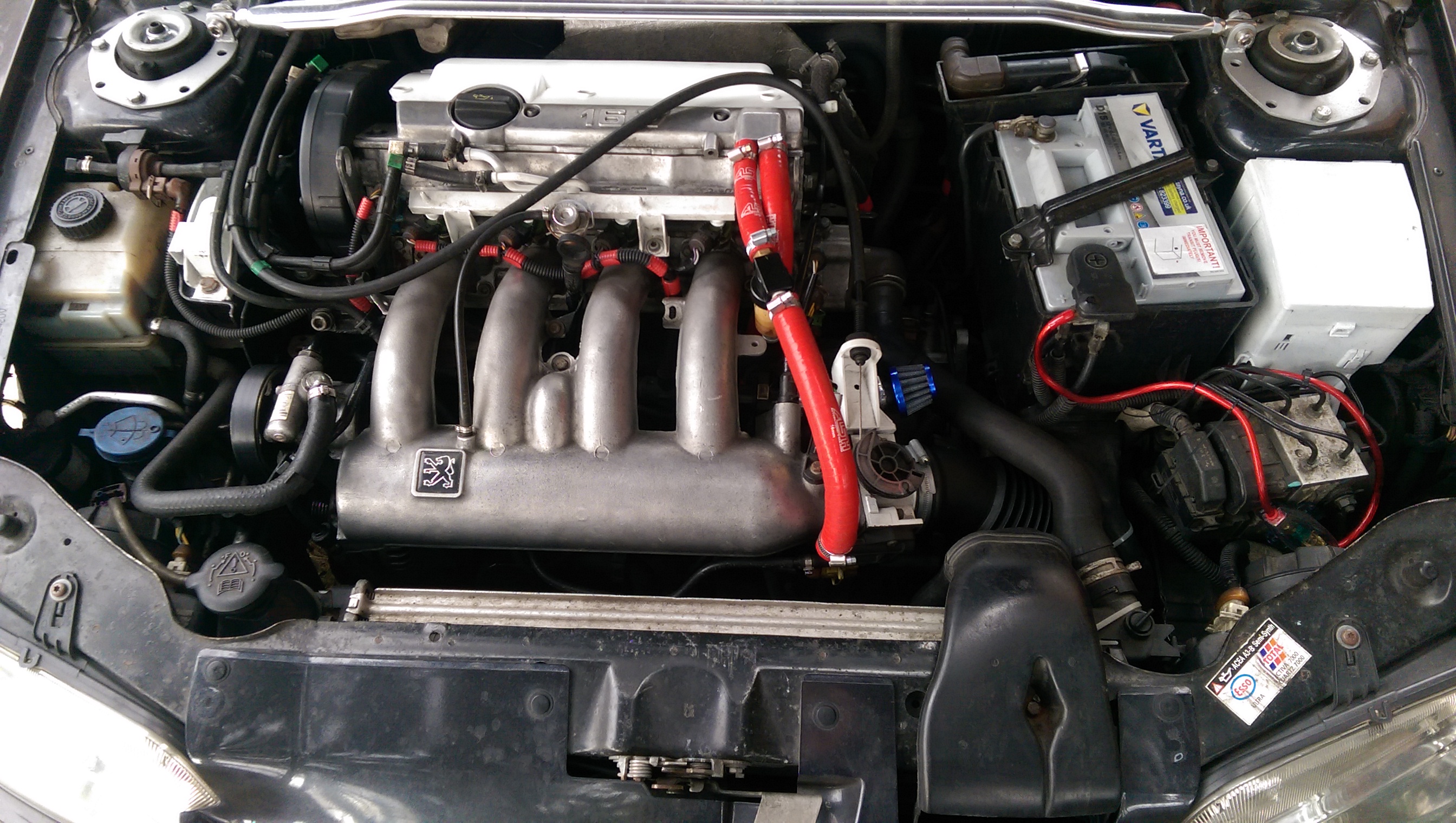

Re the oil filter, I have a little catch tank which will be going back on with the filter on the end -->>
[Image: attachment.php?aid=27477]
and yes, it goes back into the manifold for a single take off:
THe little catch can looks like a good idea. I saw you had that previously but would have thought you have had fitted it straight away. Ive got a catch can ive never fitted and stored for years so im just going to use that especially as ive bought all the bits to pipe it up now. Did you drill the bodies to fit the pipe or was it already there? On my 1.8 there is no vac pump so to get any vac at all i had to drill the bodies but ive blocked the hole up now the 6 has a vac pump.

Was tapped into the longman manifold and not the bodies. Should really have another into the 3rd manifold joint, a job for a later date.

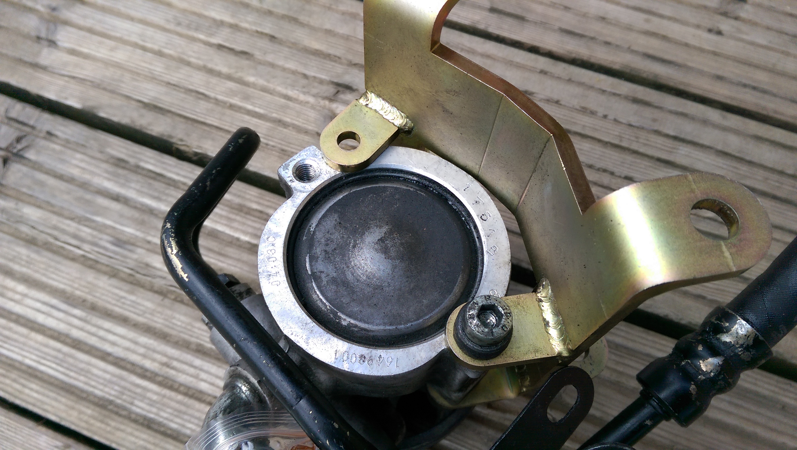

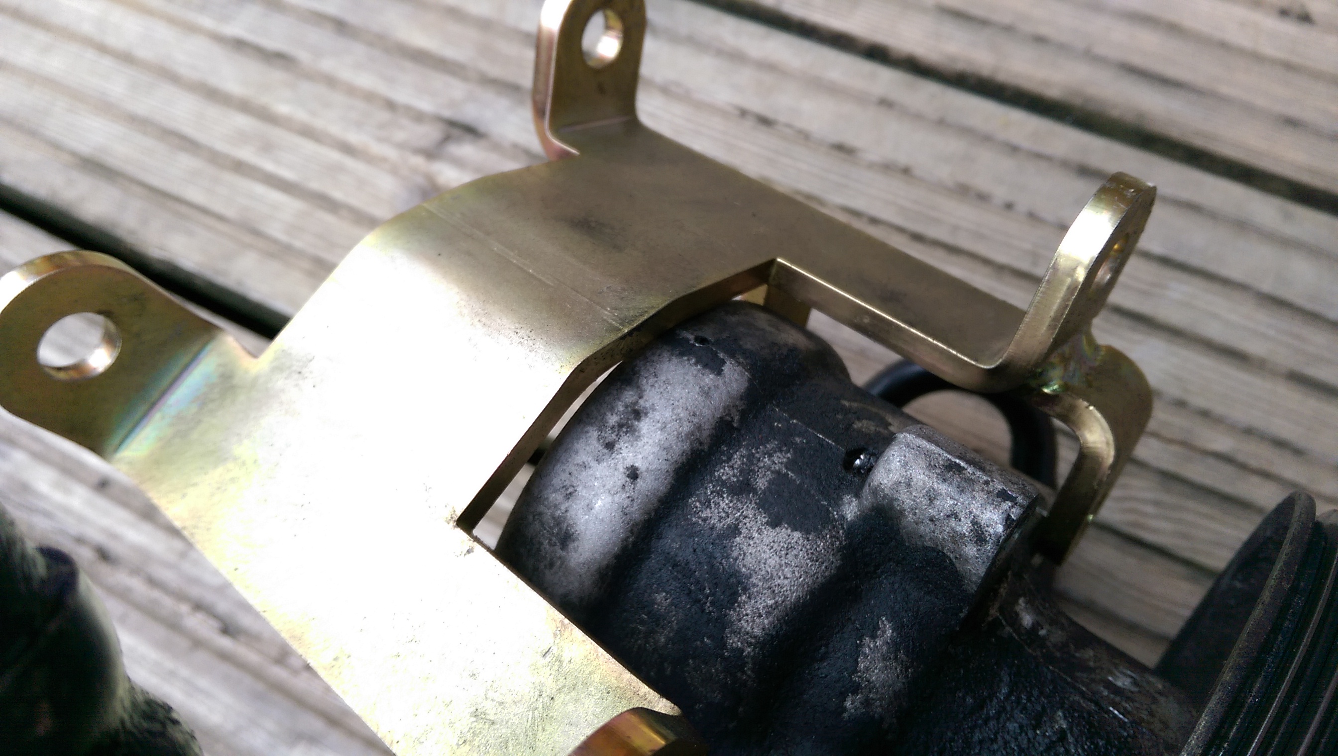

Mounting bracket for the PAS pump doesn't fit.. Tried everything I could but nope *sigh*
Since I'd cut the pipe couldn't put it back to the original place. So for the time being it's off and will be chatting the company who supplied it on Monday.
