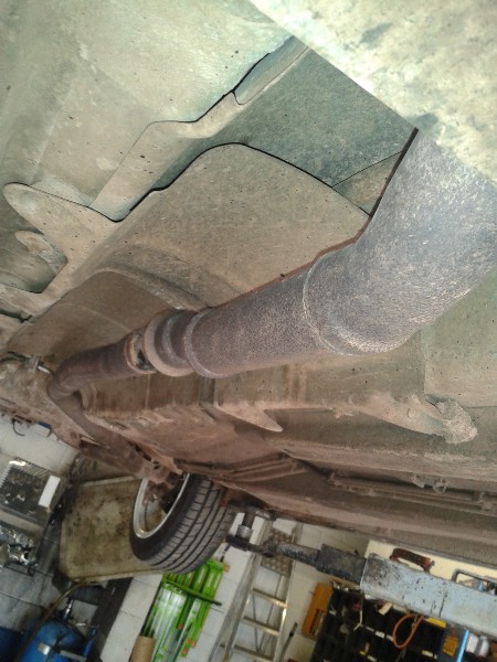

when and saw the car it was on the ramps so took a good while looking at the underside for problems
only found 2 scabs of rust wire brush and a paint will cure that before it gets out of hand
also think the crank flywheel oil seal is leaking as theres a little oil around there
may explain the slippy clutch report

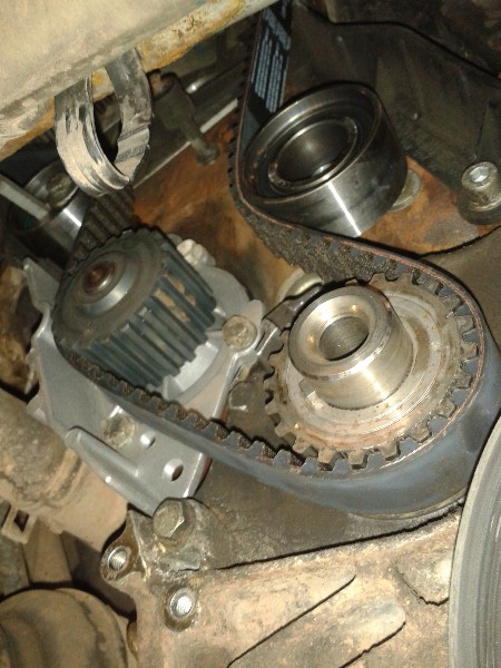

new cambelt and water pump

oil leak
Meow less
long wheel bolts
Fixed
New arch linner needed
rust 1 and 2
pinned cam pulleys
