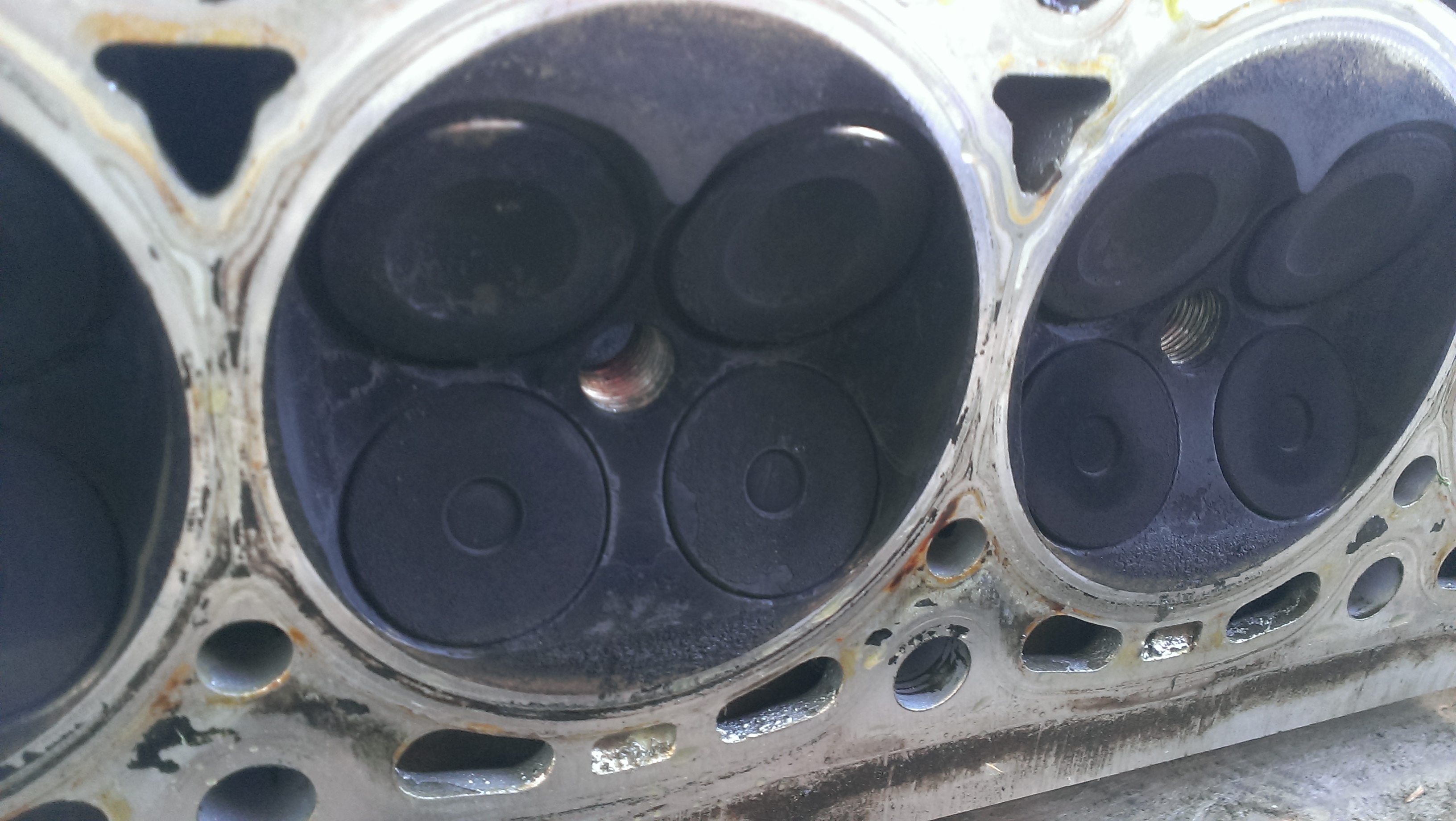

Oh and finally for having 122k on the clock the old engine head is looking rather clean:

Finally got around to fitting the rear Bilstein b6 - damn the ride improved over whatever came out:
Ohhhh and I managed to find out the problem with the old engine:
Bent valves??
#87
Yep they'll be bent!
#88
(19-07-2015, 11:02 AM)Paul_13 Wrote: Yep they'll be bent!
Shouldn't have effected the head?
#89
Could of done. To be honest though, looks like its only tickled the pistons so i reckon you may get away with new guides, new valves and a regrind.
#90
tbh was umming and ahhing whether to have this head port and polished or just to scrap it?
Taking up space which I could do with.
