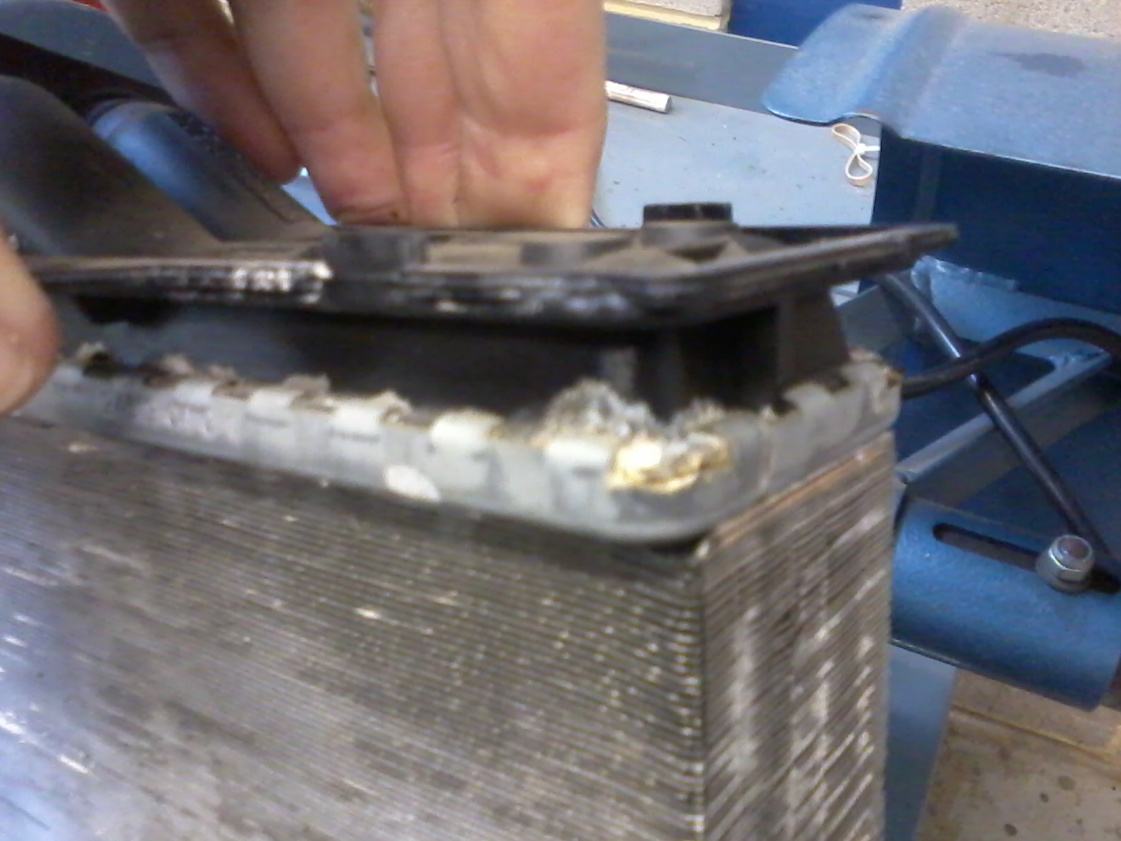

New heater matrix came yesterday. £32.39 from euro car parts. Now to start putting the dash back in. Confused

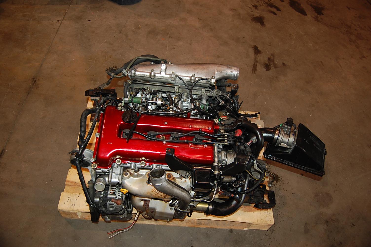

Still kind of like the Pulsar GTIR engine option, its a strong unit with the potential for big power, i can get a complete engine, ecu and loom for £700.

200SX engine cheaper? they're essentially the same
#65
The 200sx is mounted inline, the Pulsar GTI-R is transverse, according to my nissan mate guru couple that with a sunny gearbox as the GTI-R box is 4wd and it is a good set up. Obviously lots of custom bits would have to be made, but i dont think it will cost 5K. Most of the mechanical stuff i can handle. mating the Nissan and Peugeot wiring looms could be a mission though.

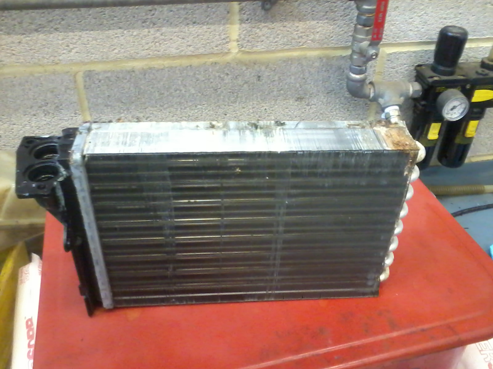

As you can see the heater matrix was totally shagged

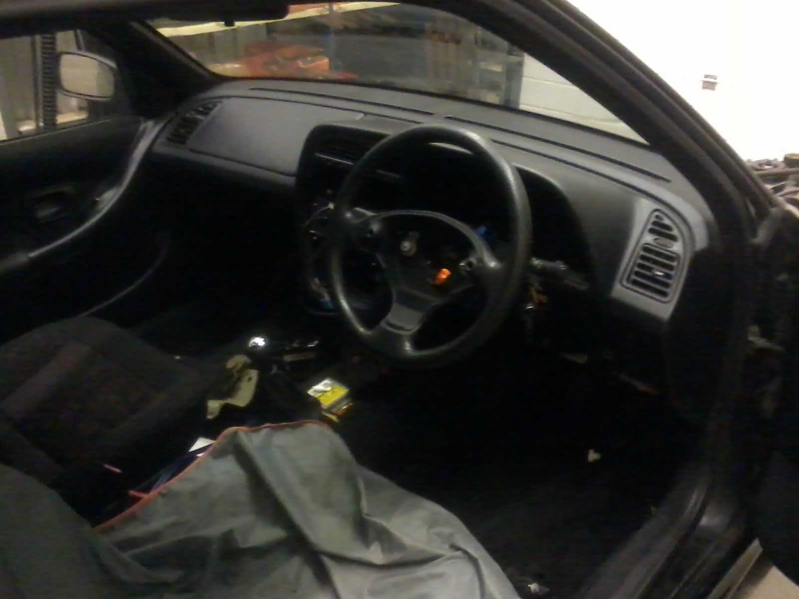

New Matrix Fitted and dash back in

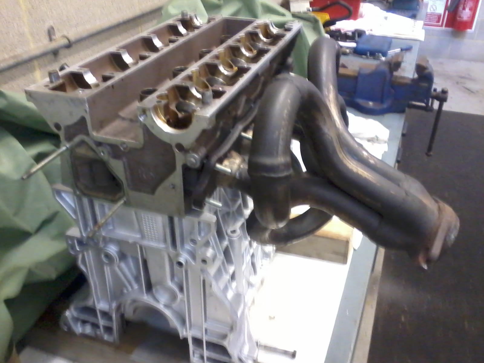

Also had a play at mating up the Xu7 block with the Gti-6 Head, my mate popped up to take some measurements to see if he can fabricate a turbo manifold from the GTI-6 one.TMI

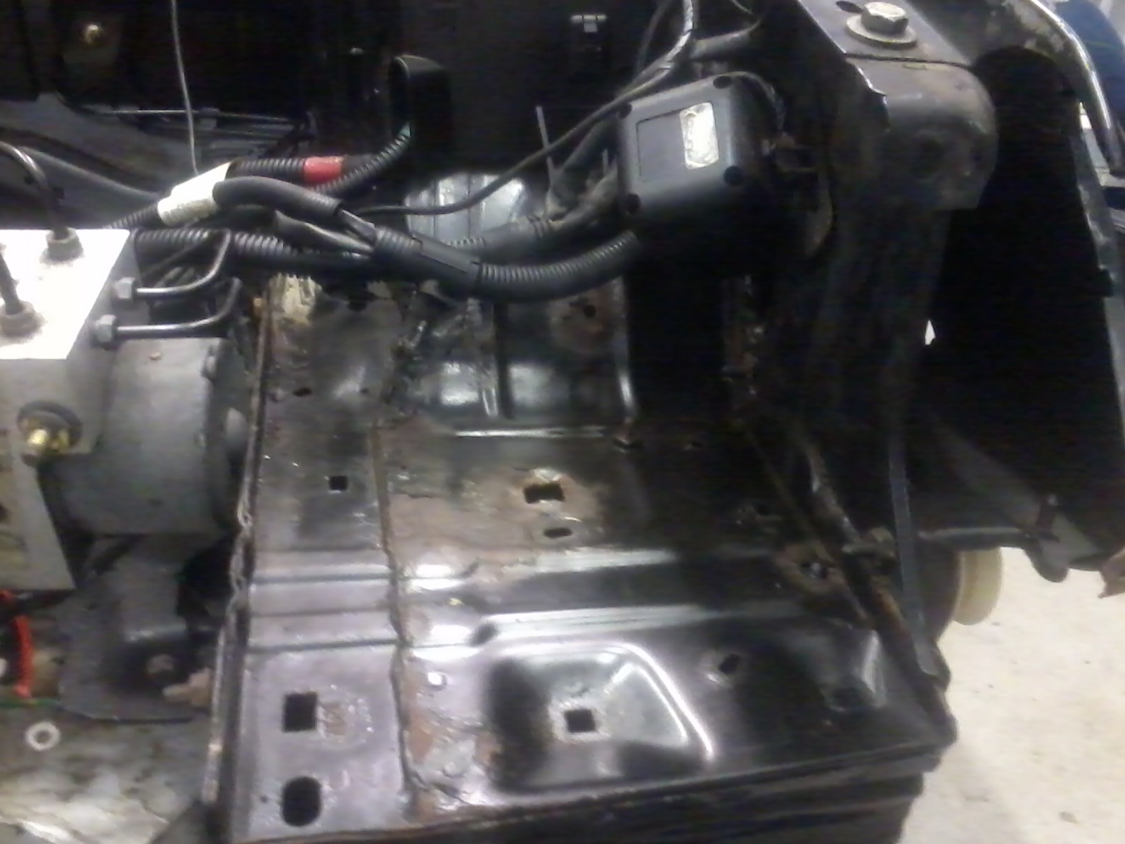

The main bulk of the surface rust was around the ABS pump area. but its all sorted now.
[attachment=12626]
[attachment=12627]
[attachment=12628]
[attachment=12629]
[attachment=12630]
[attachment=12625]
Looking much better than before.Inlove

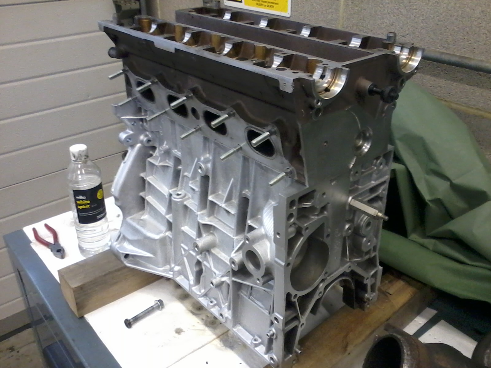

As i am going to go down the turbo route, i have decided to use the GTI-6 engine, got the main bearing shells in today, although the thrust washers do not look the same as the ones that came out, but the Peugeot dealer assures me they will be fine. Confused
[attachment=12631]
[attachment=12632]
[attachment=12633]
[attachment=12634]

More pics of putting the crank back in.
[attachment=13200]
[attachment=13201]
[attachment=13202]
[attachment=13203]
[attachment=13204]
