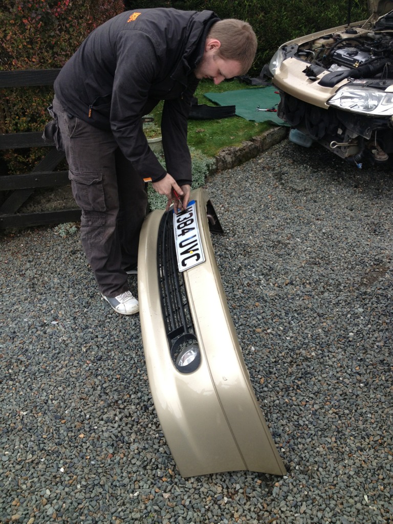

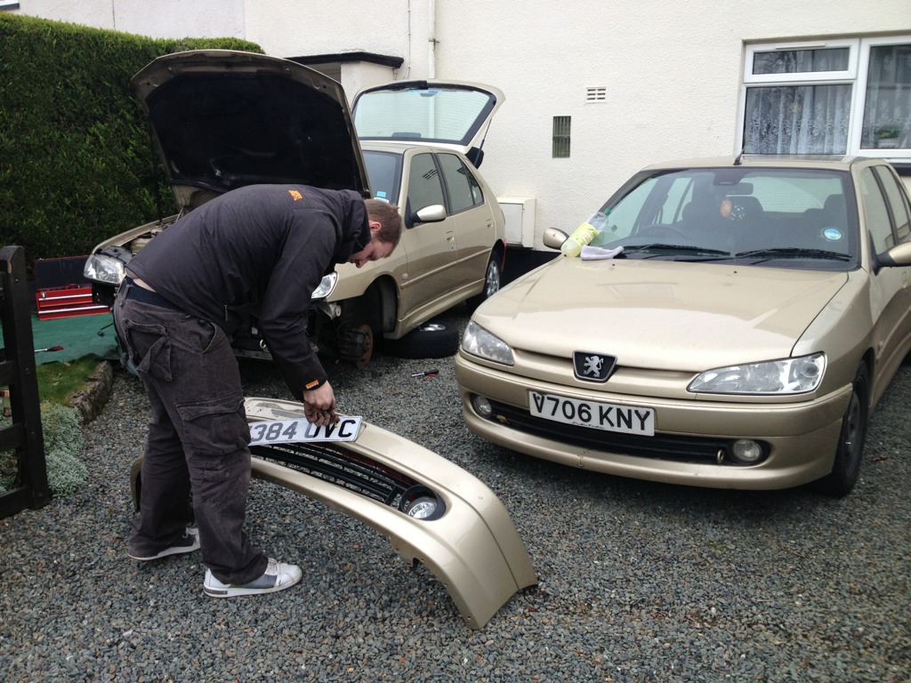

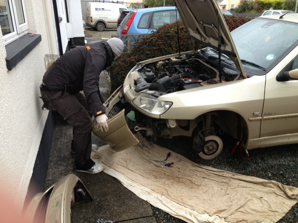

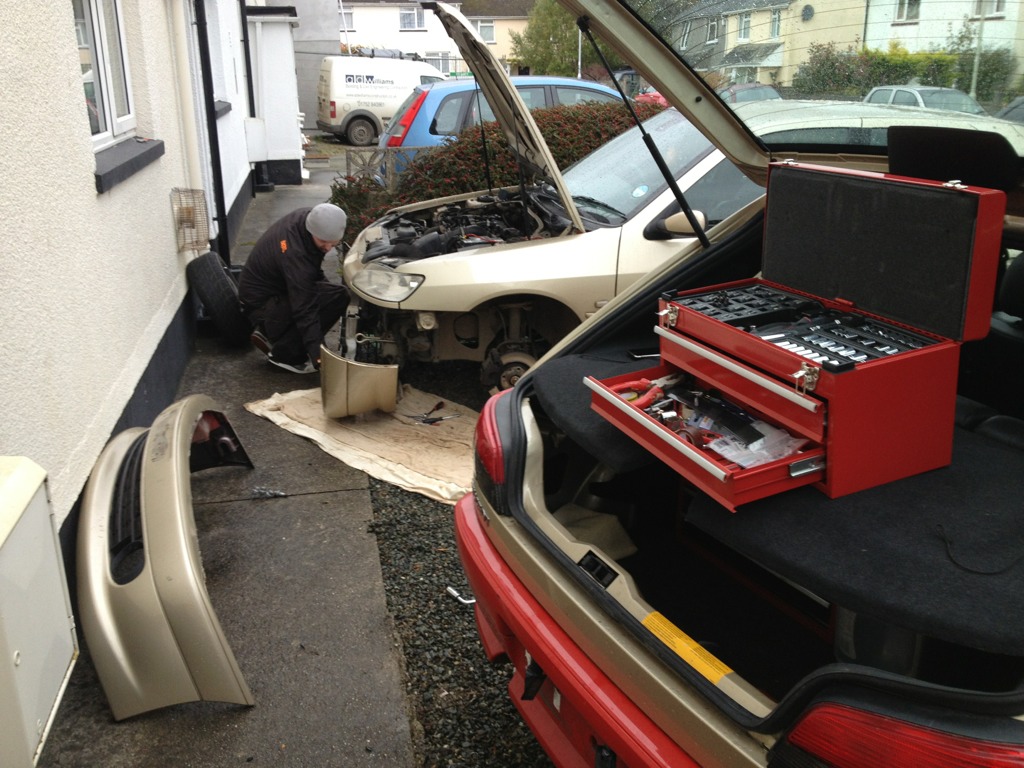

Ok so today finally got around to fitting the spare bumper so no more crack thanks to a badger :-( my mate Tom will be uploading pics later also fitted some rallye blanks to the bumper I'm not sure yet if I like them but they are growing on me sorted my gammy badge and engine cover hopefully in the next few days itl be draggin balls on coilovers :-) pics to follow

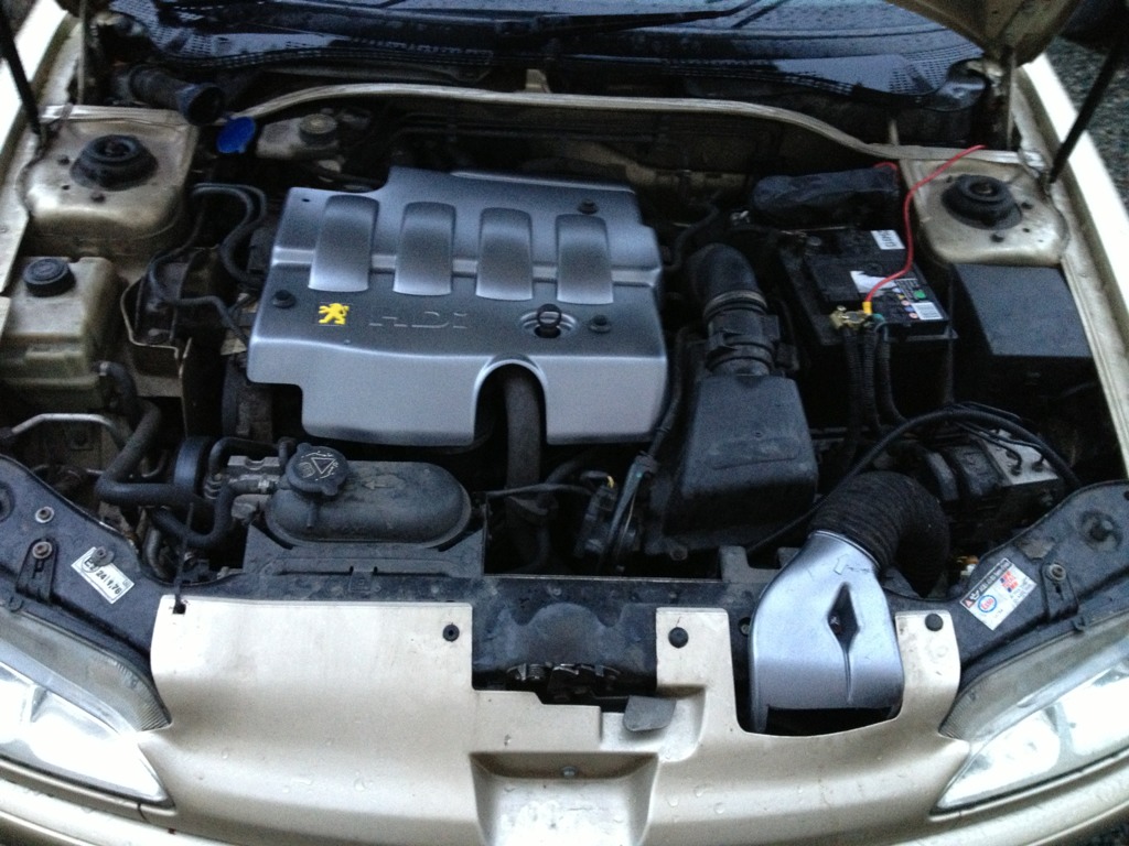

Get that yellow lion off the engine cover and respray it gold FFS!! They're only held in place with double sided tape and prise off easily.......it'll look much better!
p.s you expansion tank cap doesn't look like it's on properly either lol........bumper looks better thoughWink
#52
Thanks for reminding me its not lol I loosened it cos the constant squeaking peed me off as tha car cooled down I kinda liked the yellow against the gunmetal lol yeah that's my plan to have it gold but with those bulges gunmetal ?? Just didn't have any gold paint coupled with my impatience lol :-)
