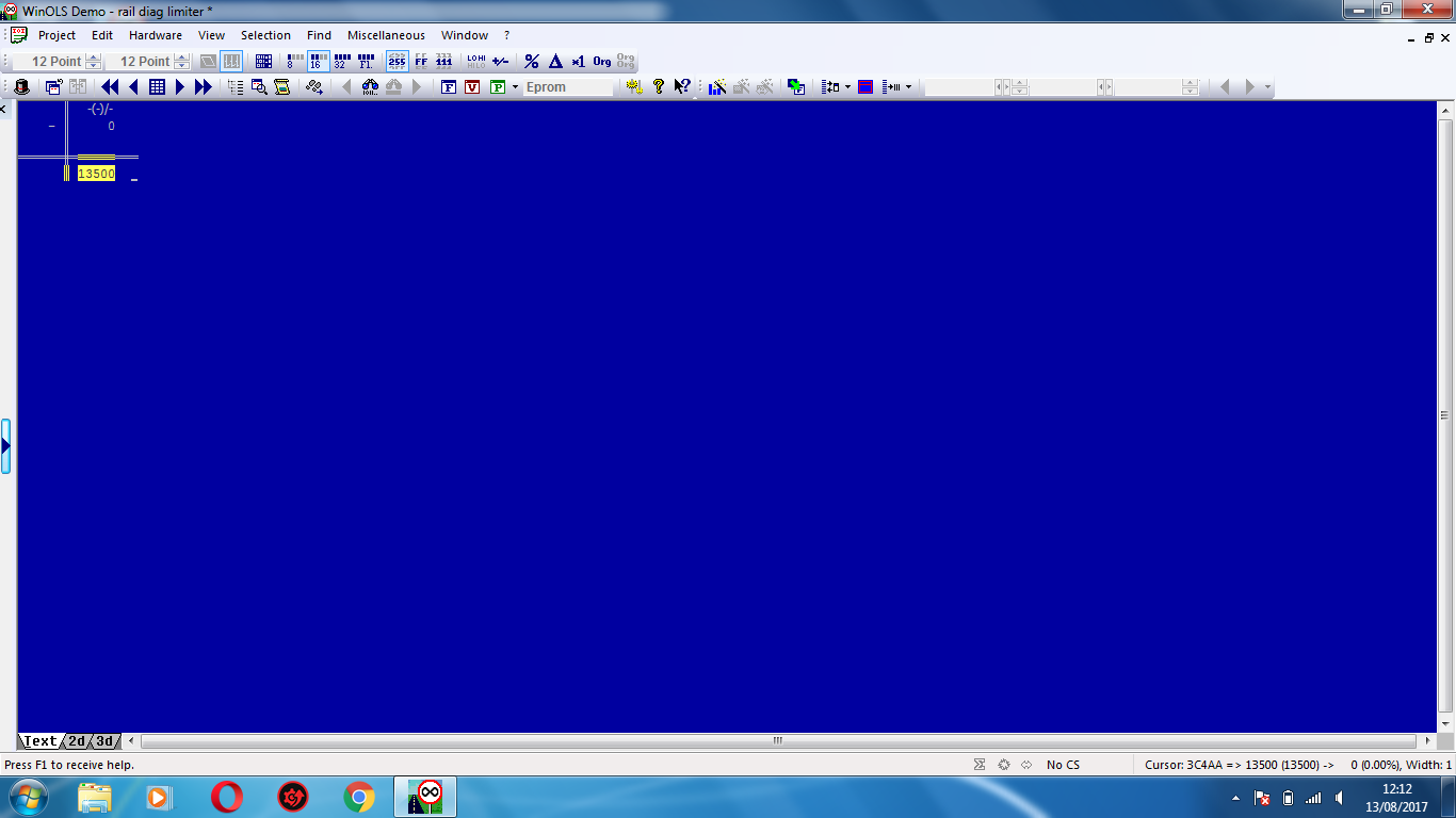

Place mouse over the value you want to select, click, drag forwards one value then back, value you want to select as a map should be selected in a colour. Then press 'k' or go to Selection > Selection -> Map
HTH
#32
Perfect thanks Ruan, being 1x1 will mean the previous number is not the axis description so should look like this in text mode?
Big Grin
#33
No, it shouldn't try and use the previous value as an axis. You'd probably get it to do that by setting the column width etc but I suspect it'll fail as it's looking for a correct axis layout which won't exist. If it does, you can remove that by double clicking on the axis labels and selecting the data source as '1,2,3...' and it'll just label each data point sequentially from 0.
