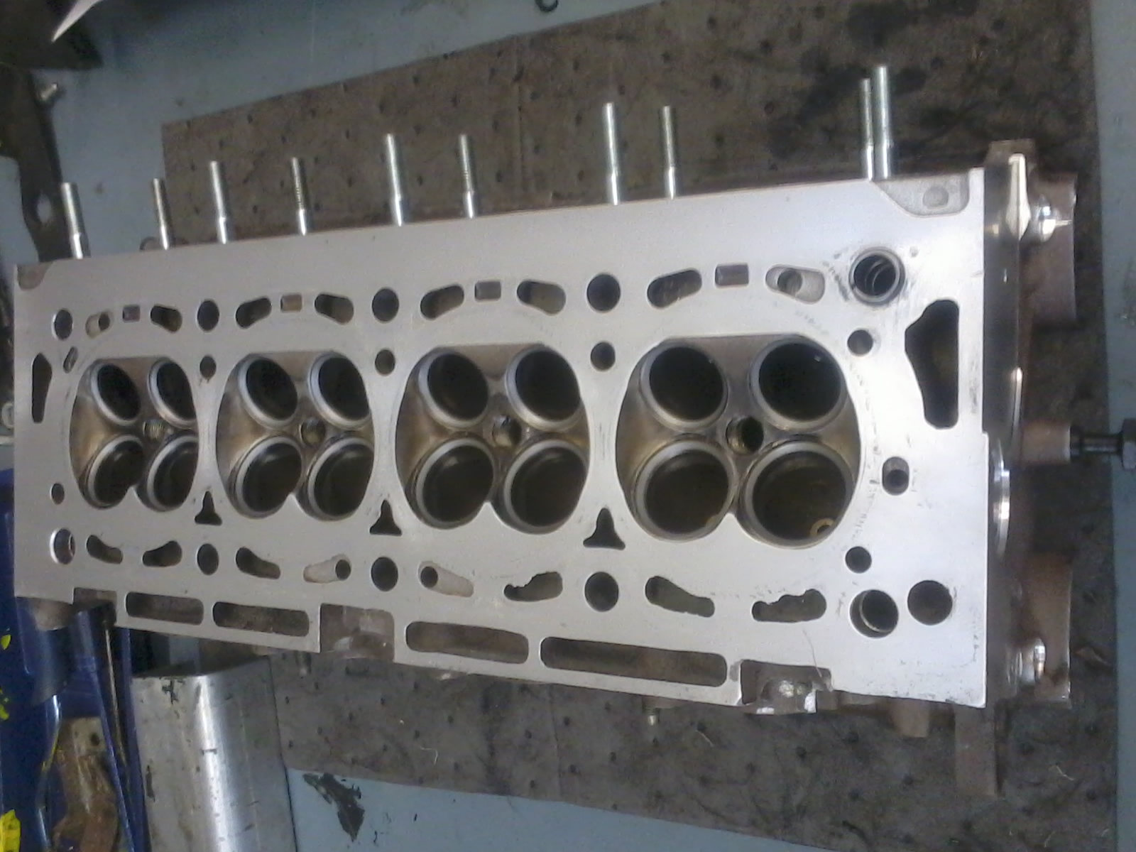

Finished the cylinder head prep off today, lapped the valves in, waiting for a set of stem seals to arrive now

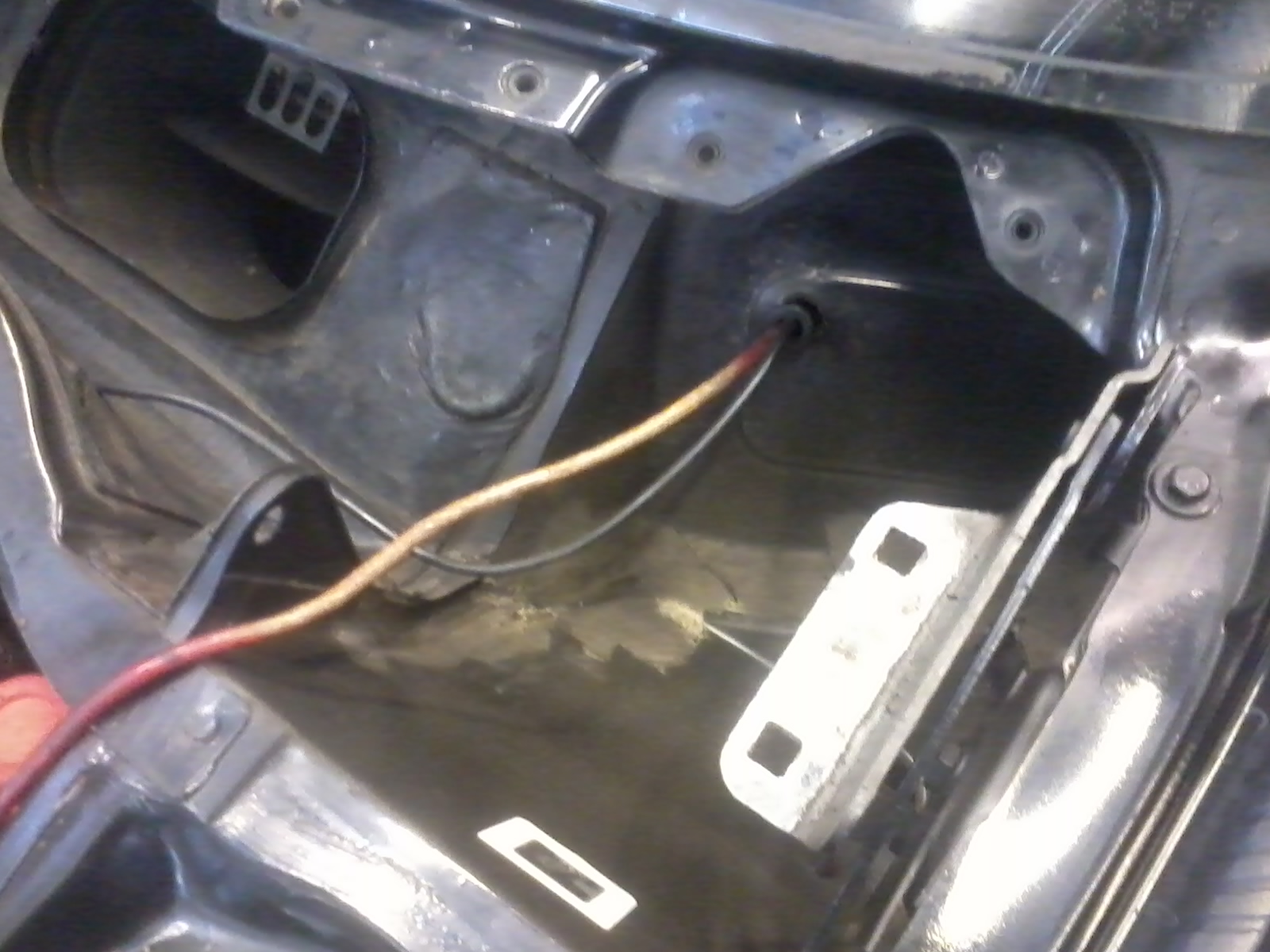

Also found this abomination while i was removing the scuttle fixings. Some people just don't have a clue.

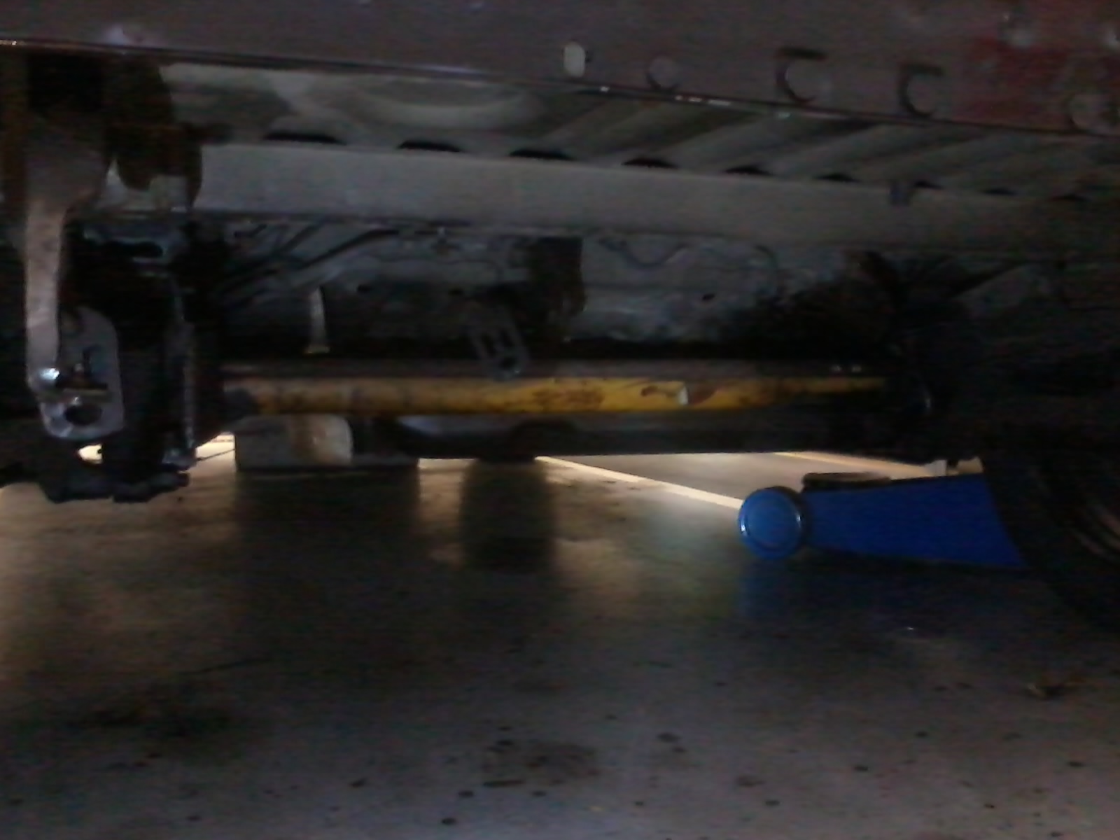

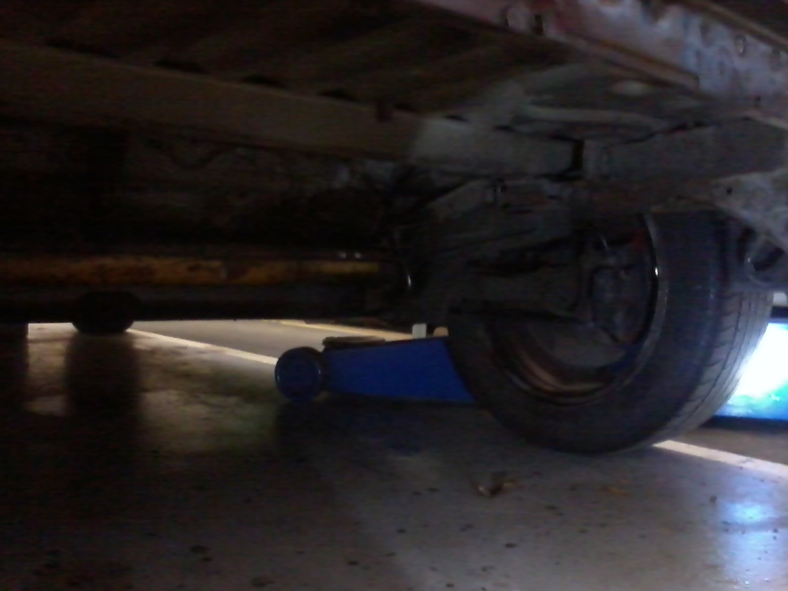

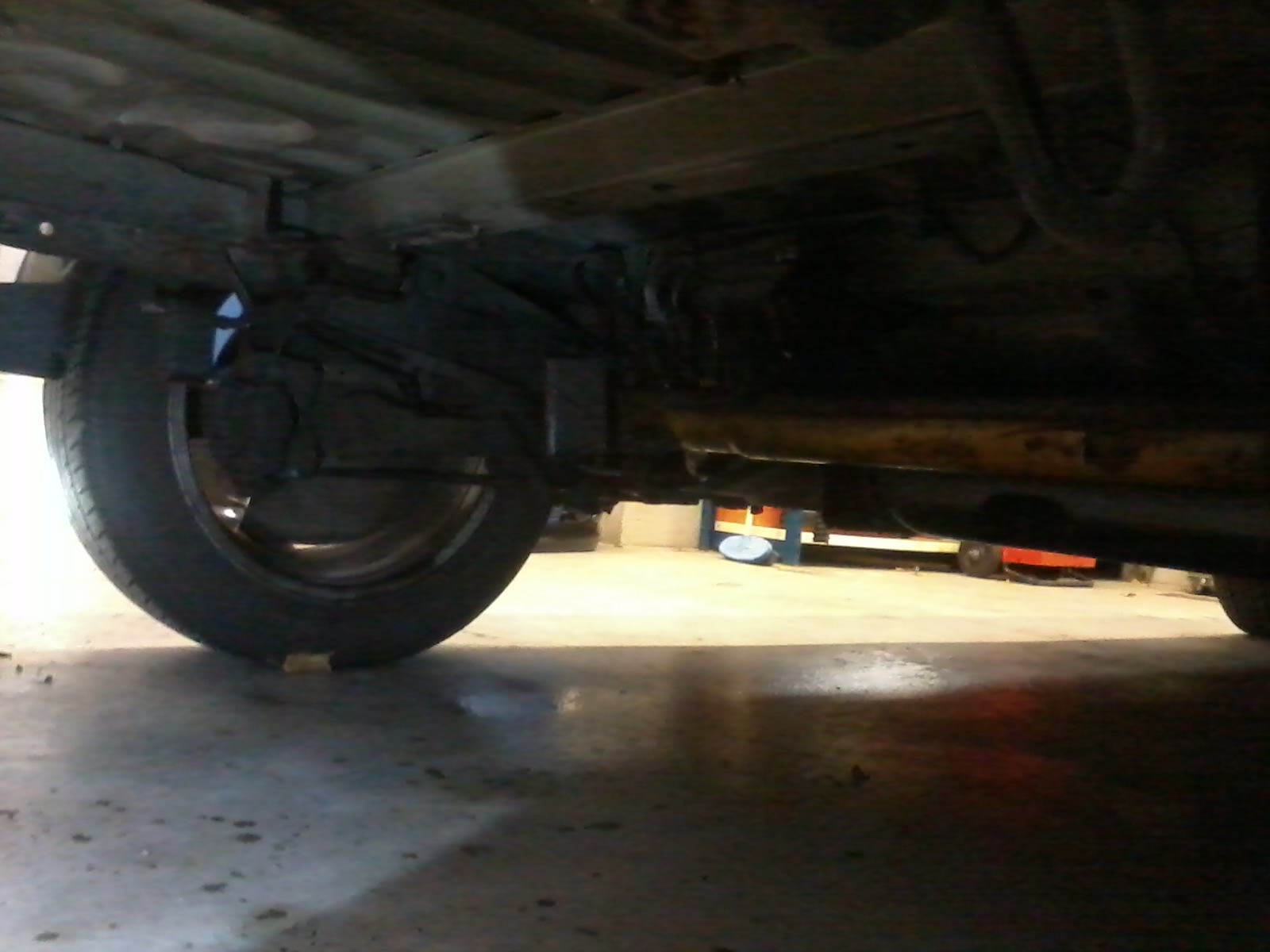

Got the rear spoiler and Bumper off this week, plus removed spare wheel carrier, and exhaust heat shielding, not looking to sad underneath.
Still toying with the Turbo idea, The pistons from a nissan 200sx s13 will fit the liners, its just whether the gudgeon pins will fit the 1800 pug rods, they have a 8:1 compression ratio.
More to follow soon

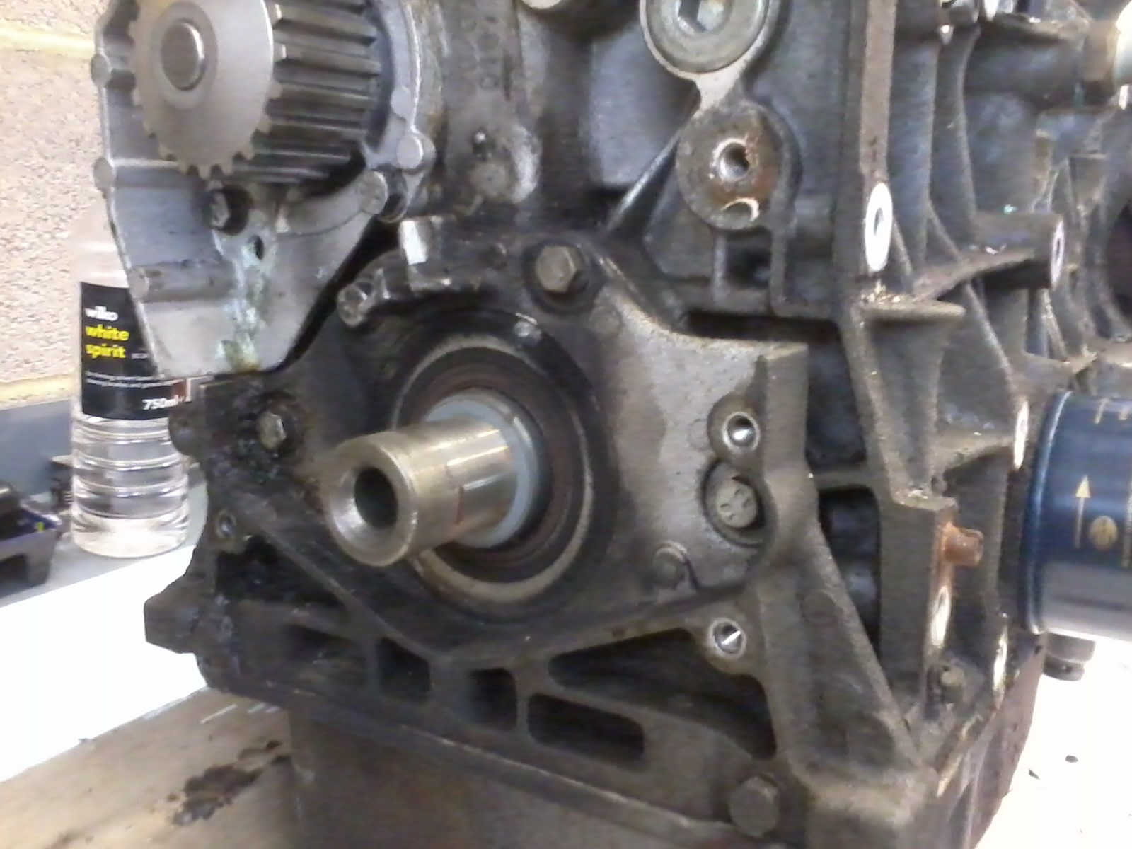

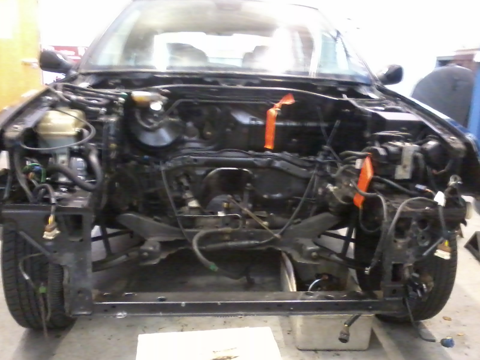

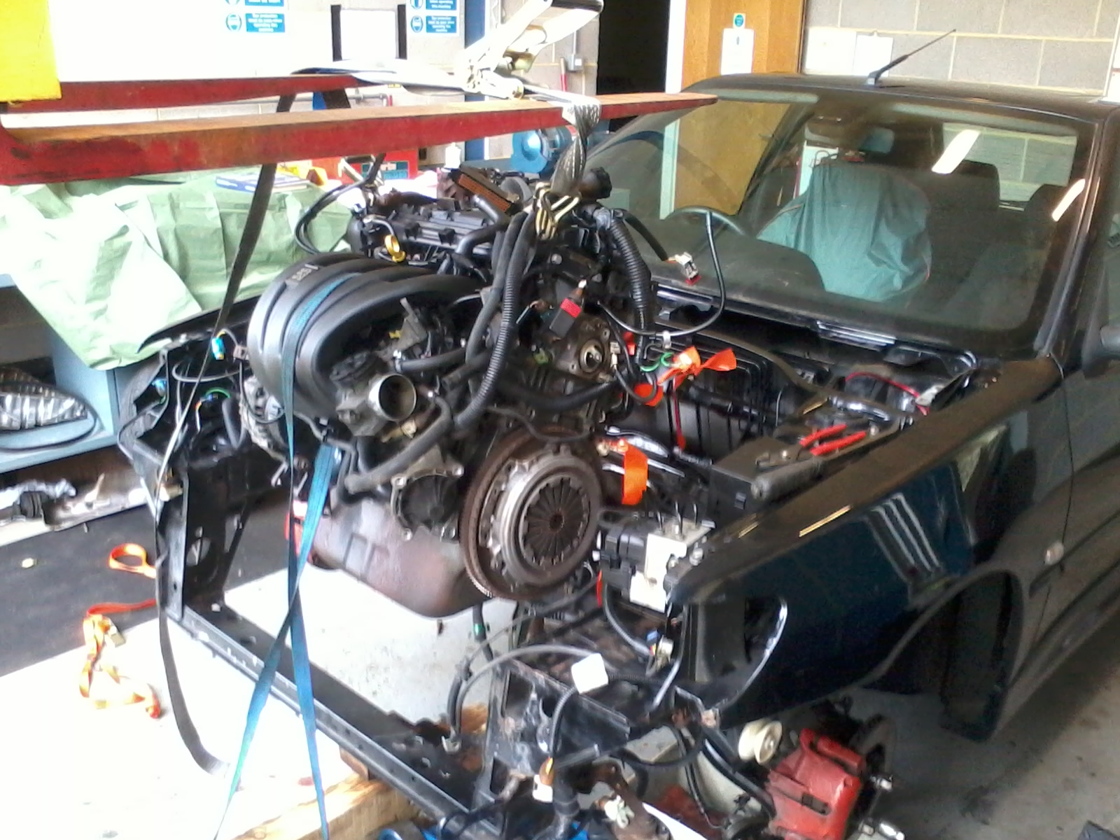

Got the XU7 engine out today. Lucky i decided to take the car off the road, the new water pump i fitted last year was leaking. Now the fun begins to see what fits what etc. Heart my verniers Heart
May sell the 1.8 head complete if anybody is interested, there was one snapped bolt that holds the back timing cover on, but can be drilled out. It won't come with the pulleys as i am going to use them on my 6 head

School boy error, the noise that i thought was the top end tapping, turned out to be a fecked alternator Doh

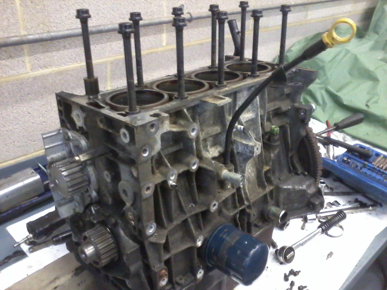

The XU7 engine is completly stripped now. But as usual cash has run out and i am loosing interest with it all now.
