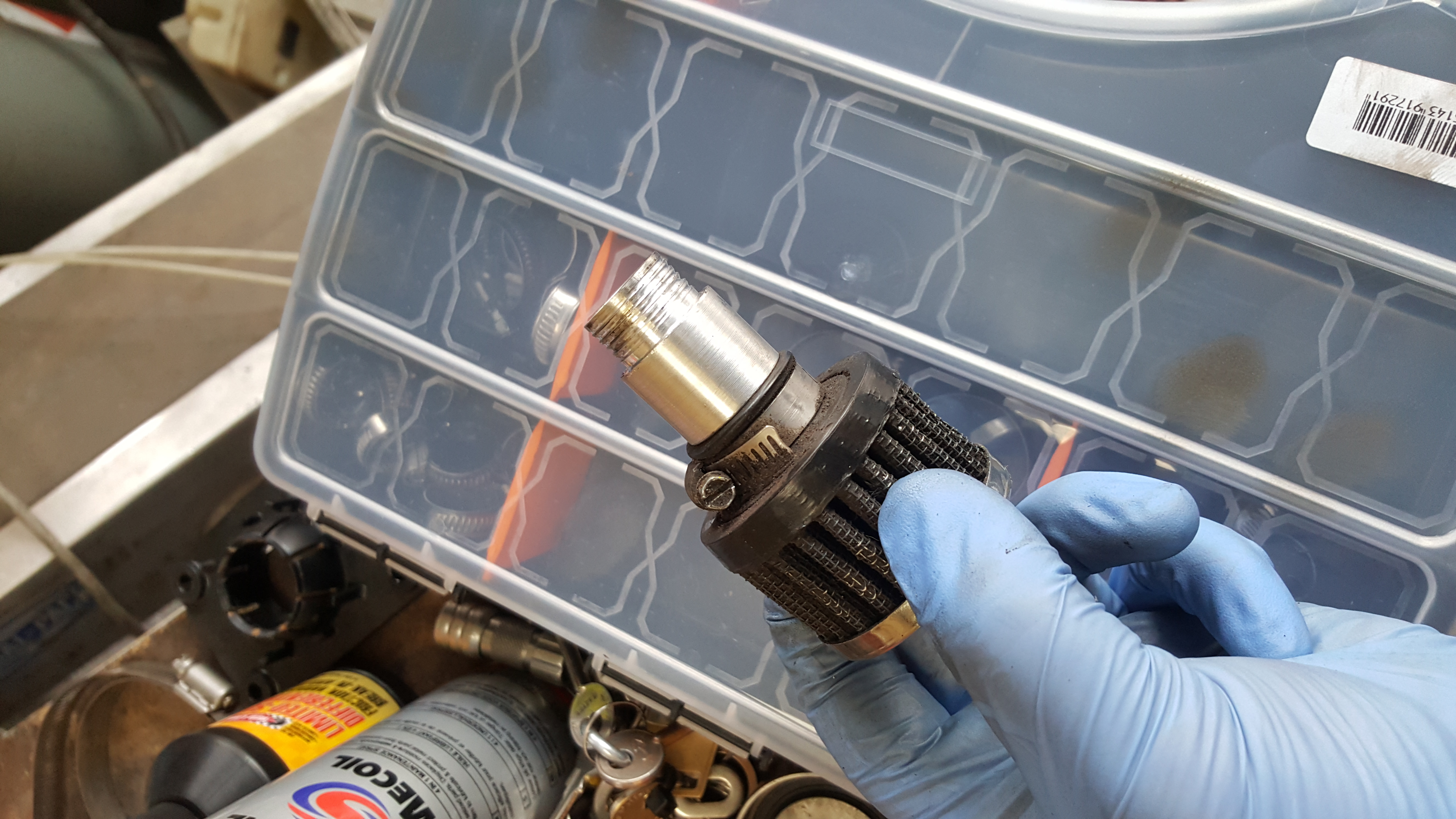

Hot idle sorted, basically added a new hose and separate filter for the idle air valve as it just wouldn't work breathing through the main filter.
I didn't have anything that would fit inside the breather so my old man turned me up a stainless insert on the lathe. Perfect
