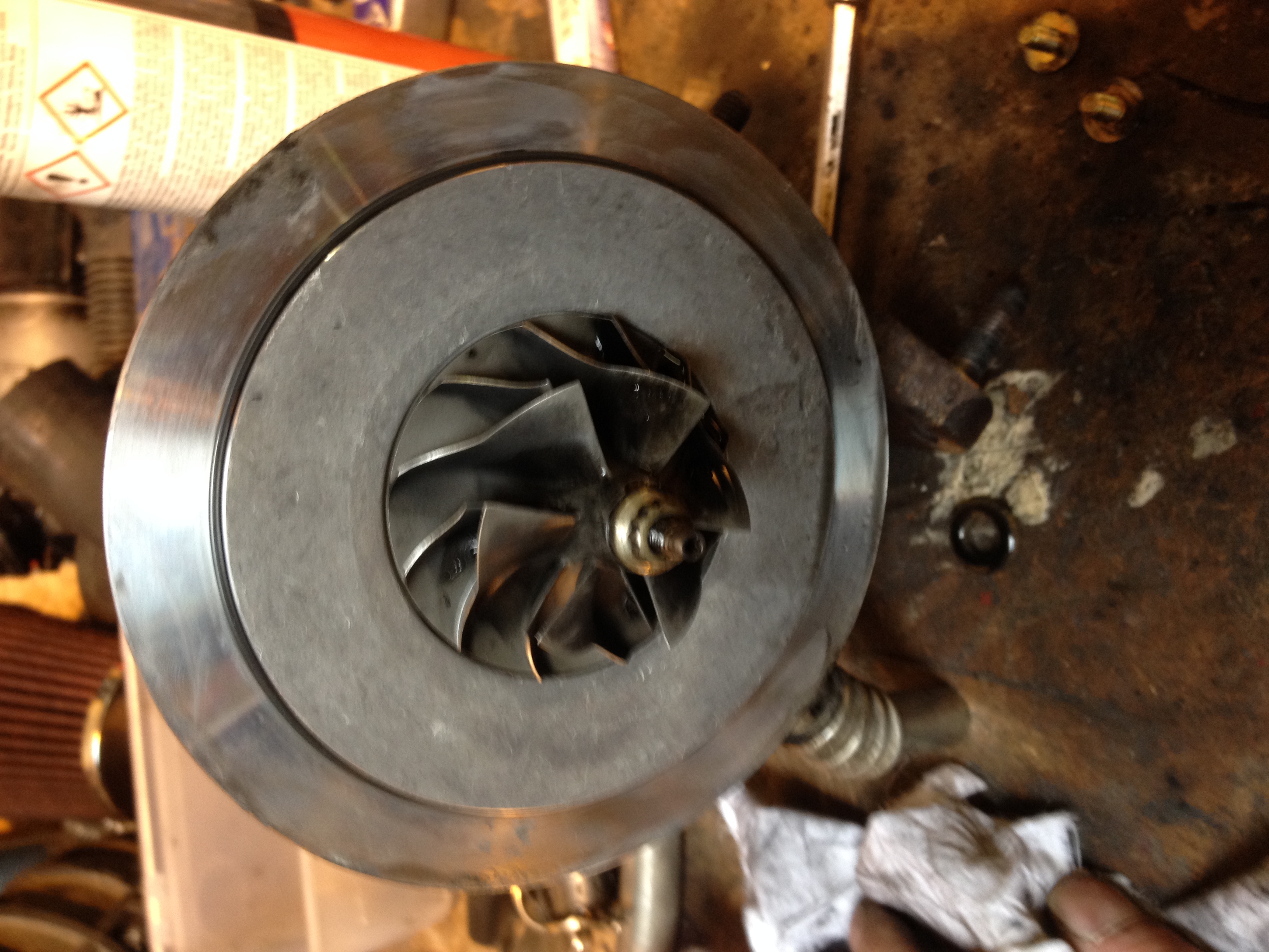

So in the spirit of keep posting on the forum a may as well post some of my bits from this afternoons work. Got the heater matrix complete.
Then proceded to rip out the engine bay to mount the new turbo. had to turbo in bits so i could clock it to get it where i want it to be mounted and got a spare actuator that will fit. also made some stencils of the turbo flange and the k14 flange to make into metal at work this week so i can then make a relocation pipe. hopefully wont have to buy anything else except a diffrent banjo bolt to fit the gt2056s.
Also on a side note the gt2056 look bigger than the rhf5 side by side and the compressor wheel looks a lot more intricately designed.
So thats where im at. the plates will give me something to do in lunch breaks this week so i can then crack on with the other bits when i get back to workshop.
