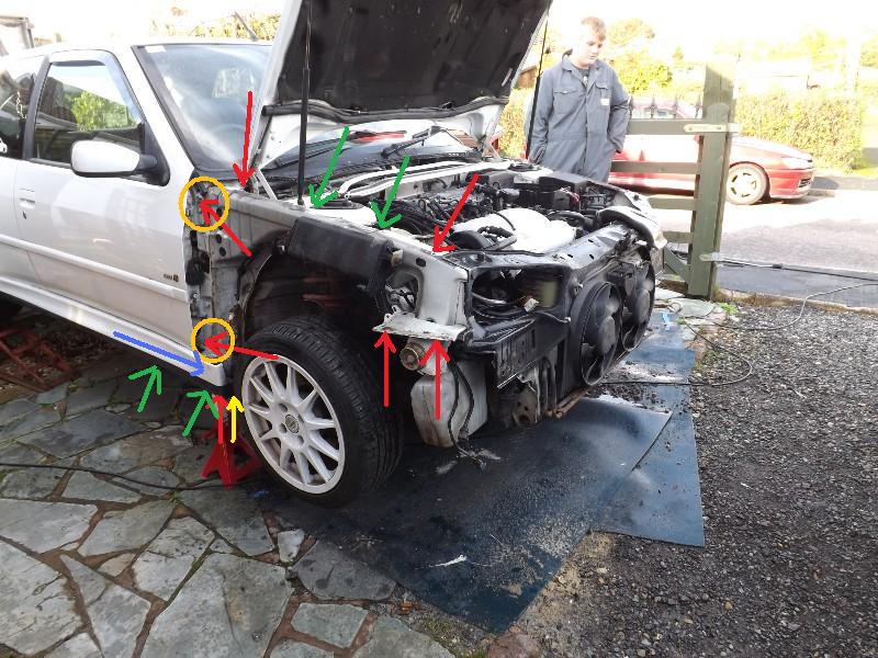

wing fixings and sill trim to release points
greens are rivets
reds are bolts
yellow is screws
