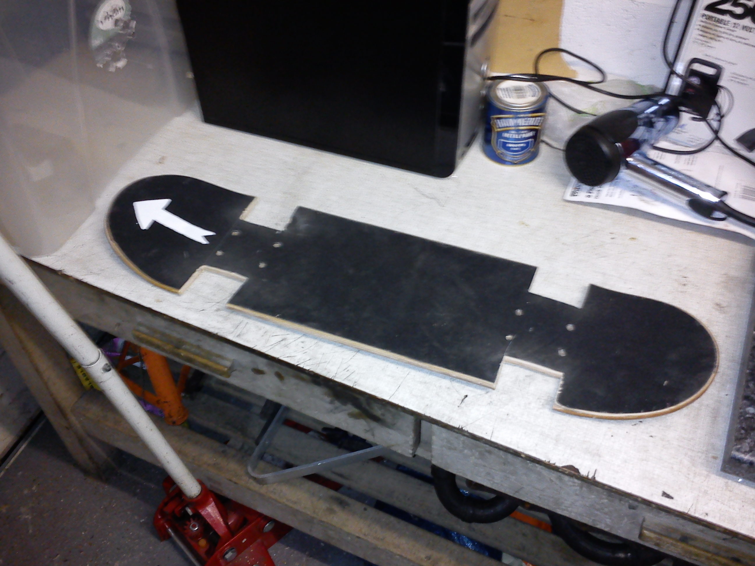

Anyway went home and marked up the board which is a ball ache to do accurately as its curved and my ruler isnt. Anyway, got it roughly marked up for the cuts and made 4 cuts in to a 'measured' depth down each side. I then drilled a row of holes to do the third side and wiggled the bit side to side to break the bits between the holes then snapped the last bit off.

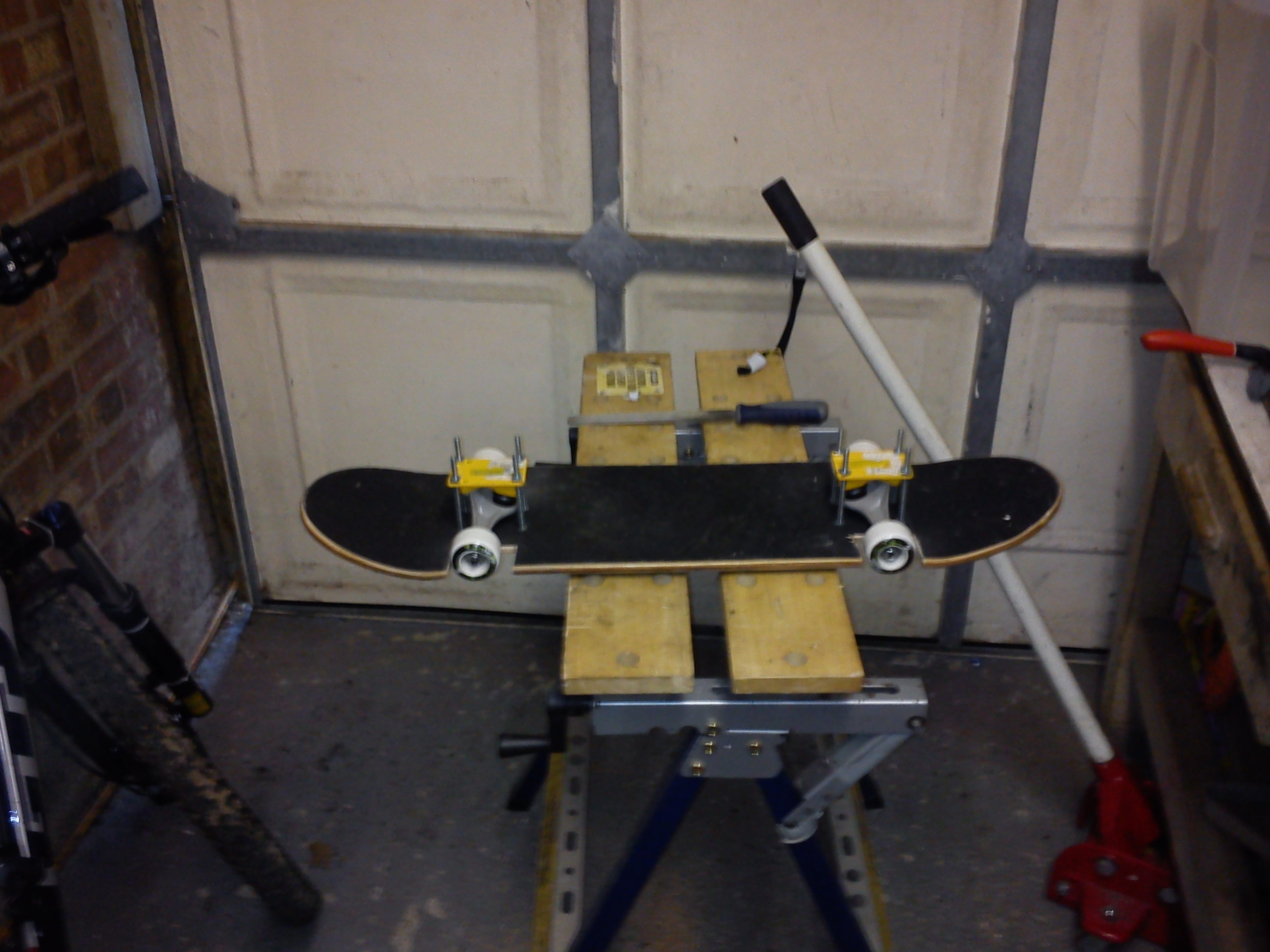

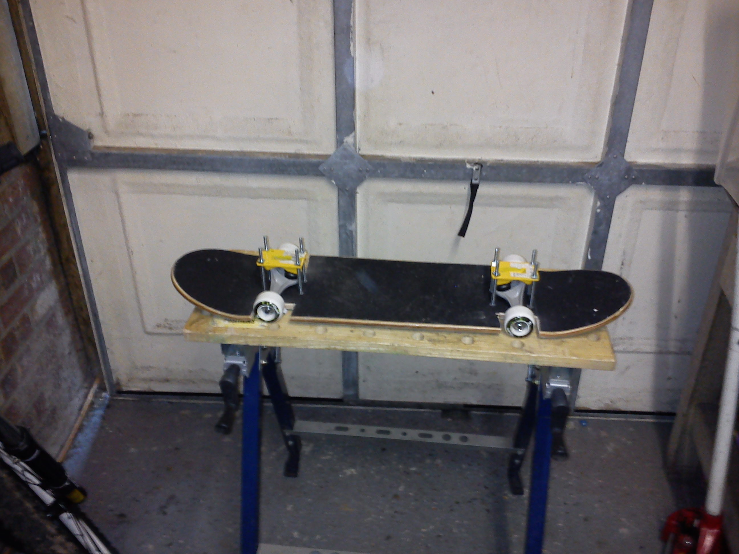

I sat the boards trucks on the deck and realised the wheels didnt touch the workbench. Arse! So I dug out my spare set of trucks that had better clearance underneath and the wheels touched the bench.
I bolted it up for a test and it rolled but it was bloody close on the bench. Put it on the floor and hopped on and low and behold it was sitting on the heads of the bolts.

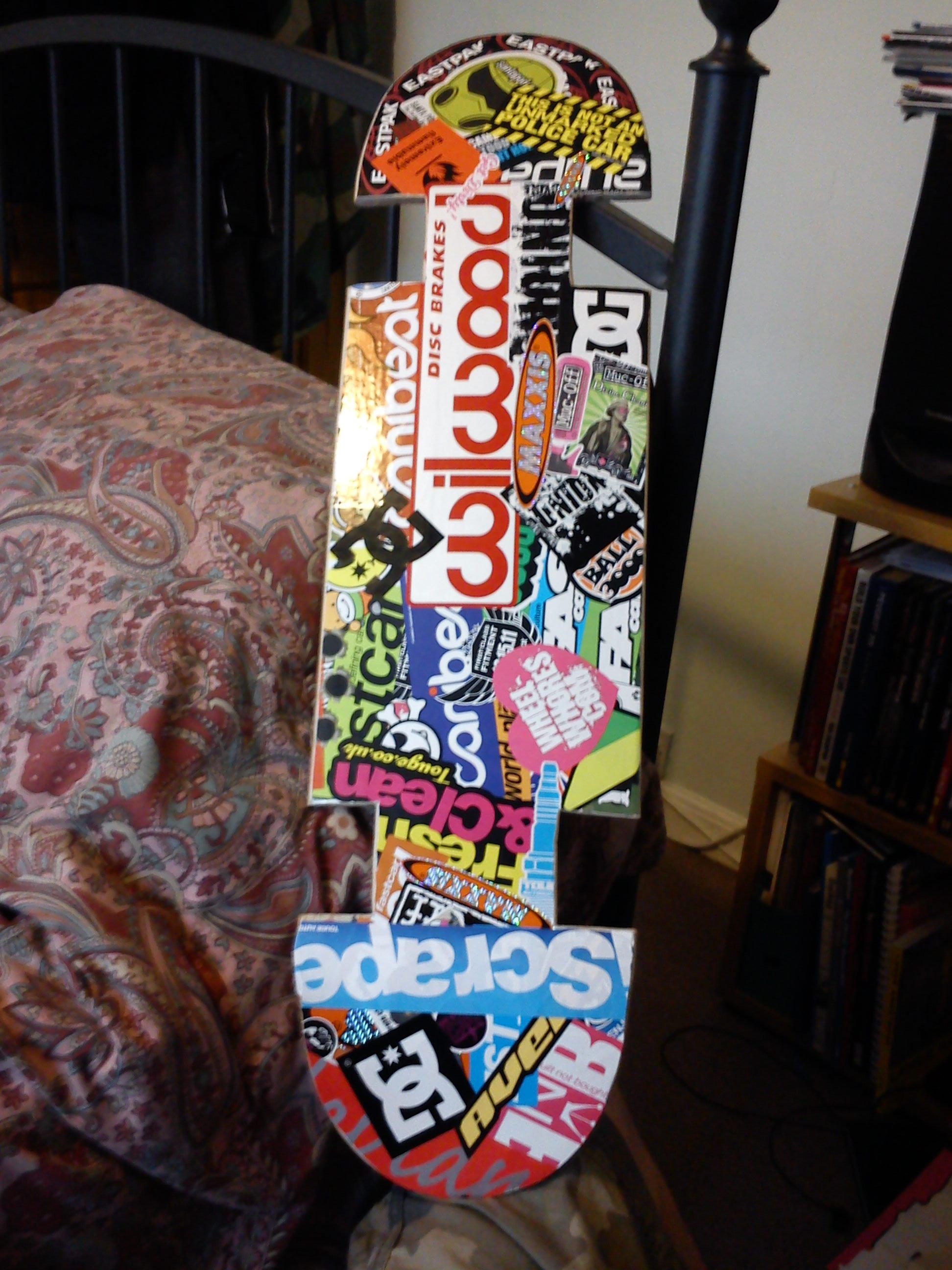

However I have finished with the file and sticker bombed the underside.
[attachment=1]
Gonna do something to protect the underside like a PVA clear coat or clear sticky back plastic.
